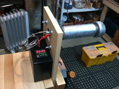

- Posts: 180
Re: Using a clothes steam iron for bending sides?
I built this digital temperature controlled bending iron for a total cost of about $90. The PID controller maintains set temperature within about 5 degrees, once it's fully warmed up. Works great - no risk of setting the house on fire. I have a parts list and schematic drawing, if anyone's interested.
