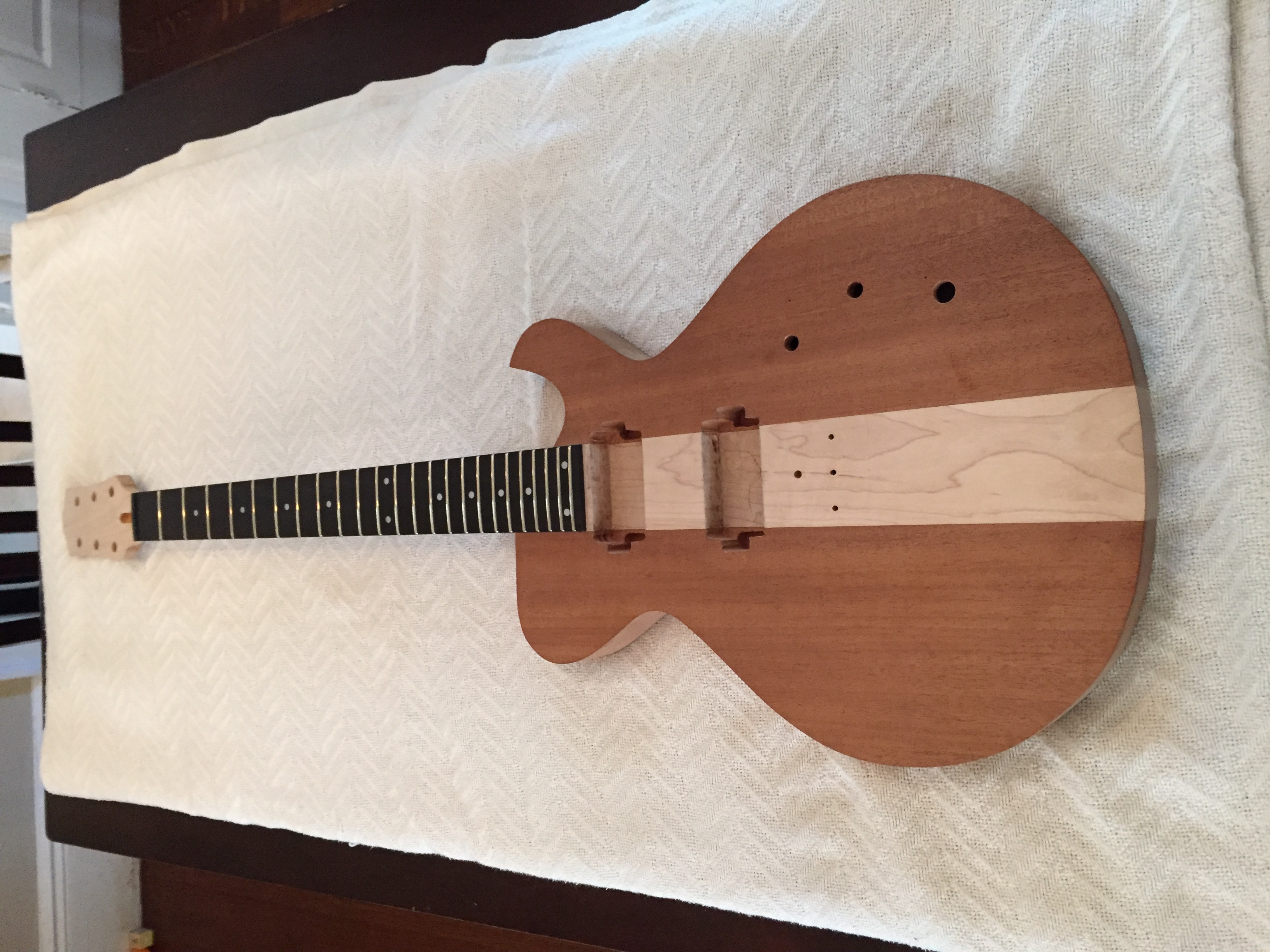

Hello Folks,
I'm working on a neck-through with a maple neck (rosewood fretboard) and African mahogany wings. All of the contours are in place, cavities are cut, etc., and it's sanded to 320. It's ready to be finished, but I'm not sure where to go.
My initial plan was to use a water-based medium amber maple wood dye on the entire guitar (with it being taken up differentially by the two woods to maintain the contrast), followed by an oil-based clear grain filler, then finally a few coats of Formby's Tung Oil. I tried the dye on some samples and didn't like what I saw.
The purpose of the dye was to make it look more civilized/professional, because just tung oil on samples looks pretty plain and rudimentary. So, I'm looking for some creative input here -- some ideas on how to add a bit of something without going too far as I still want to see the wood and use a tung oil finish. The main thing that bothers me is how plain the maple looks.
Any input would be greatly appreciated.

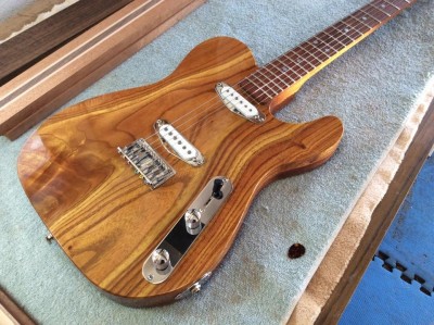

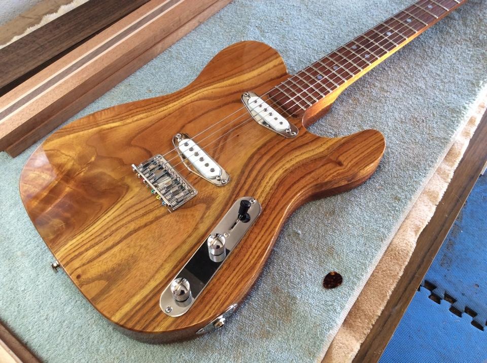

Re: Ideas Needed
Hey Scott,
I made this using african mahog and chinaberry.
The colors were pretty dissimilar. The chinaberry had pink tones in it.
I applied an amber dye to both materials to make the overall color cohesive.
I've done this on several builds where I was not pleased with the color difference.
I usually put some color on maple, even if it's just a very slight tint to enhance grain.
Dan

That looks amazing. Great job, and thanks for your input!Dan Smith wrote:Hey Scott,
