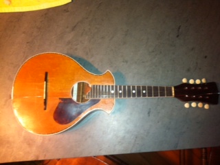

I'm trying to clear by bench of a few ongoing projects and this one seems to have worked it's way to the top of the list.
It's an old Tone King Mandolin, I'd guess made by Regal but would love to hear anyone's thoughts. After replacing back braces and kerfing then re-glueing the back, I find that it is in desperate need of a neck re-set. Has anyone ever torn into one of these? Would it have a dove tail joint and if so, could I proceed as it it was a guitar neck re-set (pull a fret and shoot steam into the neck pocket)?
I'd prefer not to pull the fingerboard if I can avoid it.
I'd appreciate any thoughts anyone could share.

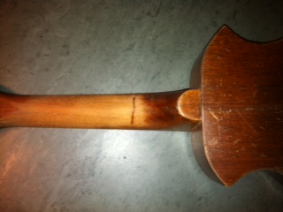

The Back/neck heel

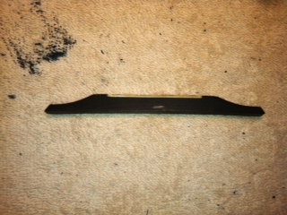

Here's the bridge. Pencil mark is approx where a straight edge currently sets the bridge. I'm measuring to the bottom of the bone saddle inset as the distance I need to change the neck angle, about 7/32.

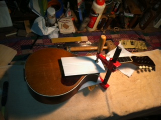

Here it is taped up and ready to cut. I'll give it an hour or so in case anyone has any words of wisdom to offer before I start cutting!

OK, I went for it and am pleased to say it went fairly well despot the wood be soft and "punky". Looks like Mahogany, but doesn't seem as strong. Here it is being glued up. I used hide glue for the first time and it all seemed to go well. It did raise the fingerboard extension up a bit but I'll shim it tomorrow if need be.
