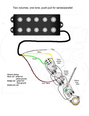

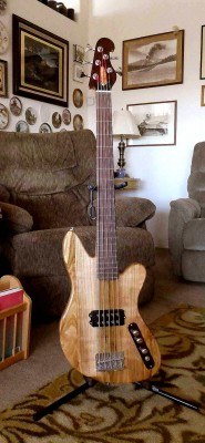

Here's how I wired it:
I put the pickup in the P-bass position. It sounded pretty good in the series configuration.
