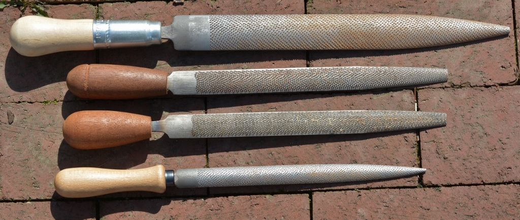

My favorite for neck shaping is the 12" cabinet maker's rasp. This is an 8 grain from The Best Things & it was made by Liogier.
Also in pic are an old Nicholson 49 & 50.
The little one is a 9 grain model maker's from Liogier - it's good for peg head transition.
