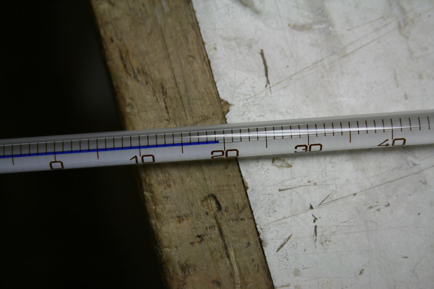

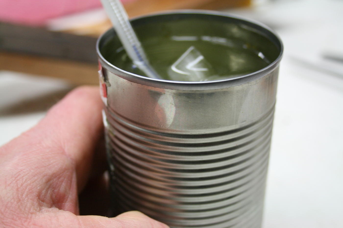

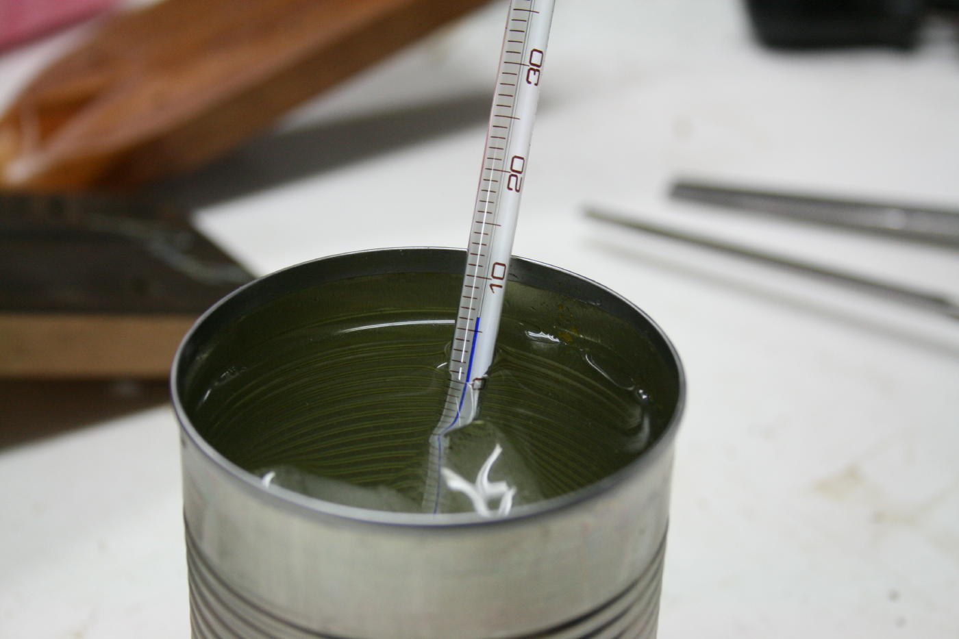

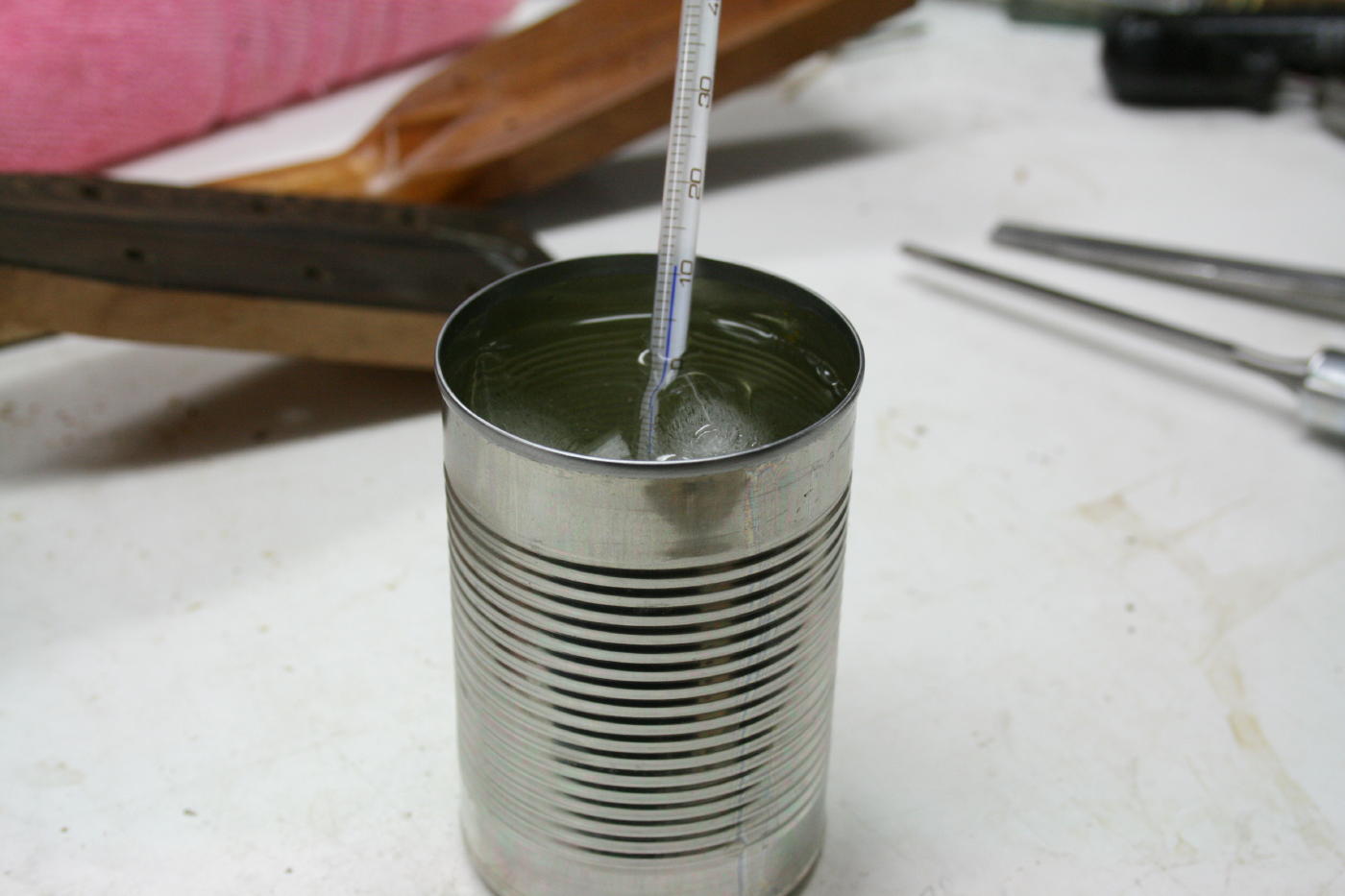

We will seek to find the true dewpoint in order to calculate the precise RH from that figure. In order to find the true dewpoint, I tried various containers, and ultimately decided that either a plain, -unlined- tin can(soup can here) or a thin-walled glass works perfectly. We want a vessel that has very little insulation(thus, no lining in the can, or thick glass). In this vessel, we will add cold water, and some ice cubes. 3 or 4 cubes works for me, but if your water is warmer, you may need more. use as many as necessary. We will also require a quality, reliable thermometer. Mine is a lab thermometer, but any good one will suffice, though the better, longer, easier to read it is, the better and more precise your findings will be.
In the following photos, we will see the thermometer in a soup can with the ice cubes having been just added. In between that photo and the next one showing the thermometer as around 6(°C), I stirred the water and ice cubes constantly, slowly, using the thermometer, until a fine dew(appears in the form of a light "fog") formed on the surface of the can. I stopped stirring, read the thermometer, jotted-down the reading, and took the photo. The next photo shows the same can, but after taking a "swipe" of the surface to be sure what I was seeing was in fact the dew(it was). The dewpoint in this example was 6.2(°C), and the air temperature, read from the same thermometer before placing it in the can, was 19.2(°C), which calculates to 42.67%RH, but we can round that to 43%.

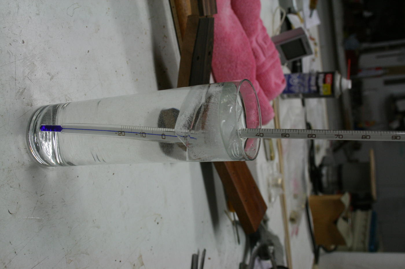

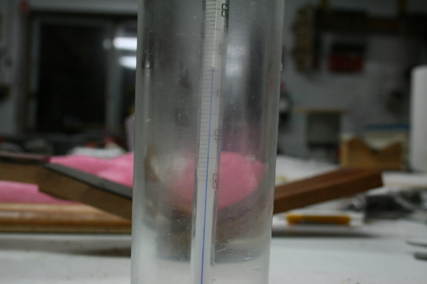

In this sequence of photos, the same test was performed using a tall, thin-walled glass. The results were exactly the same, but the exact moment the dew forms is much easier to see on the glass than on the tin can, and for that reason, I prefer the glass, and would suggest that as our preferred vessel, though if all you have is a soup can, fear not! The results are just as precise.
In the first photo, we have the glass, ice cubes and thermometer. Again, I stirred constantly(roughly 60-90 seconds) until the dew formed, then read the thermometer and wrote-down the figure. In the final photo is the thermometer having warmed back up to the air temperature. In this case, I wrote-down the temperature at the start of the tests and at the end(seen here). The difference was one-tenth of a degree, Celsius, which is not enough tom worry about.
