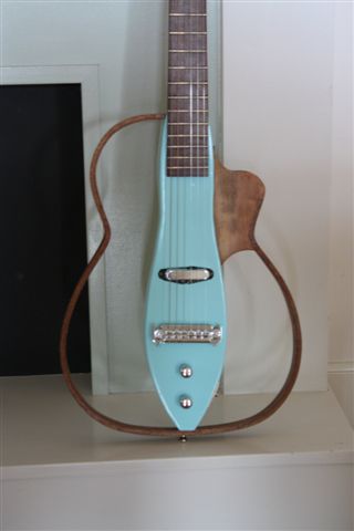

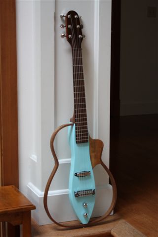

Postby Brad Robertson » Sat Jun 23, 2012 6:08 pm
After watching Manos Hadjidakis(Peacejoytown) play The Dangling Conversation on youtube, I was inspired to build a skeleton guitar. This is a mockup that started with a gift acoustic neck that was headed for the scrap pile. It sounds good to my ear, and looks good hanging on the wall.

Postby Steve Senseney » Sun Jun 24, 2012 9:21 am
Nice!
How is the balance? Is it hard to hold in a playing position?

Postby Brad Robertson » Sun Jun 24, 2012 12:12 pm
Steve Senseney wrote:Nice!
"How is the balance? Is it hard to hold in a playing position?"
Good with this neck. Even better hung by a strap. Notice that the neck connects at the 12th fret, and the skeleton guitar weighs only slightly more than my OM size acoustic Larrivee. This is just a prototype that I used to test out some construction details. I started with a general sketch, and worked through the details during construction.

Postby Warren May » Mon Sep 03, 2012 4:17 pm
Too cool! If you made the wings removable and provided a "nut elevator", the middle part looks like you could advertise it as a convertible, either lap steel with just the middle core and raising the strings or a skeleton electric with the wings added. Either way, I like your color choices that gives it a retro vibe. Neato, daddyo!

Postby Chuck Piper » Tue Sep 18, 2012 9:55 am
Brad, that is very cool looking. What is the body made of?

Postby Ben Caracello » Wed Sep 19, 2012 2:02 pm
Very cool; Has a Danelectro vibe in the best way. How are the wings attached to the body?

Postby Brad Robertson » Wed Oct 10, 2012 5:08 pm
Chuck Piper wrote:Brad, What is the body made of?
An old piece of fir.

Postby Brad Robertson » Wed Oct 10, 2012 5:15 pm
Ben Caracello wrote: How are the wings attached to the body?
The top part (non cut away) is inlet into a mortise in the body. The solid cut away is attracted with two screws. and the bottom bout is a single screw through the strap button.
