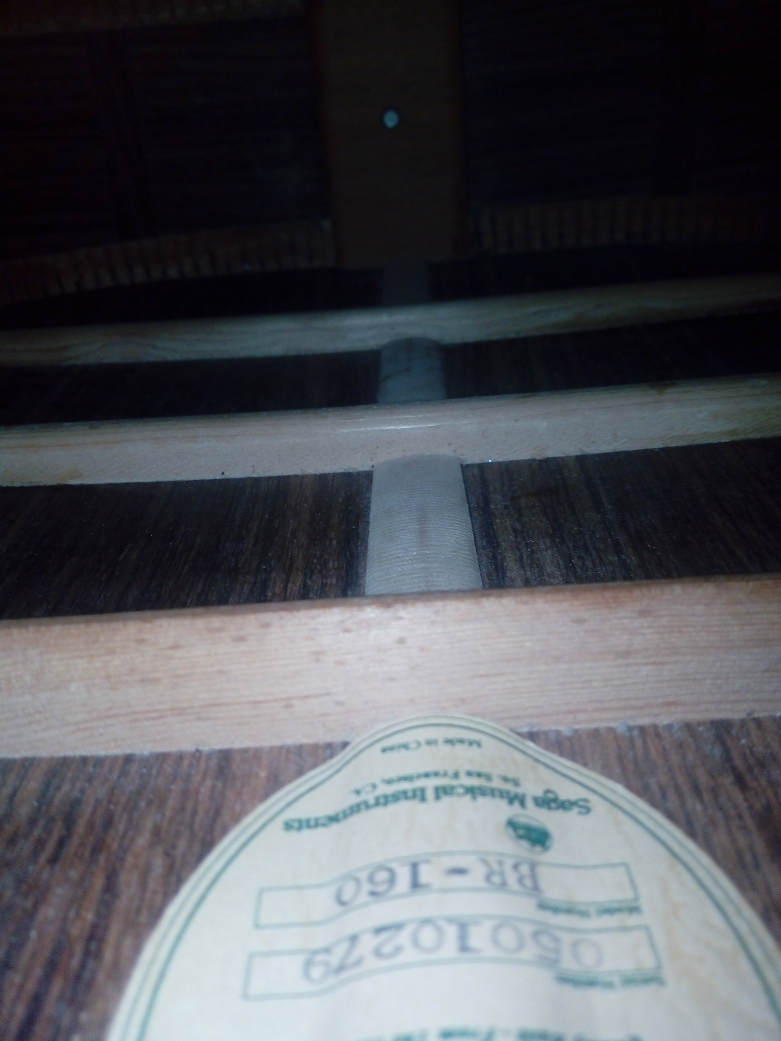

From the pictures the bridge looks O.K. and the top doesn't look over braced.
Some Factory guitars fall on the lower end of the bell curve and don't sound that great. It may have a dense spruce top that was sanded to the same specification as the run of the mill tops and left too thick. Trimming the braces might not help.
I would try swapping strings and if that didn't work pass it along in original condition to the next buyer. Someone will like the sound of that guitar.

Here's another picture of the inside... I don't know if this looks overbraced or not... but doesn't everything look very square? I would expect the cross section of the braces to be more parabolic (except on the places where it's scalloped), at least that's what I've seen in most guitars. Also the tone bars look very thick where they meet the x brace. Is that normal?
I don't want to mess with shaving the top bracing... but I just wondered.

Those braces do look heavy.
I'd feel a lot better about that top if the X-brace crossing were reinforced. The don'w facing open side of the half lap joint is in tension, and because of the sudden change in stiffness there's a tendency for the brace to split at the level of the lap. Anything that helps hold the open side together is a big help; Martin has used a cloth patch there forever,and a lot of modern makers put on a wood patch. If you opt for a wood one keep in mind that it doesn't have to be thick to work; what's more important is the glue area. I commonly use one that's no more than 1/16" thick, and about 2" long, and as wide as the brace top.
Trevor Gore points out in his book that you can use top deflection as a guide to whether the braces are too stiff. When you put on the strings the bridge rotates toward the neck, and he maintains that two degrees of rotation is a good number to shoot for. Much less than that means the top is over built, and not capable of producing the sound it could, and much less than 2 degrees is probably too light.
A lot of folks drop the brace height out toward the edges to increase the bass response. Lowering them in the middle (a 'scalloped' profile) is more effective, but also riskier. It looks to me as though you could reduce the tone bars some, at least, but as always with the top, take it easy. The 'rule of 'half' is good: take off about half of what you think you want to, and see what happens over a period of time. It's easier to take wood off than put it back on....

Thanks Alan.Alan Carruth wrote: ↑Wed Mar 11, 2020 12:23 pm Those braces do look heavy.
I will definitely follow your advice and take care of the x-brace joint.
Someone told me the way to measure top deflection with a bubble level app... I might do some tests. But I would definitely think it over a few times if I decided to shave the top braces and go very slow.

You really can't tell how large those braces are in the photo as they could be magnified from the close-up photo. A measurement of the height of the X-braces at the joint would be helpful, as well as the width of the braces.
- Posts: 56
- Joined: Tue Jun 12, 2012 7:38 pm
Re: Loss of bass lowering the saddle?
I measured that today... About 5/8'' tall and 5/16'' wide, which is pretty standard if I'm not mistaken.Barry Daniels wrote: ↑Thu Mar 12, 2020 6:19 pm You really can't tell how large those braces are in the photo as they could be magnified from the close-up photo. A measurement of the height of the X-braces at the joint would be helpful, as well as the width of the braces.
