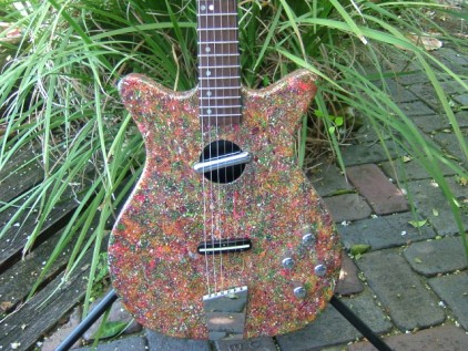

Post by Jim Bonnell »
After a little experimenting this is what I came up with.

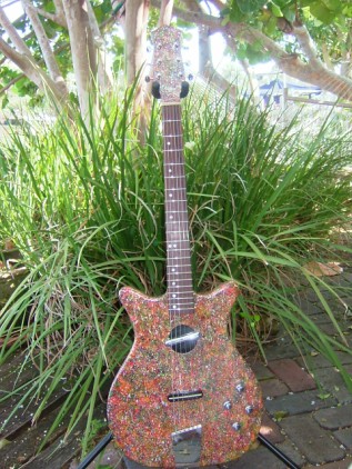

Re: Jim Bonnell's Danelectro Convertible
Didn't get all the pictures to post for some reason.

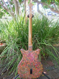

And the back.

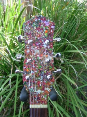

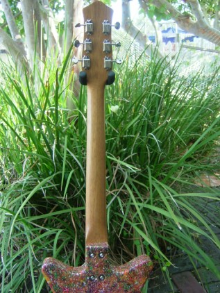

Neck
Thanks Steve and Alan. The finish was easy and kind of relaxing. First I sealed all the edges of the body with a couple of coats of Z-Poxy to hide the end grain and seams. Next I gave it one coat of white gesso (artist supply or craft stores). Next I dabbed on small splotches of different colors of fluid acrylic paints for a base coat. If you buy the tubes of acrylic instead of the fluids you'll need to thin it mostly for the next step. I next used a very cheap artist brush about 1/2" wide and a short stick of some kind to whack the brush against. Hold the stick near the body, dip the brush in the paint then hit the brush against the stick to produce splatter. Alternate colors and angle of splatter. Practice on cardboard till you get the effect you like. If I was to do it again I would thin the paint a bit more to get more splatter and less specks. A tooth brush dipped in paint will produce tiny little specks when you run a tongue depresser across it if you want that look. I then applied Target Coatings Superclear 9000 waterborne polyurethane. (no polyurethane on shoes <g>) I checked with Target about what finish I could use over acrylic and this was suggested because of it's clarity. After it cured I found no need to sand or buff. I used mostly Golden acrylics because of the quality and great color selection but it's pricey. I also used some cheap neon colors from Micheal's craft store. I think the cheap paint will work fine if you find the colors you want.
