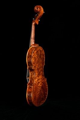

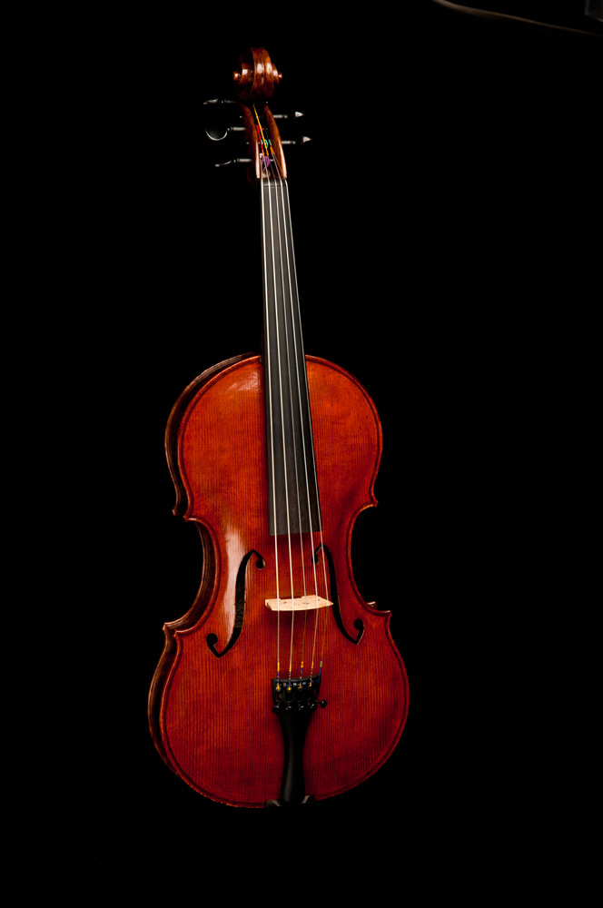

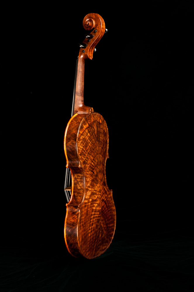

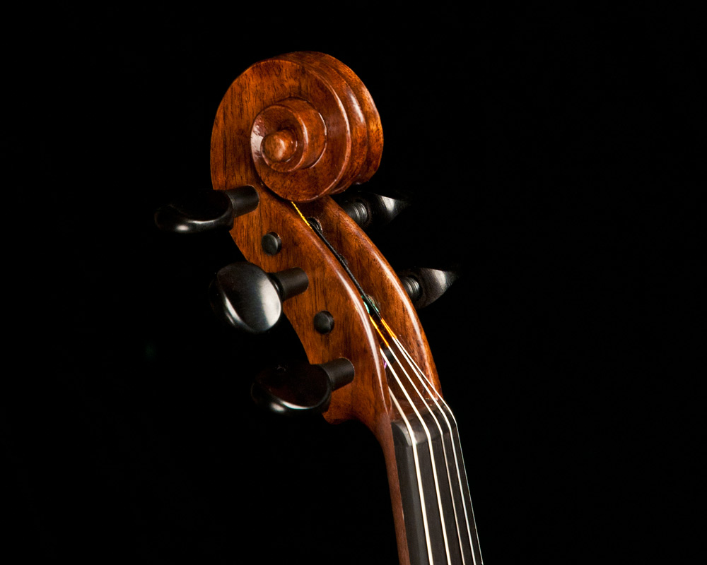

I really wish there were more "bowed" instrument post on this site. Here is one that will soon go to it's new home.

What a back!

Beautiful Barry. How about some specs?

Very nice? is the back curly walnut?

Yowza! Another stunner. Yes, more details, please!

Thanks for the kind words.
It is my standard 5 string design. Based on the "Cannone" and expanded from 14" to about 14.5". Everything has to be scaled up proportionally. Standard scale and stop lengths. 25mm wide at the nut, 5mm between strings and a standard DeSpiau 3 tree violin bridge. 10mm between 1st four strings and 11 mm between G-C. Red Spruce top and Black Walnut neck,back and sides.

Stunning! I could get lost in that back. Great work as usual.

I appreciate the positive responses. There are no good reason not to use some of the other fine tone woods we have to choose from today...other than tradition. Progress is seldom made by following tradition.

Yes, Barry, nicely done. How was the back to carve?
