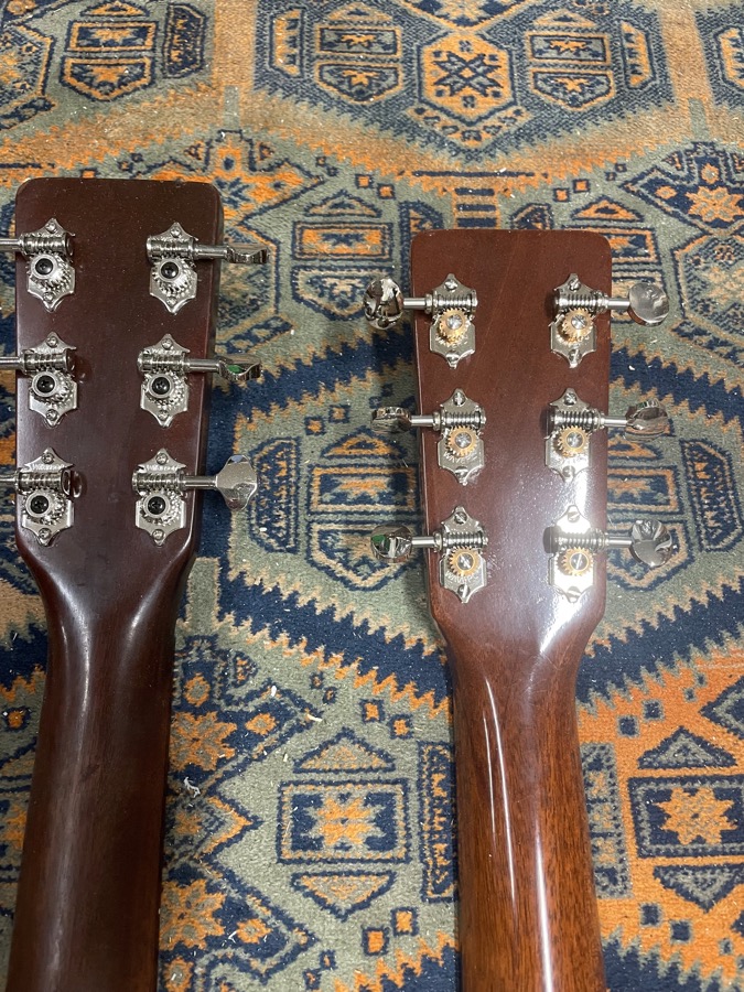

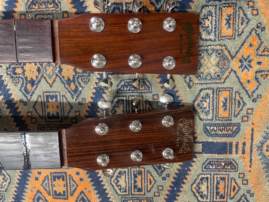

Posts: 3243
Re: Lighter weight tuners than Rotomatics
Here are a couple of 70's era Martins that I am currently working on with the Waverlys installed. You can see that the Waverly covers the footprint and screw holes of the old Grovers on the back of the peghead adequately.
