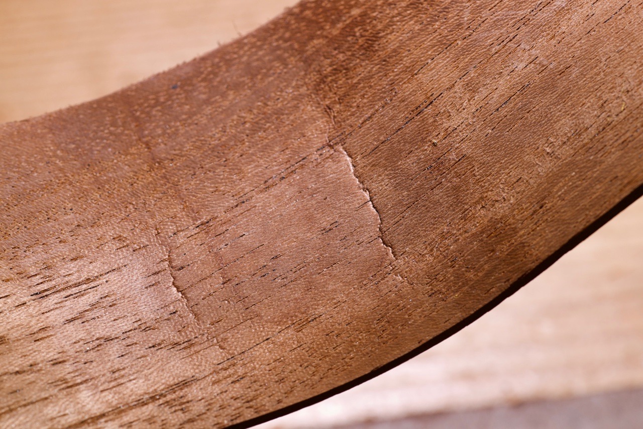

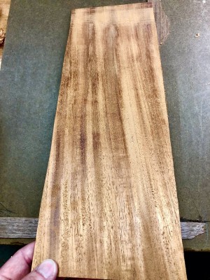

Hello, I’m still very much a rookie and I have this nice board of ribbon mahogany that I’d like to use for a guitar. I’ve had it for over 30 years and it is perfectly quarter-sawn. Here’s a scrap with no finish, water, or mineral spirits.

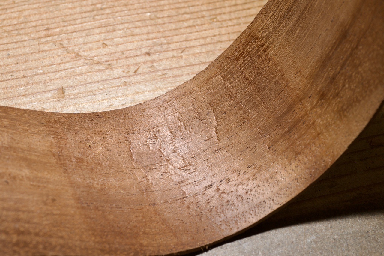

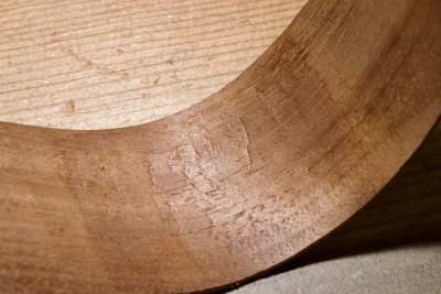

I’m trying to figure out how to bend this. I have an old electric hot-pipe bender. The first scrap I tried would just plain not bend at all. It would burn and break but not bend. I tried it dry and with some water sprayed on the surface. Next I tried soaking a scrap over night. These scraps were thinned to 2.2mm/0.087”. The soaked scrap bent easily but the inside of the bend got these crumpled or folded sections. (I’m not sure what the best term for those are.)
Can these be avoided? If so, how? The wood is lovely and should make a nice looking guitar, if I can bend it.

Yup, that's mahogany alright; unless it's sapele, which gets sold as mahogany sometimes (or used to). That's how mahogany fails in bending, when it does, though. Usually its the softer stuff that does that, but I've had problems with mahogany more or less at random forever.
A friend of mine noticed once that that an old Gibson L-0 had nice stripe mahogany, and scraped off the black lacquer to re-do it and show off the wood. It had crush marks on the waist on both sides.

The picture you posted of the crack in the sides was on the inside of the bend. I usually experience cracks on the outside, but have only used mahogany twice (without any problem).
I fold a piece of aluminum foil or parchment paper around the side piece after spritzing both sides with water. It helps trap the steam.
I use a Fox bender but I've done it free hand too. I think steam helps. I'm aware that some peoples' experience contradicts this and have caution against wetting the (maybe just a particular figured) wood, but it works for me.

Woods that are low in density often crush on the inside surface, especially if they have an open pore structure. Softwoods do generally. I've seen this also with willow, butternut, poplar, cedro, and even some soft maples.
