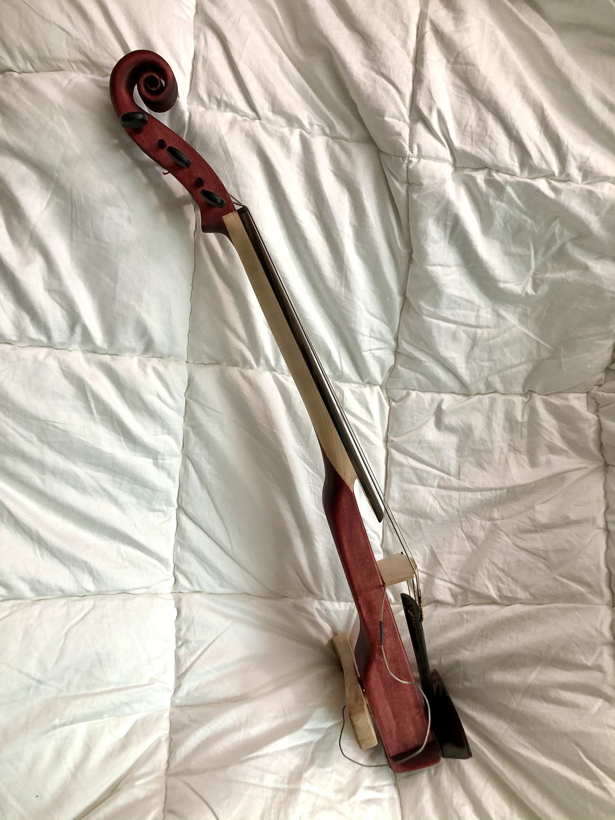

Well, here's the first musical instrument I've made. It's a 5-string electric viola for my music-major daughter. The body and bridge are maple, the fingerboard and tailpiece are Macassar Ebony. I made everything except for the pickup, the tuning pegs, and the chin rest. She wanted a chin rest that is the same as the one on her acoustic viola. I'll post better photos once I've had a chance to take some.
I have a question about the pickup. The last photo shows what I'm trying out first. It's a piezo made to go under the bridge of an acoustic guitar. The instrument sounds amazingly good, even my picky daughter is impressed. And that low F string is really loud and full, just what she wanted. However, we're getting a lot of buzzing and humming in the amp. Nothing is shielded and I'm wondering what we can do. This pickup was cheap and one solution is to try different ones if there's nothing I can do about this one. I'm very ignorant about the electronics of instruments.
Thanks,-Eric

I forgot to mention that we are using a preamp. It doesn’t make a difference with the buzzing. We have an acoustic guitar amp with inputs designed for piezo pickups. It sounds great with and without the preamp but the buzz is always there. If we hold the lead from the pickup the buzz is reduced greatly but is still there.

It will help a lot if you use a normal bridge, or, at least make some cutouts that follow similar practice. The flexibility of the bridge acts as a filter for sound in different ranges, and can make a real impact on the tone coming from the pickup.
In a normal violin it's the sound from the bass foot of the bridge that drives the top for the most part. The bridge pivots around the top of the sound post, which is near the treble foot, acting as a bell crank to convert the sideways motion of the bow into a vertical force that can drive the top. I used a small piezo element under the bass foot on the electric violin I made and got a pretty decent sound. With the pickup running all the way across, and thus under both feet of the bridge, you may be getting some cancellation of the sound.
The cutouts in the bridge have another function as well; adding damping. If you're familiar with the 'quality factor' measurement of damping, you may know that the 'Q' value gives the proportion of energy dissipated per cycle of vibration. A Q of 100 means that 1/100 of the energy is 'lost', while a Q of 30 signifies a loss of 1/30th per cycle, more than three times as fast. This works to some extent in reverse as well. That is, when you're trying to get the string moving with the bow you can only pump in energy at a certain rate, expressed as a percentage. Strings have very high Q values, which goes along with the well defined pitch of the sound they make. A string mounted on a rigid bridge can only accept energy from the bow at a low rate: it takes a relatively long time to get it going, and the bow tends to 'skate'. It also takes it a long time to wind down after you do get it going. Fiddlers don't appreciate either of these things in general, since it makes it hard to play quickly. With a solid body design you don't have too many places that can absorb sound and reduce the Q value, and the main one is the bridge.

The instrument sounds great right now. It sounds much closer to an acoustic viola than an electric guitar does to an acoustic guitar. I could not find a 5-string viola bridge so I made that one. I will probably add some cutouts to see the effects on tone.Alan Carruth wrote: ↑Wed Mar 24, 2021 4:32 pm It will help a lot if you use a normal bridge, or, at least make some cutouts that follow similar practice. The flexibility of the bridge acts as a filter for sound in different ranges, and can make a real impact on the tone coming from the pickup.
The issue is a hum that sounds like a ground loop problem. How do guitars with piezo pickups solve this?

Shielding. The pickups themselves are normally shielded, Check the ground.
