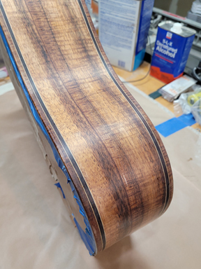

Re: Epoxy as a pore filler
Here are a couple of pics. It is a little tough to see, but there are unleveled specks and a couple of sand throughs.

- Posts: 3242
I wouldn't worry about a few small unlevel areas. After all this is filler and you can get the areas level during subsequent finishing. But the sand throughs need to be dealt with because they can show up as a different color when the finish is applied. I would mix up a small amount of your epoxy and thin it with some alcohol. Pad a thin layer on the sand throughs, let it cure, smooth the area with sandpaper being careful not to sand through, then start applying your finish.
Thanks Barry. What kind of pad and what grit sandpaper would you use? Would you say thin the epoxy to 50/50 with denatured alcohol?
- Posts: 3242
Not 50/50, that would mess with the setting. Add just a little until it is less like syrup and more like cream. Fine sandpaper like 220.

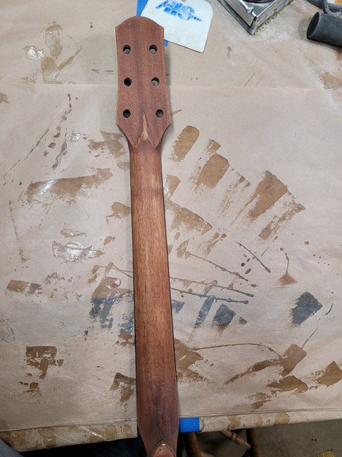

Here is the mahogany neck with a couple Zpoxy coatings that were sanded back to the wood. I have ended up with a number of splotchy areas, as you see and the headstock is darker. Do I need to try to sand this neck totally back to bare wood, which I know is tough to do, especially in the heel and start over? This was my first try with Zpoxy. Any suggestions are greatly appreciated!
- Posts: 506
Did you read thru the link I gave you? Lots of pictures of mahogany with Zpoxy.
Hi Freeman. Yes, I read your thread and what you show is how I wanted the neck to look. Since I obviously did something wrong in my process, I am asking how to back out and get the neck back to a point where I can follow your process. I tried sanding down to the wood before I asked for help on this thread, but could not get all of the neck to have even color (the Zpoxy must have really soaked into the pores!). I had hoped by applying another coat of Zpoxy the color would even out, so I did. But, as you can see, the neck color is not splochy. So, I am not sure what to do at this point. Do I sand the neck until I get all of the Zpoxy out the of the pores and then start over using your process? Thanks!
Have you tried wiping the neck with either DNA or naphtha right now? That pretty much shows the colors that you will have under finish. You might be surprised that it evens out, which is kind of why I do the highly diluted last applications. What I am looking for is to hold that same color that I get when its wet with DNA.
If you aren't happy with that it might be necessary to sand back. Before I put any finish, stain or pore filler on any wood I always wipe with DNA or naphtha. Remember too that end grain will absorb more than flat grain, but my experience with Zpoxy is that doesn't look that bad. The pics in the link are about the best I can do.
I will try that Freeman. Thanks for the suggestions and the complement. Your guitars look amazing! I quit building for a year with all of the pandemic stuff going, but am just getting back to it. Thanks again!
