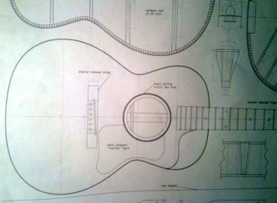

Hi thanks for all your advice and comments, I have decided on a shape for my cutaway the Florentine cuts look good but I have decided on a more rounded Venetian style cut, I have a rough template made and I think tomorrowi will try and bend the side, hopfully it won't be a total disaster,
L 00 cutaway template
Steve Senseney
Posts: 673
Re: cut away advice
Post by Steve Senseney »
Your template indicates a brazilian rose wood bridge, but you are adding a plastic inlay for the rosette?

I think I will change that up a bit might have a go with some purple heart or sone abalone or something, I haven't decided on the final details yet mahogany back and sides spruce bracing maybe a cedar top mahogany neck not sure about the fingerboard yet, although I think I might try binding it aswell, and maybe have a go at a bit of custom inlay on the fretboard too, just something to give myself a bit of a challenge and hone my skills, I'm also looking to fit an acoustic pickup with thejack in the strap button and I might do some chamfers around the lower bout to make it a bit more ergonomic , but we will see it may evolve as I'm building it
Re: cut away advice
That is quite a drastic bend there Jonny. You could lighten it up a bit! I make a guitar just like this, and while I think I could make a more drastic cutaway, I am more comfortable (and get no breakage) doing it this way...

Mark is right. That one will be agony to bend.

Thanks Mark, I may have to have a rethink,

I'm currently building an L-00 from that exact same drawing (Grieller [sp]). When I drew out my cutaway, I took my curves from the pick guard and adjusted as needed. Hopefully the two curves will compliment each other once done. My cutaway ended up being between yours and Mark's but closer to Mark's. I'll try to take a picture of the drawing if that will help. With your cutaway I would be worried about binding more than bending. If there is any dome to your top at all, you have to ask the binding to bend in two directions as once. A really curvy pronounced cutaway exaggerates the issue.

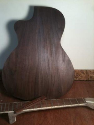

I managed to make the bend fairly closely I have it clamped roughly to my template to fully dry out, I will come back later to see if I need to adjust it slightly, I had to soften the curves slightly but overall I'm happy enough, I have a few scorch marks to deal with ect. but I don't foresee a any further problems, also I used a 1" pipe which actually is about 1 1/4" o/d to bend the cutaway, thanks for all of the advice i appreciate it.
Steve Senseney
Posts: 673
Re: cut away advice
Looks like you did well!

The way you are letting the sides dry out seems like your asking for trouble. I would not expect them to come out anywhere near to vertical. A form is a very handy thing to use.

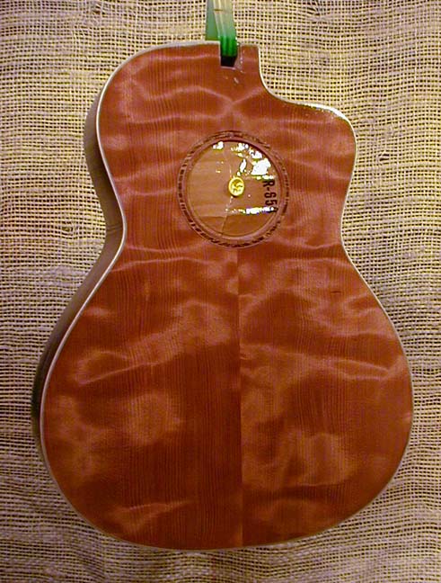

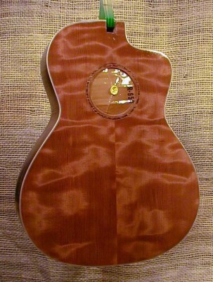

Looks like it bent well, what wood is that? I love how altering the cutaway curve can change the whole look of a body shape. Here is mine.
Posts: 1475
Re: cut away advice
Post by Michael Lewis »
Bryan, I like the lines of that cutaway, rather like the Gypsy guitars. Eminently easier to make too.
