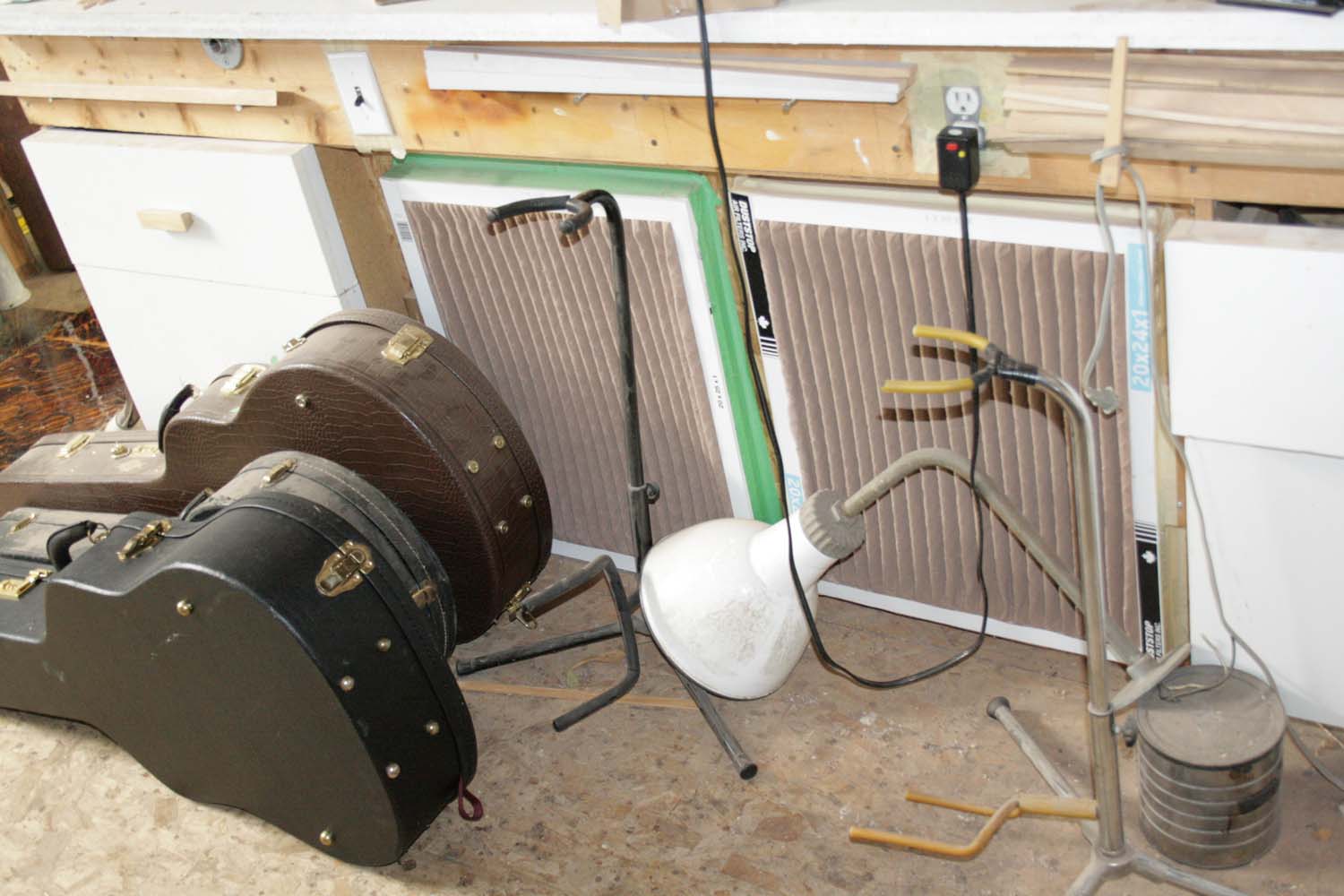

Mario Proulx
Posts: 821
Re: Shop made air filter advice
Post by Mario Proulx »
Here are my filters. There are three filters in each bank, with the final one inside being a very fine filter.
Mario Proulx
Posts: 821
Having re-read the entire old thread, it appears incomplete, so here goes. I did close off the opening across from the blower, but I didn't cut the wall to add ducting. What I did do is to remove the diffusers at the top of the wall and enlarged the area of each one. And while I originally had a 4 hours timer on it, I now have a simple switch. It runs so quietly that I don't mind it running all day if necessary.
