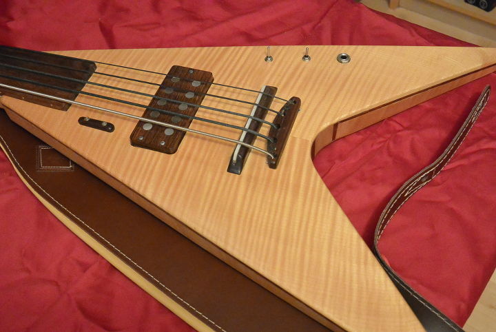

In order to give You an impression on the situation - the new bass will be based on that project:David King wrote:That 23º sounds like a lot for a bass string ...
In order to reduce the string angle i added a pseudo tailpiece:
For better playability i should keep the bridge position despite of the shorter scale (76 cm instead of 80). I might move it by 2 cm toward the pickup in order to have more room. And i do not like the fat and dark block between the legs of the V. Visible tuning pegs neither...
Mhmm...
