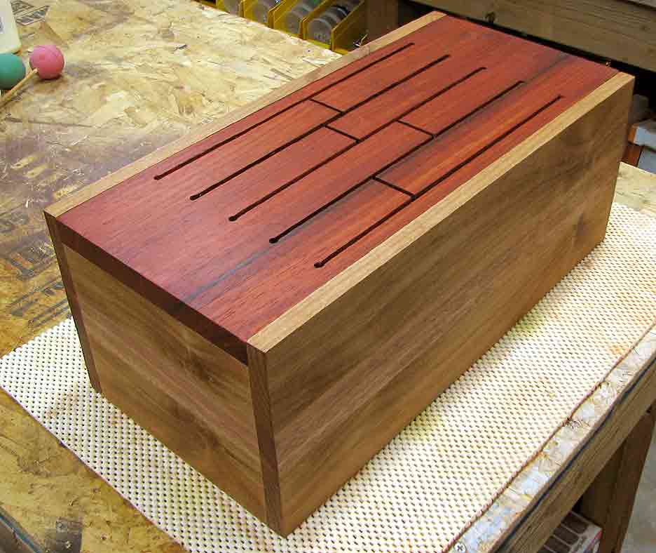

I made one about 5 years ago for a challenge here - that was before posts were saved, so the thread is gone to cyberspace. I was not happy with it as I could not tune it - I don't know why it wouldn't tune, despite huge alterations of the mass of the tongues. I'll post a few pics of it. The top was padouk, the box maple.

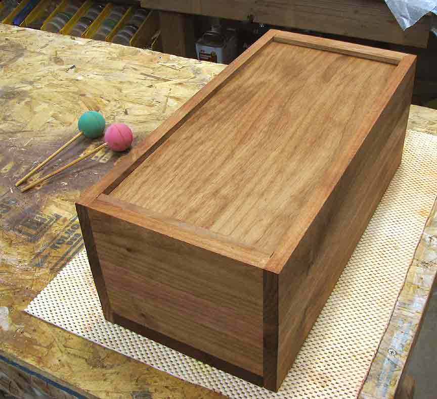

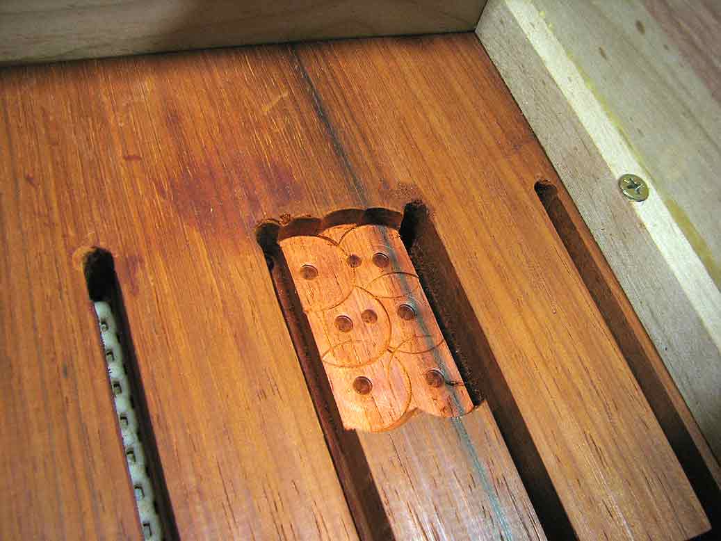

Here's how I removed material from the inside of the tongues with a forstner bit - didn't change the note at all. Here's the bottom of it and the rubber ball mallets - I made the bottom removable so I could try to tune it. Hope you have better luck than I did.
