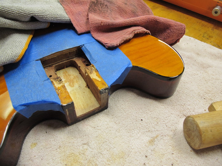

Hi Berry, Thanks for the response.
The answer to your question is, I guess, the same for most guitars the neck is pulling up as evidenced by the gap at the neck joint.
I've watched many videos on steaming a dovetail joint but this is very different & I'm not sure if the steam will penetrate all the areas necessary.

The fact that there is already a gap is in your favor. That gives a point to inject steam and also indicates that the neck joint has already been in movement and should loosen up easier than a tight joint. You may need to remove the fretboard first. That will give you access to the top of the joint where you can drill additional steam injection holes.
I found a webpage with some photos of the neck joint:
https://historicmakeovers.com/guitars/1 ... storation/

Thanks for that - It gave me some ideas. Now I'll need to get some tools in order.
I'll let you know how it goes.

Worked like a charm - all done in about an hour, & very little damage to the finish.
The best part was the bolt (see photo) I drilled & taped
part of the tenon & used the bolt to push the tenon up.
Thanks again for your help.
