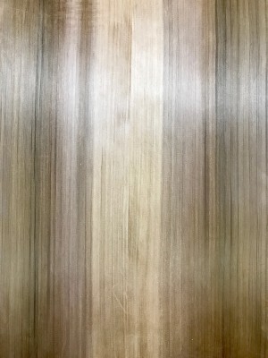

Here's the top from the old piece of cedar siding.
I cut two pieces off the 13' board that are 24" long. This is not a book match, one is folded back. I think they look pretty good. I flattened these sides with my big ECE jointer in the pic. It's a beast, it's 23.5" long with a normal 2 3/8" iron. I sharpened it tonight and flattened and waxed the sole. It glided through this softwood with almost no effort.
The next step is to resaw them to a good starting thickness. One side is already pretty smooth but I want the final thickness to be about 3.1mm. My bandsaw has a new blade on it and is running really true. I'm hoping the next entry will show a successful resaw effort.

I'm glad to see you jumping in! That will be a nice looking top! I don't know what you are using for back and sides but that would look great with walnut.

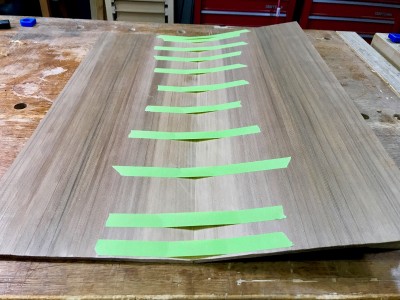

Shooting The Top Joint
I worked hard on making the plane and shooting board for this. It's feels good to actually use them to joint a top.
Here's a video of me shooting the joint.
https://youtu.be/ze3M0CZny14
I think it turned out very tight.
I surfaced one side before resawing. This is a hint of what it might look like in guitar form.
I like this taping method for clamping once the joint is really good. I hope there aren't any issues with it you all have encountered.
The glued joint with the tape is very stable. Even with the tape on it the top rings with a very pleasant and musical tone. I have no idea if it's the right tone for a guitar but at least it has a ring and not a thud.
That's the progress so far.

In terms of tone, any kind of bell or drum like tone is what I listen for. If I hear a real dead, thuddy tone I feel that means there are internal flaws that haven't come out yet. Now, I work with 1" thick raw stock, not 200 thou thick. If it is ringing for you, I would say it is good to go. It's nice wood.
Back and side wood does not have to be quarter sawn. In fact, a lot of highly figured maple is flatsawn to bring out the curl or quilt. Personally, if I had some nice mahogany with some life to it, that's what I would use for a first instrument. It is so easy to work with and bends quite easily, at least for me. Your cedar is going to darken a lot when you put finish on it, so a darkish mahogany would compliment it nicely. Here is the guitar I made of deck board cedar and a billet of mahogany that I hollowed out.

Learning as I go, what does it mean to candle the top joint? I held it up to a bright light and didn't see any light coming through. Is that what you mean?Barry Daniels wrote:Did you candle the top joint before you glued it up?

I'm getting an education through failure here! Overnight one side of the top developed a crack. I'm gluing it together but I'm thinking I should maybe cut and resaw the next piece on the board and redo. What is the collective wisdom on this? Never start with a top piece with a crack? Is that asking for trouble down the road? The piece that cracked was the one closer to the end of the board. The next piece shows no sign of a crack and neither does the next one in line. That seems safer to my rookie instincts.

Yes, candling is holding the joint up to a bright light. I usually go outside and use the sun. Any slivers of light indicate a slight gap and the joint should be planed again.
Regarding the cracked side, it can certainly be reglued and it may never cause a problem down the road. However, if you have more of the original board left over I would remove the bad part and redo it. My concern is the crack was probably always there since it was the end of the board. So there is a weak point there. Also, dirt and oxidation may have been present in the original crack which will minimize the strength of any glue you use to repair the crack.

Did the crack in the top happen all on its own or did it get bent or bumped? Cedar can be splitty, if it happened from a mild trauma, I'd call snider gluing it and moving on. Racing and flying to the rim will give it more support. If it just happened sitting on the bench, I'd be more concerned.

Good to hear I might have done it right. I've done a lot of sawn veneer and used that technique to join it. The veneer was 1/16" thick. I got pretty good at it but it's been a while.Barry Daniels wrote:Yes, candling is holding the joint up to a bright light. I usually go outside and use the sun. Any slivers of light indicate a slight gap and the joint should be planed again.
I think the crack was there. I am going to use the next section of the board instead. If more cracks develop I think I'll abandon this board.Barry Daniels wrote:Regarding the cracked side, it can certainly be reglued and it may never cause a problem down the road. However, if you have more of the original board left over I would remove the bad part and redo it. My concern is the crack was probably always there since it was the end of the board. So there is a weak point there. Also, dirt and oxidation may have been present in the original crack which will minimize the strength of any glue you use to repair the crack.
