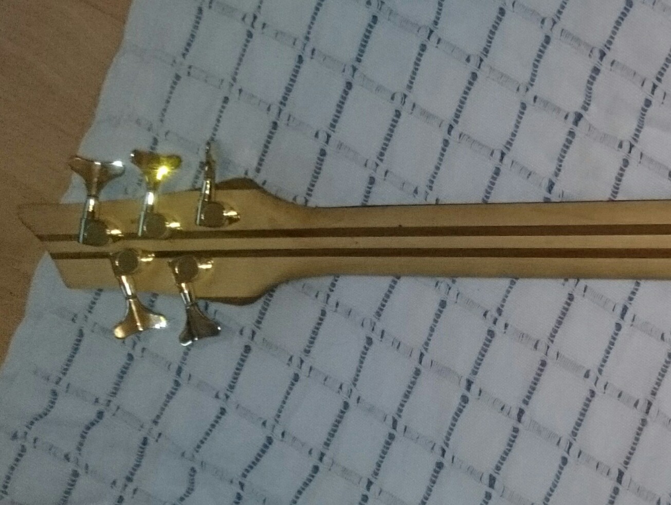

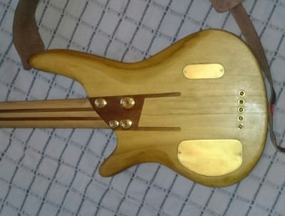

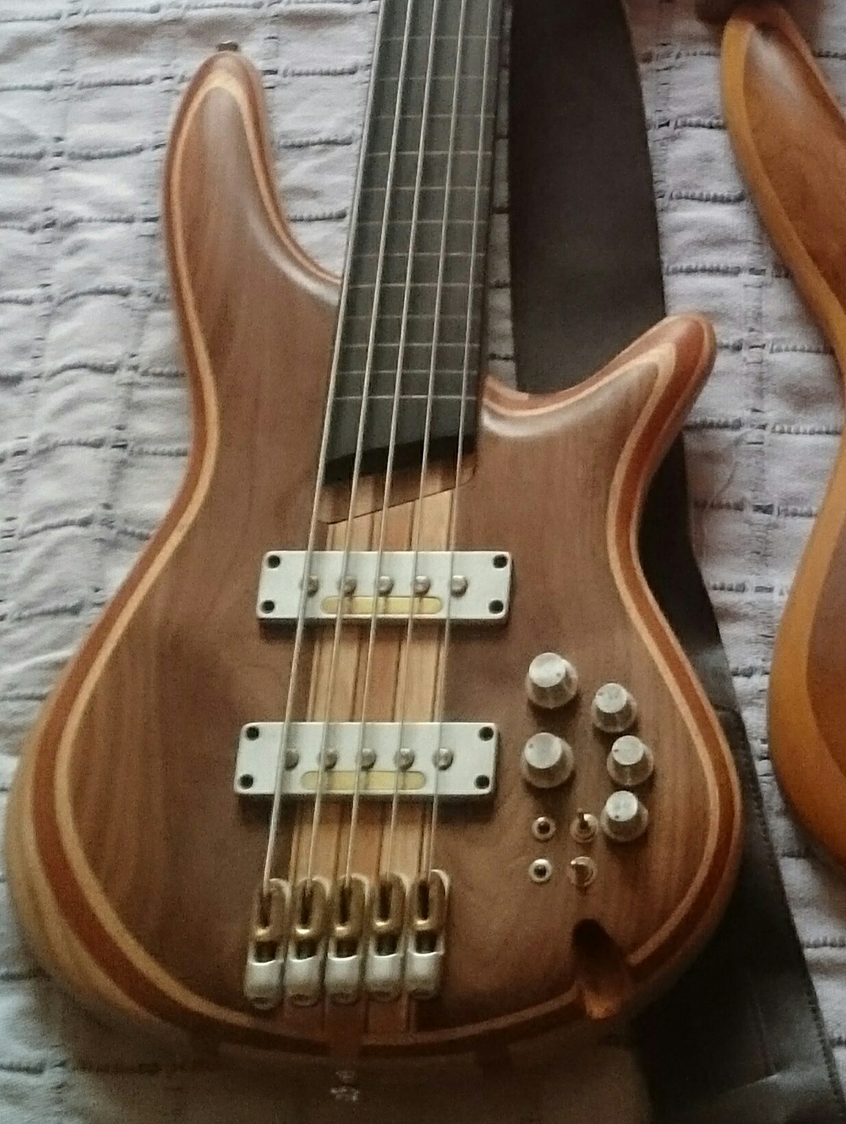

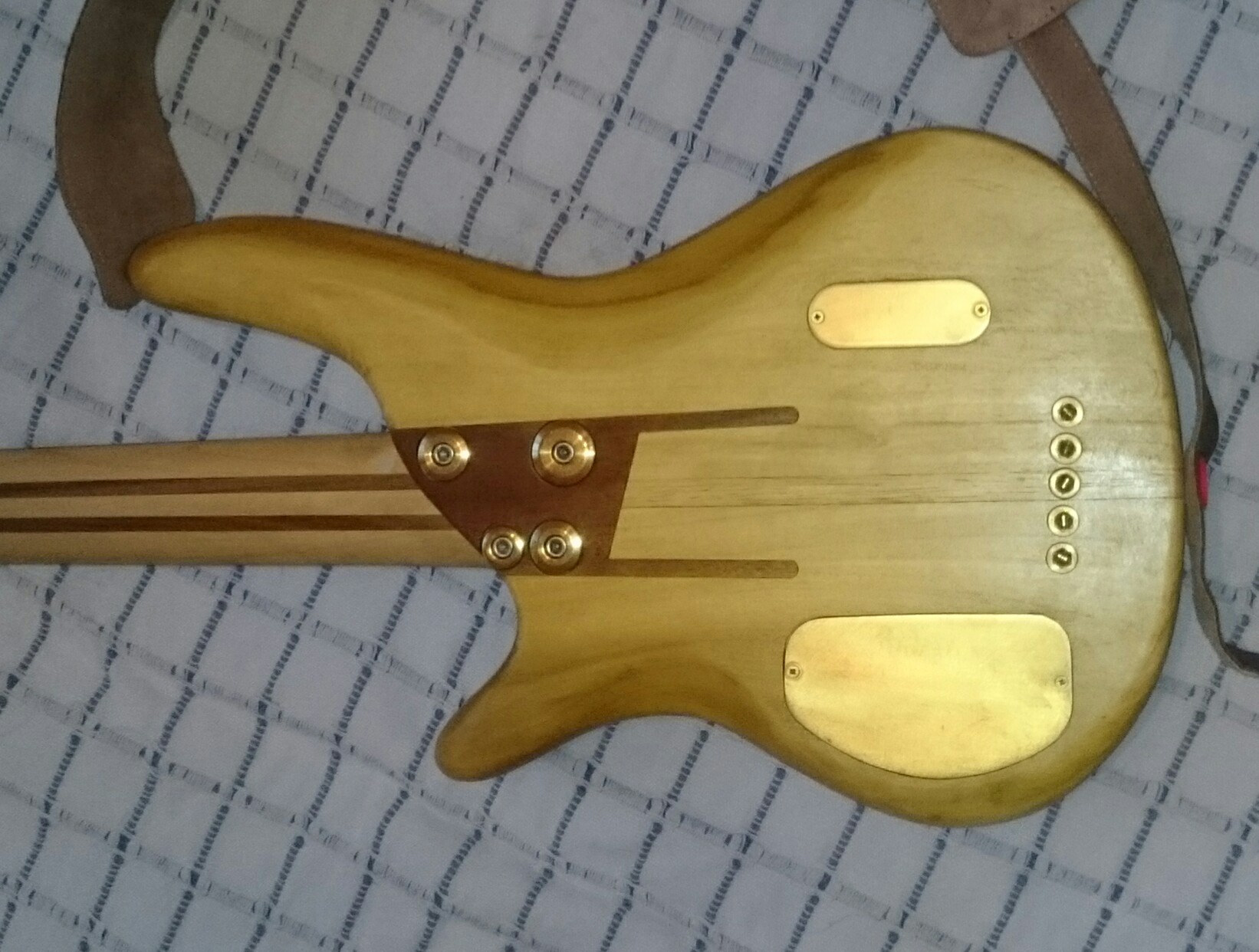

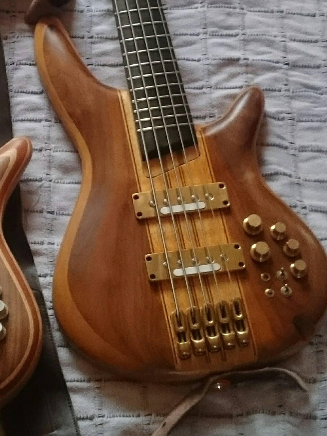

Having seen some of the many six stringers I have built over the last few years, the bass player in our (embryonic!) band asked if I would build a bass.
The design influences are obvious so I accept no credit for styling. I decided to make a fretless at the same time.
Everything is hand made by myself with the exception of the machine heads and electronics.
Specs are as follows.
Fretted.
34" scale, 24 frets.
Monorail style bridges.
Hand-wound pickups, Alnico V rod magnets.
Neck 12k impedance!
Bridge 17k impedance!!
Body pearwood body with walnut and maple cap.
Neck walnut and maple five piece laminate.
Fretless.
As above with seven piece laminate neck and ash body capped as per fretted.
Both pickups run around 20k!!

Can you explain the switching?
Chris Thomasi
Posts: 13
Joined: Tue Jan 29, 2013 7:49 pm
Location: York, England
Re: First Bass Builds
Post by Chris Thomasi »
The switch nearest the jack socket cuts all output, basically battery saving.
The second switch bypasses the graphic equaliser /pre-amp and takes the signal straight from the blend pot and volume to the amp.
Each switch has an indicator LED.
