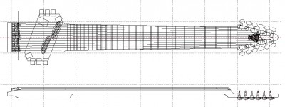

How did you arrive at your design, Keith? Have you built sticks before, or did you use plans or base the design on an existing instrument?
- Posts: 52
- Joined: Sat Apr 07, 2012 3:54 am
- Location: Cape Town South Africa
Re: Chapman stick?
I based my design firmly on the Chapman Stick by looking at the published photos and specifications on the Chapman website then did a bunch of cad drawings to make sure things panned out. Mike, my bassist friend, then reviewed the drawings and we came up with a final layout.

Here are some shots of the CAD drawing I did to get the layout defined.

- Posts: 3254
- Eric Knapp
- Posts: 651
- Location: Wisconsin, USA
Re: Chapman stick?
They are a bit crowded on my Stick, but they are mini-tuners and they all work fine. One interesting feature is the two outer tuners are reversed so all the strings are completely straight to the tuners.Barry Daniels wrote:The tuners look pretty crowded. But then I have never built a stick.
