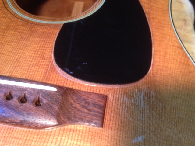

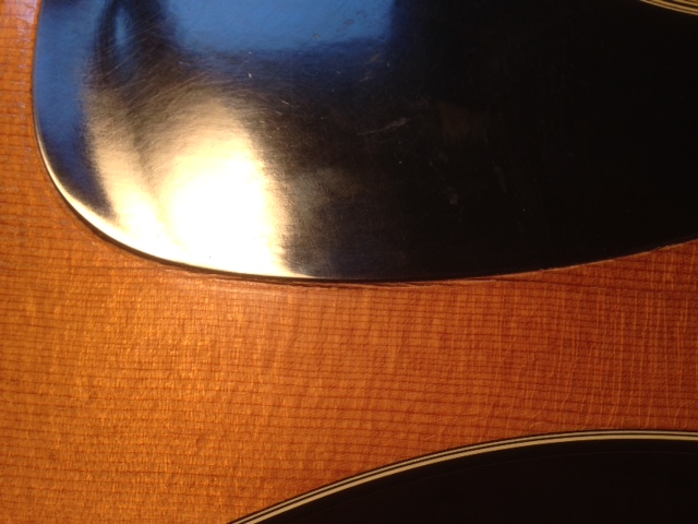

Thanks very much for all the excellent advice. I essentially did what you all suggested. I was able to gently heat the pick guard and remove it with no damage to the wood below. There was significant warp to the top and a second crack by the E string side. I clamped the top in both locations to flatten it out and left it for a couple days under moderate pressure. It did the trick perfectly. I used Hide glue to glue the cracks and cleated the larger crack. The smaller crack on the E string side was short and stopped by the brace below so I didn't add a cleat there.
As you suggested, I was unable to re-use the original pick guard and purchased a Stu Mac replacement which proved to be just big enough to cover the the old footprint. I used shellac to seal the wood and a taped razor blade to level the varnish bump at the edges from the original pic guard. The owner of this particular guitar was a local music store I am doing some work for on occasion. Along with the pick guard repair, he also got the neck re-set, new bone saddle and a minor side crack super glue repaired.
I particularly appreciate the information on what you charge. I definitely gave this guy a deal! Being somewhat new at this and hardly considering myself a pro yet (though I'm getting there), I did all the work for $325.00.
