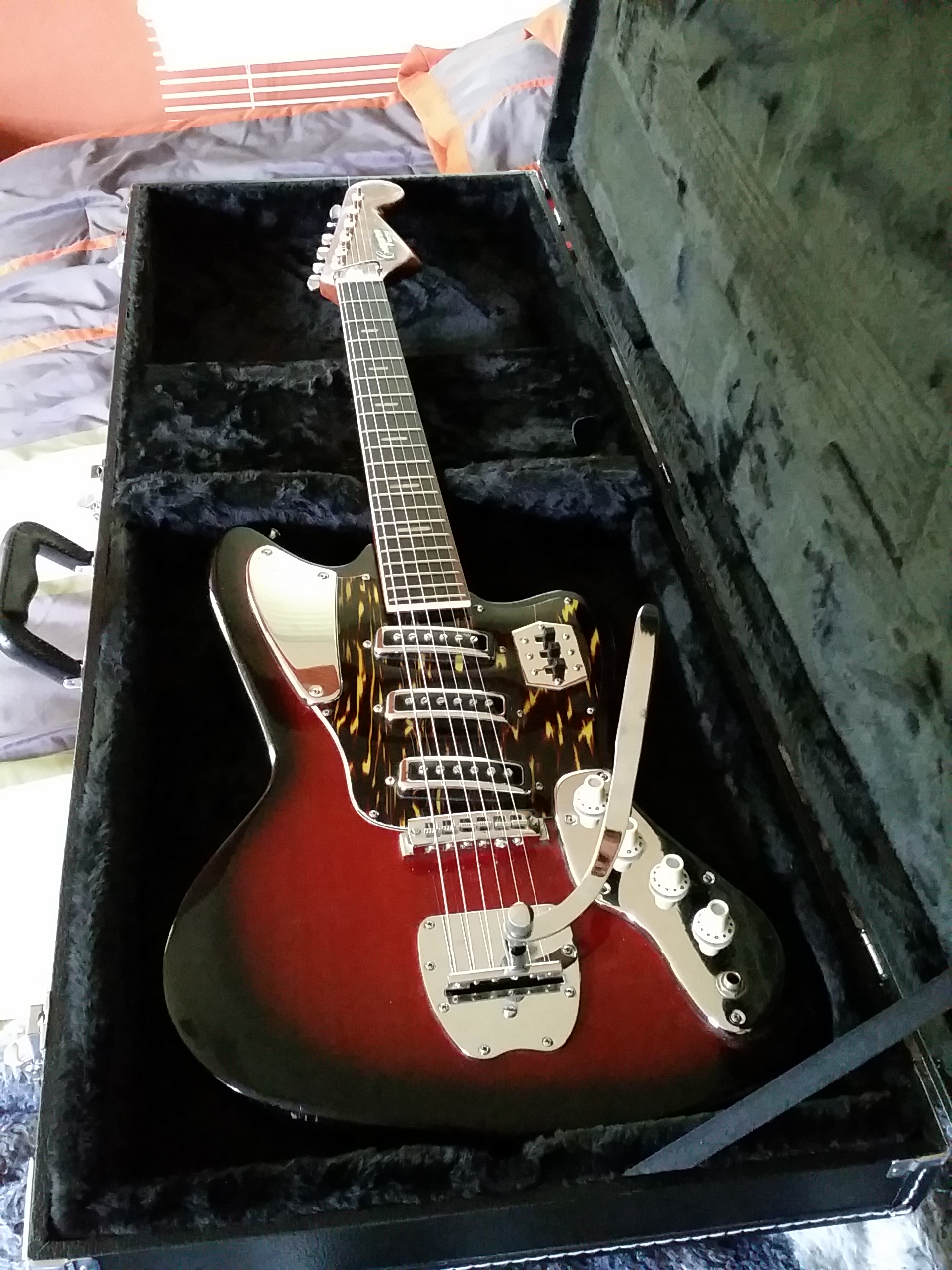

About a year ago I purchased a great vintage, probably mid 60s, Japanese Bruno Conqueror...which is probably one of many names that Teisco or Kawaii used.
It wasn't terribly expensive , and it looks like a Fender Jaguar knock-off (see pic), but it's sort of a cross, as far as scale length, between and Jag and a Jazzmaster. It's lighter than both a Jazz or Jag, which is really nice, and it just feels really, really, nice as far as playability. So I've been striving to make this thing solid, and it's not without some issues.
Main thing right now is tuning.
Obviously the tremolo system on this guitar is weird (but kind of awesome), and I'm not sure how much it contributes to the tuning problems (probably a lot) but I don't think there's a whole lot I can do in this area. I've tried fitting a standard updated Jag/Jazz tremolo, but this Bruno has a thinner body than a Jag/Jazz body and I'd have to route through the body just to give the Jag tremolo the space/depth it needs. Due to this, I don't mess with the tremolo too much since I know it will put the tuning out of wack.
So the next step was the tuning machines.
The old ones that it came with, the posts were smaller than the holes/bushings they were fitted into, so I figured this was likely a big issue. Maybe the tuning machines were replaced at some point since I can't see this guitar coming out from factory with posts that are not the correct size...but who knows.
Nevertheless, I was able to replace the tuning machines with some Kluson Deluxe, that seemed to fit great, but I can't say they've solved the tuning issues.
So now I'm looking at other things, mainly the bridge and "tailpiece" alignment, and how the strings come over the saddles to the nut etc. My main question is, if the string location in the tailpiece, saddle and nut, aren't all aligned together, will this cause tuning problems?
It looks to me like the nut and tailpiece don't align quite right on this guitar, because if I let the strings settle into a location on the saddle that feels natural, they tend to group themselves more on the "bass side"/low-E side of the neck, and I get a pretty good gap between the high-e and the edge of the neck. I compensate for this by pulling the strings into different positions in the saddle, but then it creates an angle between where the string comes out of the tailpiece and where it goes over the saddle; so, instead of coming straight out of the tail piece, straight over the saddle and straight down to the nut, they'll come out of the tail piece at a slight right angle only to be redirected over the saddle to head straight down to the nut. Seems less than ideal, but I'm wondering if this will cause issues with tuning? The nut seems in the right place, and spacing seems good at the top, but either the bridge or tremolo/tailpiece is off....probably the tailpiece I'm guessing.
Any insight into this issue you guys might have is greatly appreciated, or maybe it might be something else? I'd love to get this thing solid so I can gig with it, but at it stands, it'll go out of tune (most the time it's the G, B and e strings) within the first 12 bars of a song depending on how hard I'm playing etc.

I can't see how an alignment issue would cause the tuning to slip after a few bars playing. Something must be moving. Candidates:
1 Tuners slipping. I'd expect it always to be the same strings. Swap tuners around to see if the problem also moves.
2. String binding in the nut. Lubricate with graphite (pencil lead), recut slots if this helps.
3. String sliding sideways on the saddle, if the path is angled at that point. But the picture seems to show ridged saddles - unlikely?
4. Tailpiece moving, but wouldn't that affect all strings, not just a few?
5. Too much string wound round tuning peg, so that the windings shift when playing.
Anything I've missed? I'd start with 2 and 5, as they are quick to check and likely candidates.

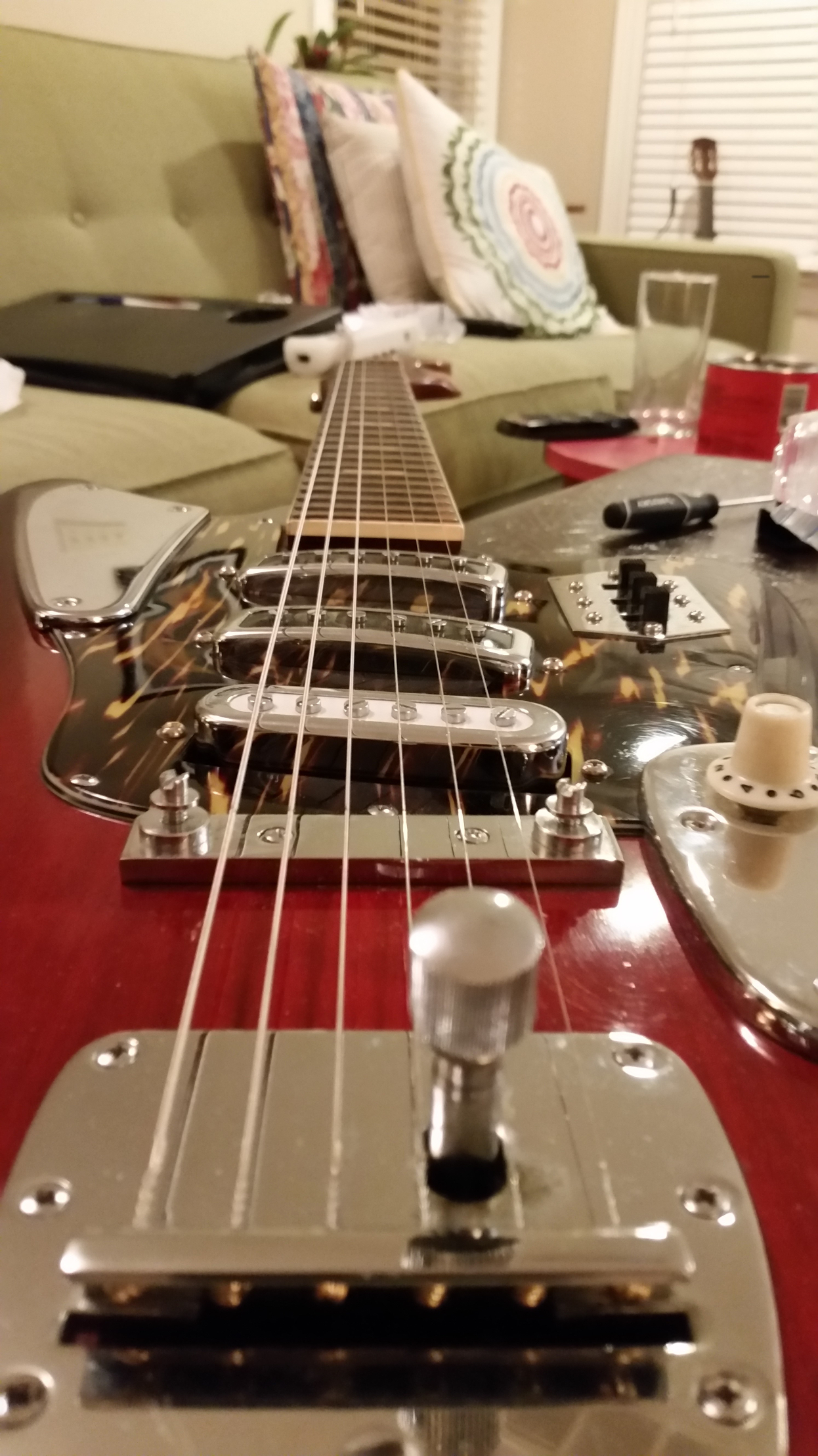

Third thing, I removed the bridge and tightened down the strings just to see where they sort of naturally lay on the pickups/neck etc. (should have thought of this earlier)
I took a picture of this just for reference, and they do tend to sort of favor the left side of the neck, so I just made a mental note of that when I restrung the guitar with the bridge in place. Some of you said this is probably not the problem, but I figured it was worth checking out anyway.
