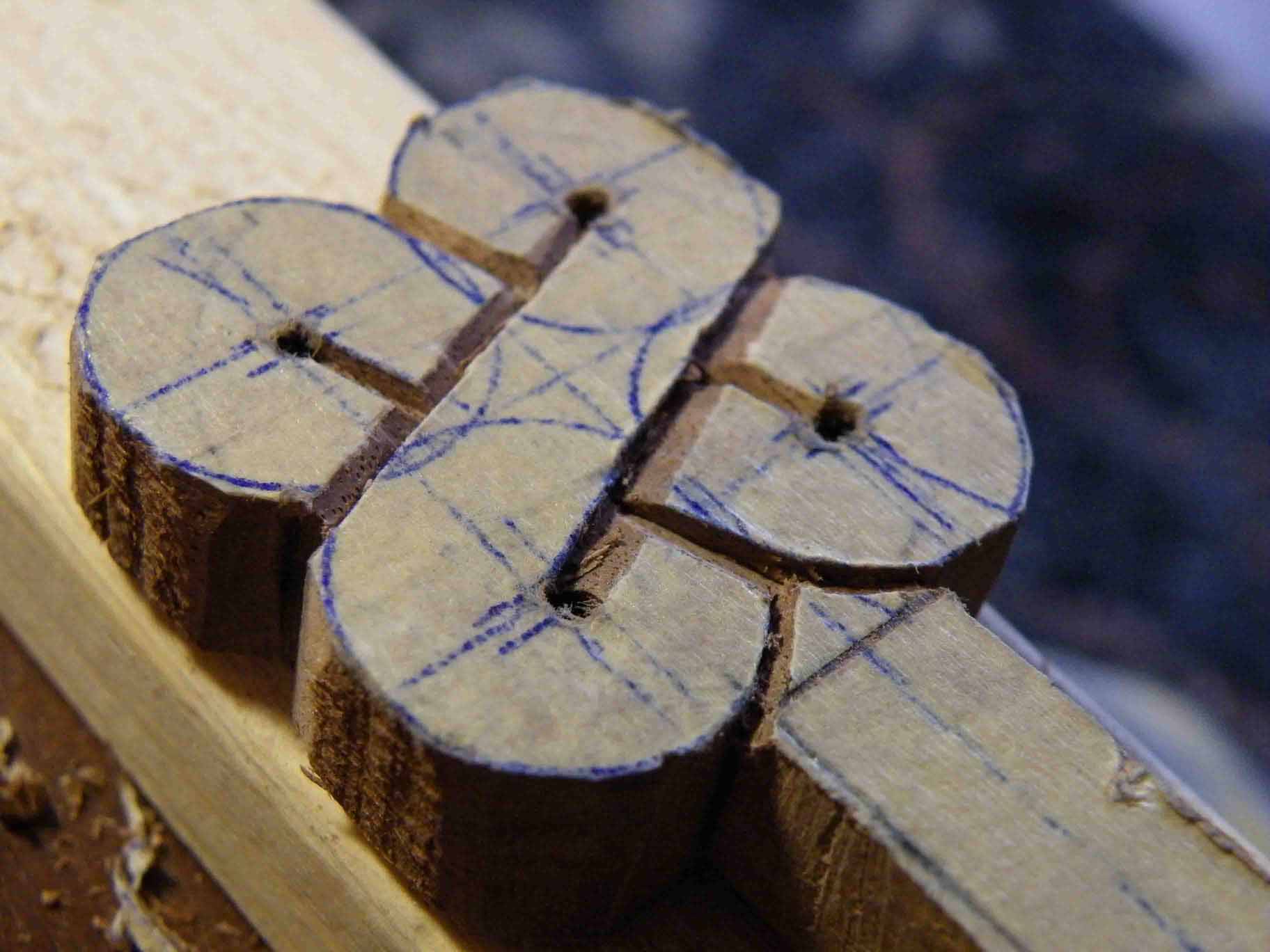

Thank you for the responses gentlemen ... most appreciated. Thank you for the link to Clay Schaeffer's build Rodger! Bryan, I am creating a removable neck for a couple reasons ... I would like to try the neck with different bodies, and I am reluctant to glue the neck in in the event I want to reverse my steps. I decided to start with making tuning pegs from walnut. The neck is made from laminating mahogany cut from a plank. I don`t have access to a shop, so everything is done mostly by hand ... a coping saw, palm chisels, elbow grease. Just having fun here....I am not a luthier.
- Posts: 1391

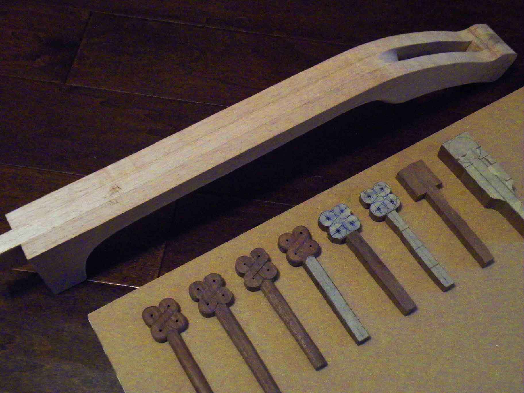

Those are lovely carved ends for your tuning pegs! As I said before a bold on neck arrangement makes neck removal simple. I use a bolt on butt joint with hangar bolts. I'm sure there are threads here on that; do a quick search.

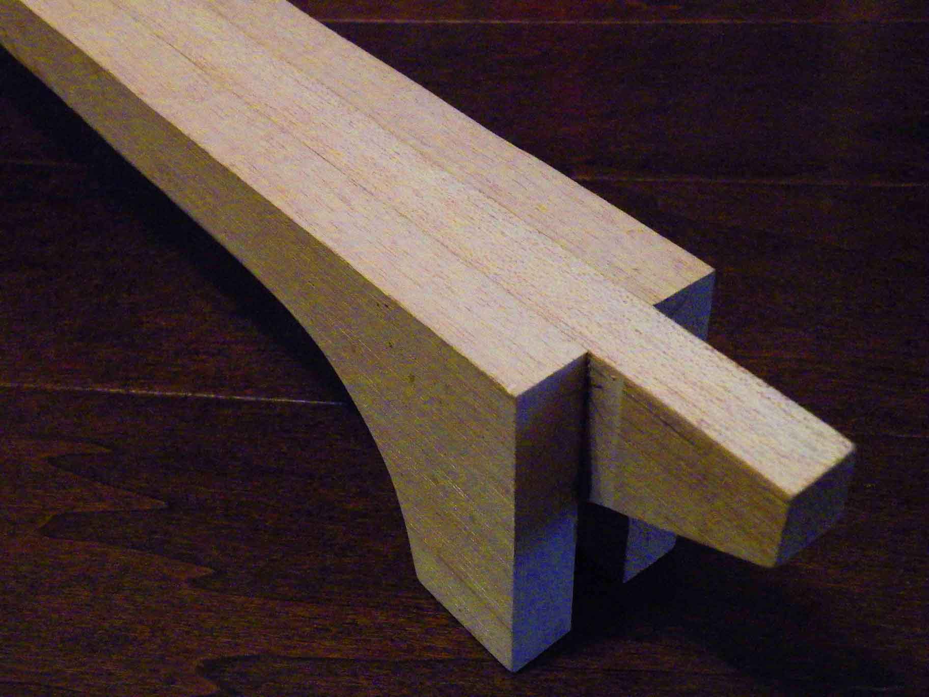

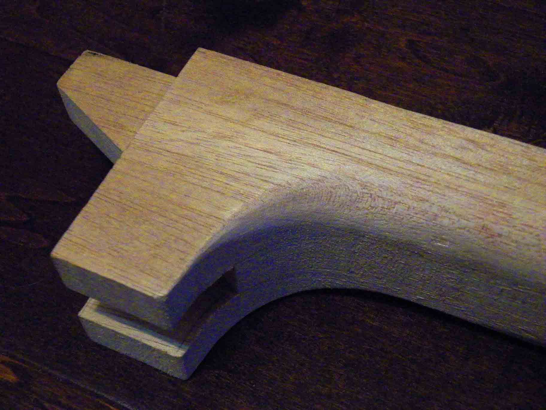

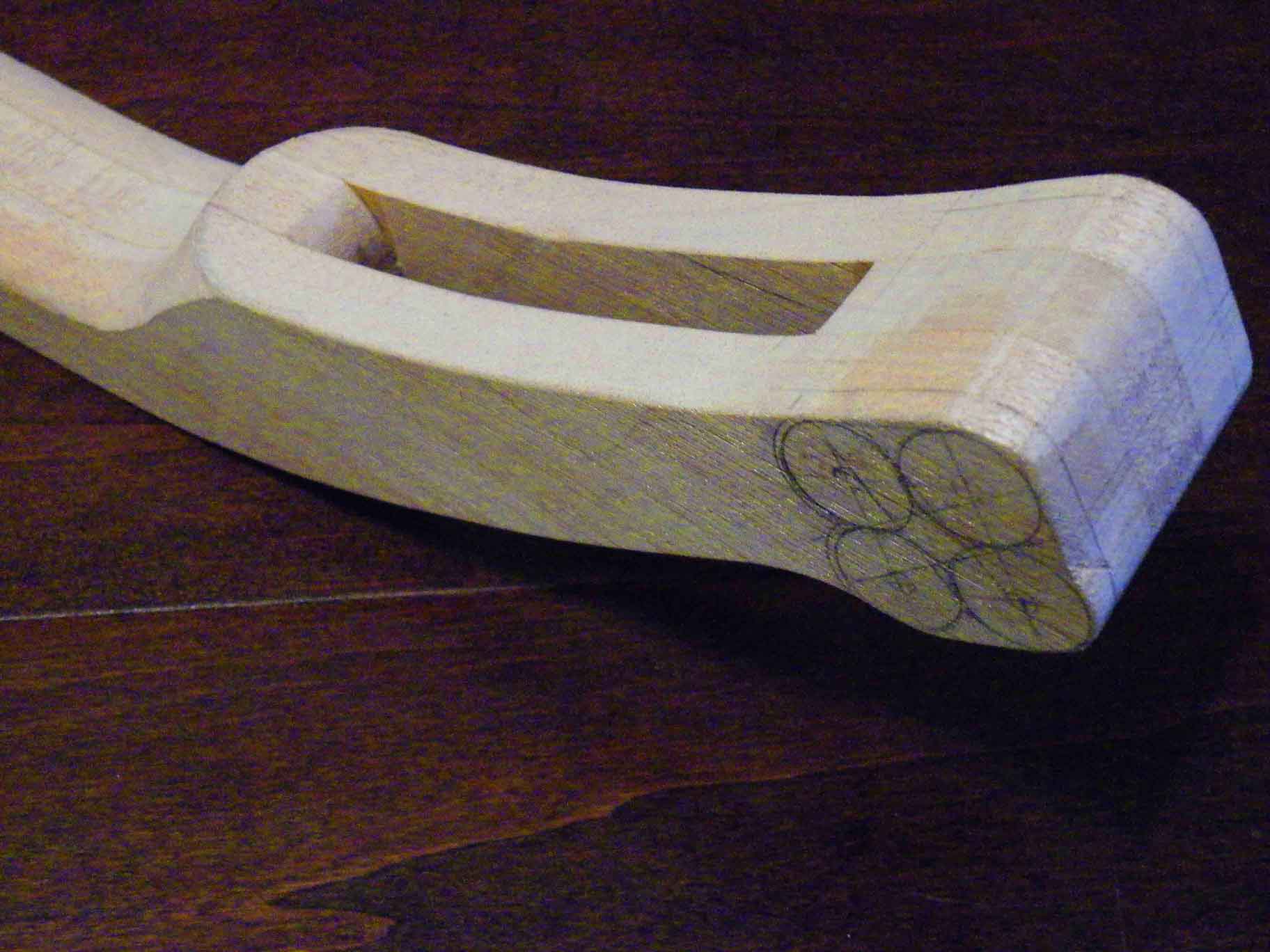

Thanks for the reply Bryan! My plan is to build the neck block around the heel of the neck, then build the body around the neck block. My plan is to secure the neck with a tight fitting hardwood dowel.

You have already established your neck angle by cutting the heel of the neck. Have you already planned for fingerboard height, bridge height and string height over the soundboard in your body design. Please don't take offense at these questions, I ask because you said you are not a luthier (neither am I) but I take that to mean you haven't made any instruments before. My advice is to take a step back from working on the neck and start drawing your designs out full scale from the side. There are a lot of factors that go into neck angle that are not inherently obvious the first time around. Drawing it out can show you some problems before you encounter them in 3D after spending a lot of time and materials. . .
A list of things to consider (probably not an inclusive list):
- is there going to be an arch or dome in the top?
- What will that do to the angle between the top and the sides of the body where the neck mates?
- How tall is the fingerboard (and frets if fretted)?
- How high does the string action need to be above the neck at the 12th fret (or middle of the string if not fretted)? This will probably be different for nylong strings than steel. . .
- How far above the soundboard do I want the strings at the saddle (eg. a steel string guitar is around 1/2")
- How tall does my bridge need to be to have sufficient break angle (an instrument with a tailpeice might need to be quite a bit taller than a bridge with strings attached)?
I mention these things because if you intend to make drastically different body types for the same neck you will need to figure out how to get the geometry right. Rather than adjusting the neck angle by fitting the heel, you could alter the angle between the soundboard and sides (where it joins the neck) but you will need to plan that out for each body.

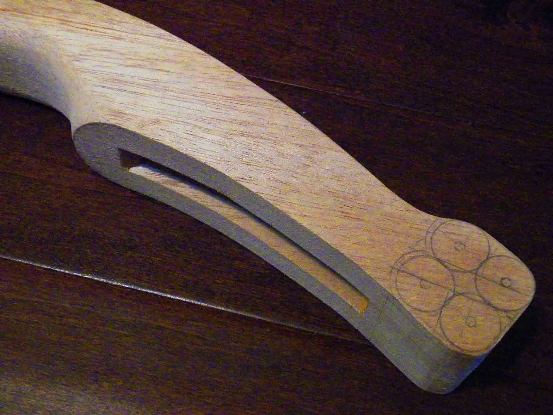

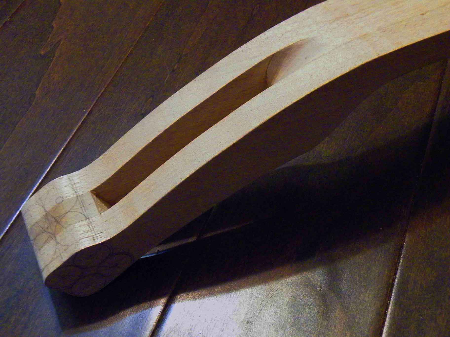

Thanks Bryan....that is great information! The soundboard will be flat, and made from poplar. The back will be the same material. I am planning on making the bridge a floating one, and the fingerboard about 1/4 inch thick. I am struggling with an alternative to installing typical frets. I have seen online people talking about "staple" frets made from heavy piano wire. I am also considering stacking metal or graphite plates with wood spacers between to achieve the fingerboard.

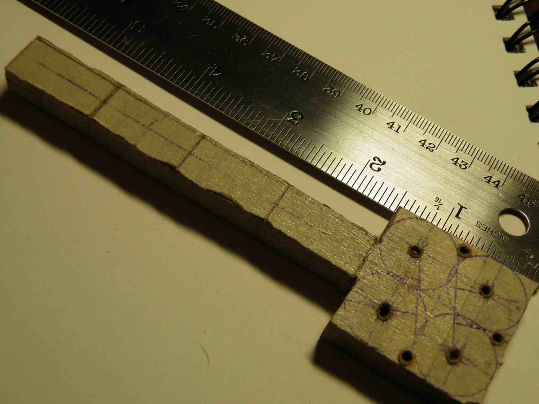

If I may offer a bit of advice. .
When I first started this as a hobby, I had no delusions that I was going to make "real" instruments. I was just playing around and having fun doing experimental stuff. As such, I spent a lot of time thinking of ways to design around various aspects of instrument making that intimidated me or seemed beyond my skills. As time went on, I began to take my projects more seriously. While I don't have delusions selling top of the line handmade guitars, I do strive to make nice (and yes "real") instruments. I have learned a lot of lessons since I made my first longneck dulcimer with no real plan beyond whatever step I was doing. One lesson I learned over and over again was that I would have been better off learning to do various steps in one of the "mainstream" ways instead of designing around it. I always ended up learning the technique anyway and I had piles of wasted time to show for it.
I mention this to encourage you to buy some actual fretwire. It is not expensive or hard to find. Your results will be better and probably cost you less in time and money in the long run. Do a little reading about fretwork now and start learning by doing. FIND Wfret HERE IN THE MIMF AND USE IT. to get started you don't need a fretting saw from the luthery supply places. I got my start using a cheap flush cut pull saw that cut a thin kerf; look around you will find a suitable one. Check harbor freight, they have a small Japanese flush cut saw that will probably work.
Wfret allows you to print out your fret locations on paper. I tape the template (after double checking for accuracy) down to the fretboard. Make sure you have one straight anD square side. I place a knife point into the fret line printed on the template and slide a square (referenced off the straight side) against the knife. I clamp the square down and hold the saw up to the square as a guide while I saw the slot. Doing it this way all the slots will be correct relative to each other as long as you do the process exactly the same for each slot. Any offset from the knife thickness and saw thickness will be the same each time. . . It is a bit tedious and every time I do it, I swear that the next time I am going to set up to do it on the table saw but I never do. . .
Hi Bryan, I am very much just having fun creating. Much like you mentioned, just being creative. I am really enjoying the process, and if something nice comes out in the end, great. .I am learning lots as I go, and I am sure I will make mistakes. I expect to learn from this piece, then apply what I have learned to the next one.

Bryan, I am having so much fun I can hardly stand it. Very similiar beginnings here I would say, as I had a hankering to get my carving chisels out and I picked tuning pegs as something decorative and simple to have fun with, with the thought that it may lead to a full instrument. I don't much money to spend on this project, so I am proceeding by picking wood that the local supplier has on sale. I picked up some poplar planks - 32" x 5.5" x 1/4" being sold at $1.49 each, so I bought half a dozen to try to create the soundboard. I have been reading about soundboards for the last hour, and nobody has said "don't use poplar" ...hahah. I am considering what you said about the frets and I should probably learn the right way.
Erm... don't use poplar for a soundboard.
Where you at on the planet? Find something in the softwoods section - spruce, pine, Doug fir, hemlock... - with narrow, vertical-ish grain and take it down to 1/8" for starters.
Get ye to the hardware section and find some "knock down" bolts for your neck swapping: 1/4" bolt with wide, flat hex heads, 1-1/2" to 2" long, screwed into an insert of some sort.
Listen to Master Bear and draw things full-scale, especially the side profile (that's called the "elevation," right?). Don't f@#k around with finding your neck angle!
Google "fretfind2d" and print out a fret template (select "actual size" when you print it out). You can incorporate this into your full-scale drawing, and print out an extra to glue onto your fretboard for a cutting template. This does not diminish your creative mojo, but confirms it. As much as you are enjoying "just creating" right now, there is a point at which time + effort = firewood will actually piss you off and discourage future creation.
Oh, and by the way... those Celtic knot peg grips are WAY cool. Do more stuff like that!

I forgot to comment on your dowel pinned neck joint. That sounds similar to what is recommended in Cumpiano and Natelson's book. It was proposed as a way of simplifying the neck joint for beginners. Cumpiano no longer recommends this joint. Google to find the barrel nut hardware neck joint he recommends now. This will be much easier for you to remove.

Hi Jason, thanks very much for your comments, much appreciated. I am hoping to add more "celtic" styled carving to this piece. I have drawn the similiar design on the headstock, and am planning on applying it to the bridge and tailpiece. Poplar....I bought it because I thought it was a distant cousin of spruce...shows what I know. I have read online where it's virtues are extolled in soundboards for dulcimers. I've read where it has been used on guitars but not favoured due to the greenish hue...I don't care about color really, as long as it does the job. The body will be independent of other parts, so if I don't like the tone at all, I can re-do it in another wood. Bryan, I thought up the dowel joint idea as an alternative to using metal hardware. I understand I may be shooting myself in the foot here, but I can't resist it. Old world craftsman used tight joints with hardwood dowel...worth a try I think. Alas, I am the newbie, I am expected to make mistakes. Bryan you are too kind to offer me your fret wire, but I don't you to be out of pocket. I am going to learn how to install proper frets....but I am also looking at alternatives. I was reading last night that in the renaissance, frets were tied around the neck with cat gut? Apparently, this is still widely practiced today. I am interested in a method that will be strong and unobtrusive, so, I will only be tying around the fingerboard if I decide to go that route. I am considering brushing on an epoxy over the tied frets or some type of rock hard resin.
