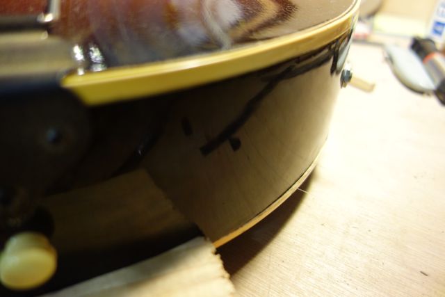

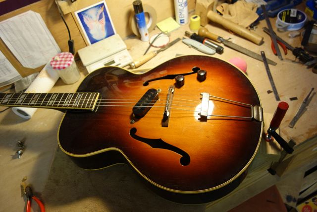

Hi folks,
I'm back with an old es300 Gibson that's have a bumped side on the lower bout close to the tail bloc. Not difficult to fix on a flat-top but on this old archtop with almost no entrance excepted F-holes and/or pickup. I've tried with a wood large wood shim in shape to push the side with a stick trough the F hole without success and another one with a smaller wood shim in shape strapped with nylon wire drawn from the outside.
before removing the back, have you any other ideas?
thanks in advance,
C.
thanks in advance,
C.

Fortunately the guitar is a sunburst finish. It is difficult to see from your photos what I need to see. Better camera angles and better lighting might help.

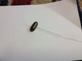

Make a fitted caul for the inside of the guitar. Feed an unwound guitar string through a hole over the open seam to the pick up cavity. Feed the string through the caul and affix it with a gizmo like this. Pull the bout into position, glue and clamp.
The gizmo is a piece of internally thread brass tubing with set screws on both sides. It is a bit of nostalgia from Rotosound super wound bass strings.

I am back !
first during my inspection of this big baby, I was stunned to see how those guys in gibson build this ES300. it seems to be a Super 400 to which it is cut a pickup hole. they had cut thru the bracing !!!
back to the repair:
First thanks to this pickup hole
I decided to use this inner system pushing rod
with exterior shims (with cork protection) on each side to prevent deformations of the sides
Unfortunatly, the pickup hole was not big enought to put enought tension on the inner rod with my fingers.
I deceided to use standard nut and washer like this:
and it was much better.
after that I used wood cams to glue in place the side with Hot Hide glue.
The result is perfect
I had to replace a piece of kerfing that I shaped and tinted with some tea (earl gray
) and I put it in place with a violin tool and hot hide glue. I maintained presure with my hand on the tool.
even if it seems clearer, the kerfing has the same color (thanks to the lightning)
working inside this guitar was not easy but much thanks to this pickup hole as small as it is.
This guitar sound prety nice in acoustic even with those cut braces! the pickup position gives it lots of trebles and attack but thanks to the tone pot that smouth all this agressivity.
Nice experience.

Unfortunatly, the customer picked up his baby just after the repair was done...
I had to scape a bit of the binding (say 0,05") to make it flush. I used stewmac color tone and some nitrocellulose varnish to match the yellowish color of the binding.
Fixture could not be bigger in any way, it was roughly made with the band saw to fit the guitar
