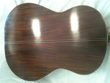

Here's the back. Indian Rosewood.
Finished back.JPG (22.22 KiB) Viewed 25136 times

That jig is super cool. Im looking at the pic of the back. Based on the lighting, I have a question: Does the back have a slight concave depression in the waist when viewed from the tail to the heel? This has plagued me in my own work. The concave board I use to press my braces is probably more extreme than most, so the sides need to be trimmed to accomodate this "bowl" before the kerfs are in place. The waist is always a little higher than the upper and lower bouts because it's closer to the center of the dome. Not an easy thing to work out. If this is what's up with the double reflection in the pic, I think I have a reasonably effective solution. If I'm wrong, and please tell me so., but why are there two reflections?

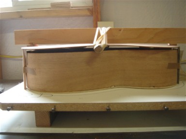

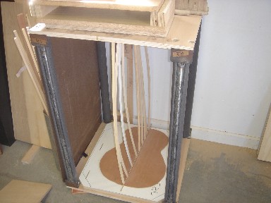

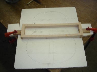

Erik Hokanson wrote:Ron,
-Hoke
Erik: No, the back doesn't have a concave depression. When I took the picture, the guitar was sitting on the floor underneath two closely located florescent lights in my trailer.
When I made the braces for the back, I curved them according to the plans; carved out the curve in a piece of MDF; placed the back on this MDF and; used a go-bar box to hold the braces in place while the glue dried. I've attached a picture of the sled I used for carving the crosswise curve, also the go-bar box that I used to glue down the braces. I also attached the setup I used to establish the lengthwise curve in the back. While I had this curved back in place, I marked this curve on the sides and shaped them with a chisel. Following this shaping, I used a curved sanding stick (I think I used a 15' curve to shape it) that spanned the back from end-to-end. I completed the shaping of the sides by sanding with 80-grit sandpaper attached to this elongated sanding stick. I attached a picture of the sanding stick. It's a little worse for wear.
