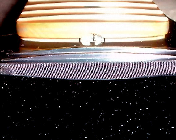

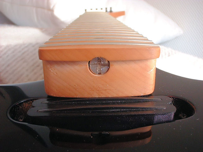

this is the neck of my esp custom made build 1987 :mrgreen:
when the neck is in place of the body, you only can see the half of the neck screw
is it necessary to loosen all 4 screws of the necks attachment to adjust the neck?? :?: :?:

The answer to your question is is: Yes! Sadly, you have to completly remove the neck to have access to the rod.
To lessen the frustration I suggest you loosen the strings till slack, attach a capo at the first fret (to keep the string from popping off the tuners) detach the neck and make your adjustment. It'll speed things up a bit and expect to repeat a few times till you get the right setting.
On some guitars you can notch the pickguard with a half-circle to expose the lower-half of the nut. This would allow you to adjust with out taking the neck off.
