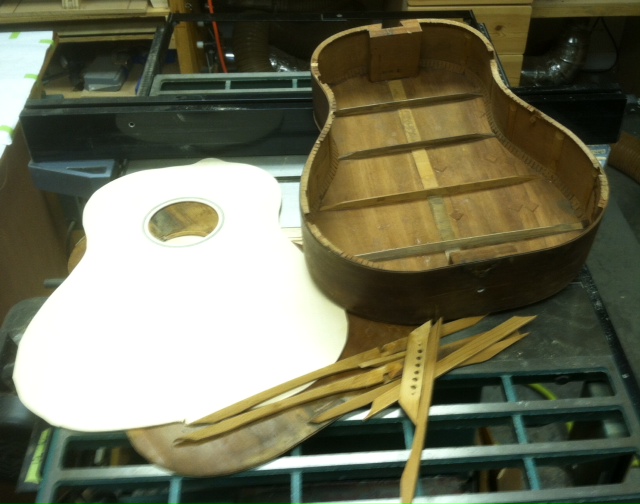

I am working on a '49 Gibson J45 that has been well thrashed. The goal is to turn it back into a player, not restore it - it was just too crunched up. Anyway, the guitar is getting a new top, unfortunately, and I'm not real happy about the glaring white color of the spruce. My question is: can I treat it with potassium permanganate to age the top? I've used it successfully on replacement braces and such but have never tried on such a large area. My tests on scrap are encouraging but not conclusive. Hopefully one of you has been down this road and can provide some insight. Thanks.

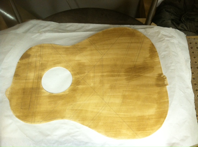

Finally some photos of some tests with the potassium permanganate. First shot is with a brush and it's just not a viable method for application for large areas, in my opinion. Second shot is sprayed on with my old detail spray gun. Potassium Permanganate is the same mix in both photos, mix is a medium purple - probably about 1 teaspoon of powder to 1/2 quart distilled water. Sprayed in one application.
Recall that this is is a chemical reaction with the wood, and it's pretty obvious where I tried to darken some light areas and that turned out way too dark.

Spraying this on was much like spraying tinted lacquer, pretty easy to control the shading and I like how even it came out. Before spraying it looked like the top next to it.
