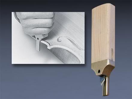

William Begg
Posts: 4
Joined: Sat May 26, 2012 12:47 pm
Re: Binding without a router
Post by William Begg »
Like this.

Greg Robinson
Posts: 686
Post by Greg Robinson »
William, sorry, did you take that photo? We ask that you only post photos here that you are the creator of to avoid copyright infringement. I've hidden it temporarily until you respond. Thanks.
