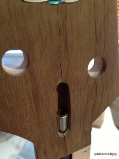

Ive been working on a build for awhile and had put it aside. I went to work on it again and dicovered a crack in the veneer from the truss rod access hole up to an inlay id put in.
Any advice on covering this up?

Here is a picture. After I glued the veneer on the headstock, I planed an angle where it met the fingerboard. It turned out nice until I made the access hole to adjust the truss rod. A very fine crack appeared. It gets quiet hot in my workshop and the heat has made the crack longer and wider.
Sorry, can't post a picture. It keeps saying the files too big!
Very frustrating.
Very frustrating.

- Attachments
- Cracked headstock veneer
- image.jpg (25.18 KiB) Viewed 8642 times
- Posts: 1475
Re: Crack in headstock veneer
That appears to have shrunk, was most probably higher moisture content in the wood than advisable. If you have more of that wood you can inlay a small strip in the crack area. I know it's fiddly and time consuming but it can camouflage the crack if done cleanly.

I do have more of the same wood and don't mind the tricky fix. Do you think I could carefully route along the crack to make in laying easier or would that be fraught with danger?
- Posts: 246
Looks like most of it would be hidden by the truss rod cover. Filling with matching wood would work but if you are going to route a channel then I would think about using it to advantage and make it look like part of your design as a center stripe. Maybe use black/white/black strips with a piece of your original wood sandwiched between. Just stop well short of your inlay when routing and you should be okay, I feel.

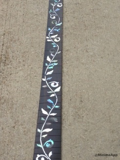

Thanks Warren. Here's a picture of the headstock and the fingerboard. I was thinking about continuing the vine inlay onto the headstock to cover the crack perhaps.
