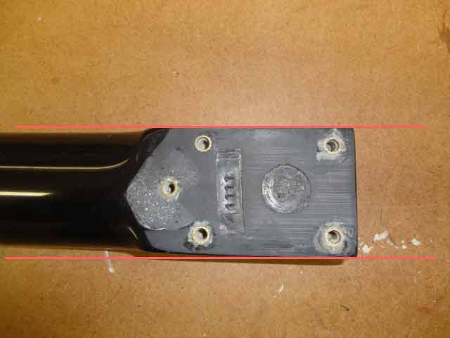

The neck heel has a compound bevel profile, tapering from the fingerboard face down to the back by around seven degrees. This was done so the composite necks would pop out of the mold. The neck heel also tapers from the last fret heading up towards the nut, so the whole neck pocket is an assembly of beveled faces. PITA! Here's a shot of the neck heel against a square to illustrate:

Are the sides of the heel symmetrical to the neck's axis on each side? I know there's a taper, but is it the same on each side? If not, your neck pocket could be correct, and it's the neck that's off. Of course, there's still the top to bottom taper to deal with.

The neck does taper symetrically with respect to centerline, so that's one less problem. They were made by the thousands in CNC cut molds, so they are pretty consistent. Using the Steinberger neck and tuners is the whole point of the project, so i'd really like to solve this. It's the thinnest bass neck I've ever seen, tapering to about 1.5"at the nut, very comfortable for small hands like mine. There are no dead spots in the fingerboard, and it's nearly impervious to changes in heat or humidity, so I'm not ready to scrap this just yet. I will have to chisel out the bottom of the wood patches at the bottom of the pattern bit travel. My current dilemma is due to my shortcomings in template making, so I think a jig that directly translates the neck taper onto the body is my best bet. Thanks for the input.
