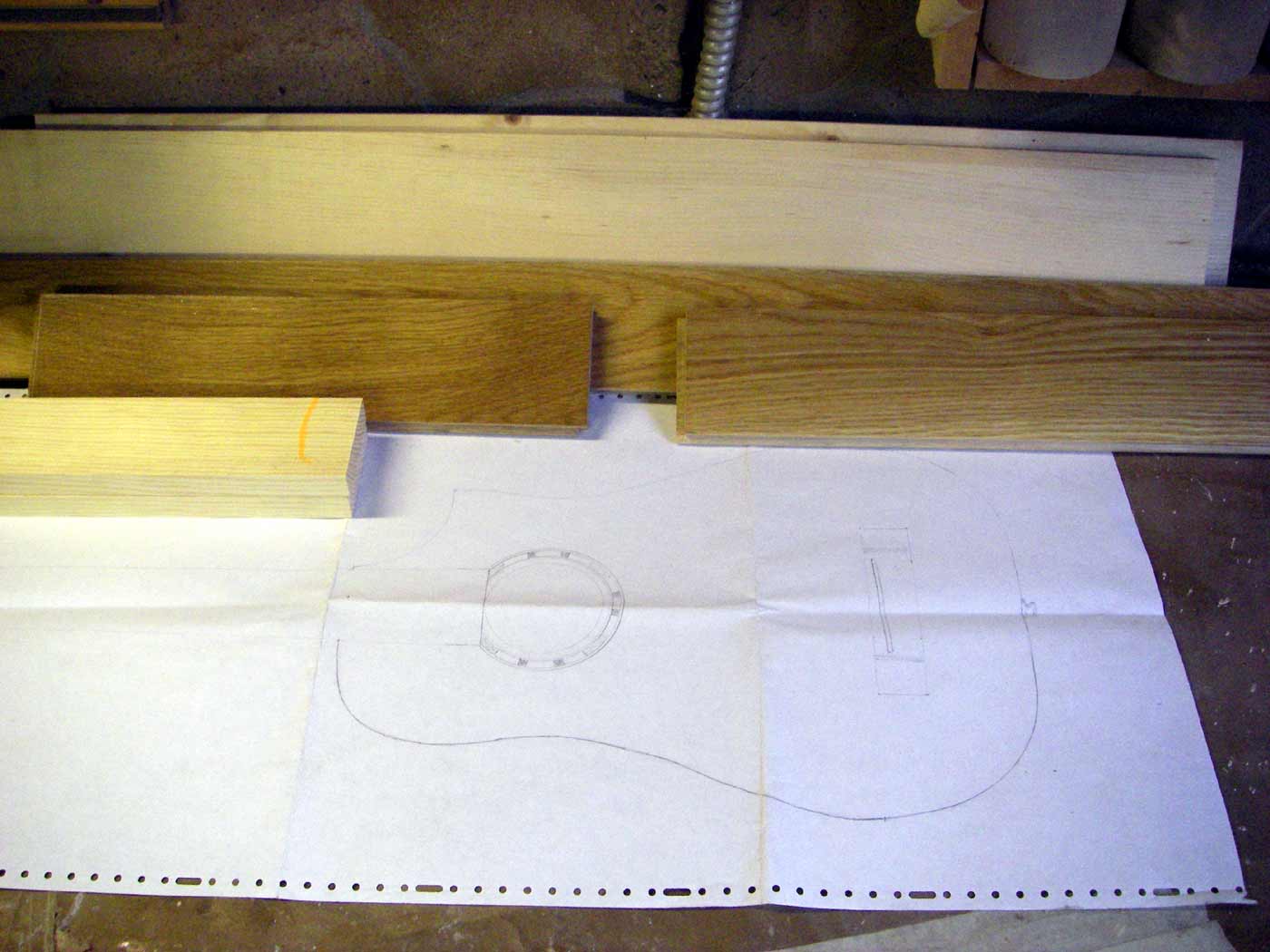

I'm in with two projects. This one is a travel guitar. I am going to use some oak flooring I have left over from 4 years ago, and some pine I pulled out of the trash at work. The carpenters at work toss out cutoffs of pine every day. I pulled three pieces out that are very tight grained, and almost quartersawn. I am going to try to use them as a soundboard.

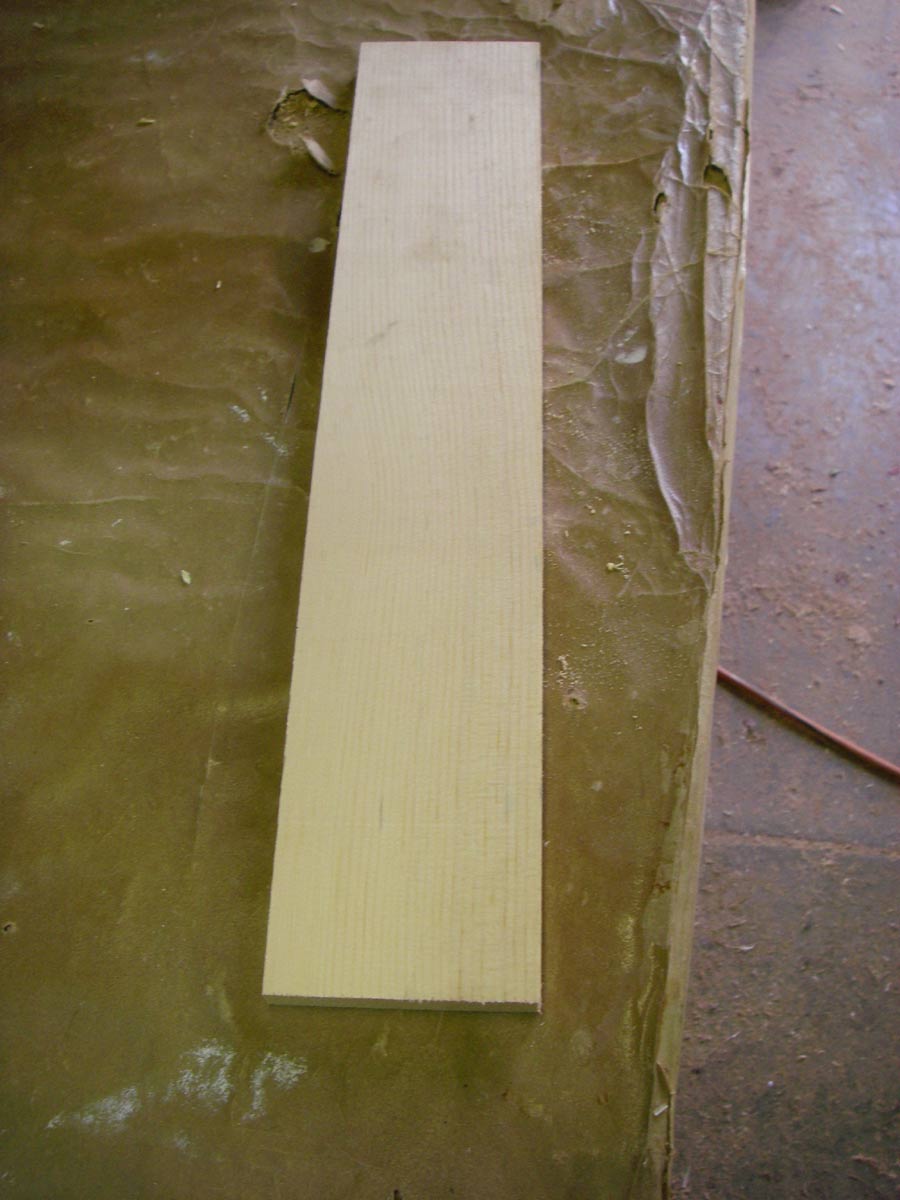

Post by Patrick DeGreve »

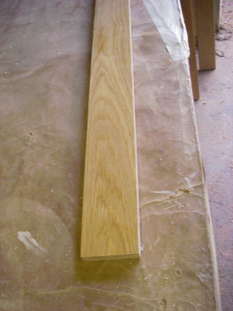

The first step in this project is to trim off the tongue and grove from a piece of oak flooring that is close to quarter sawn.

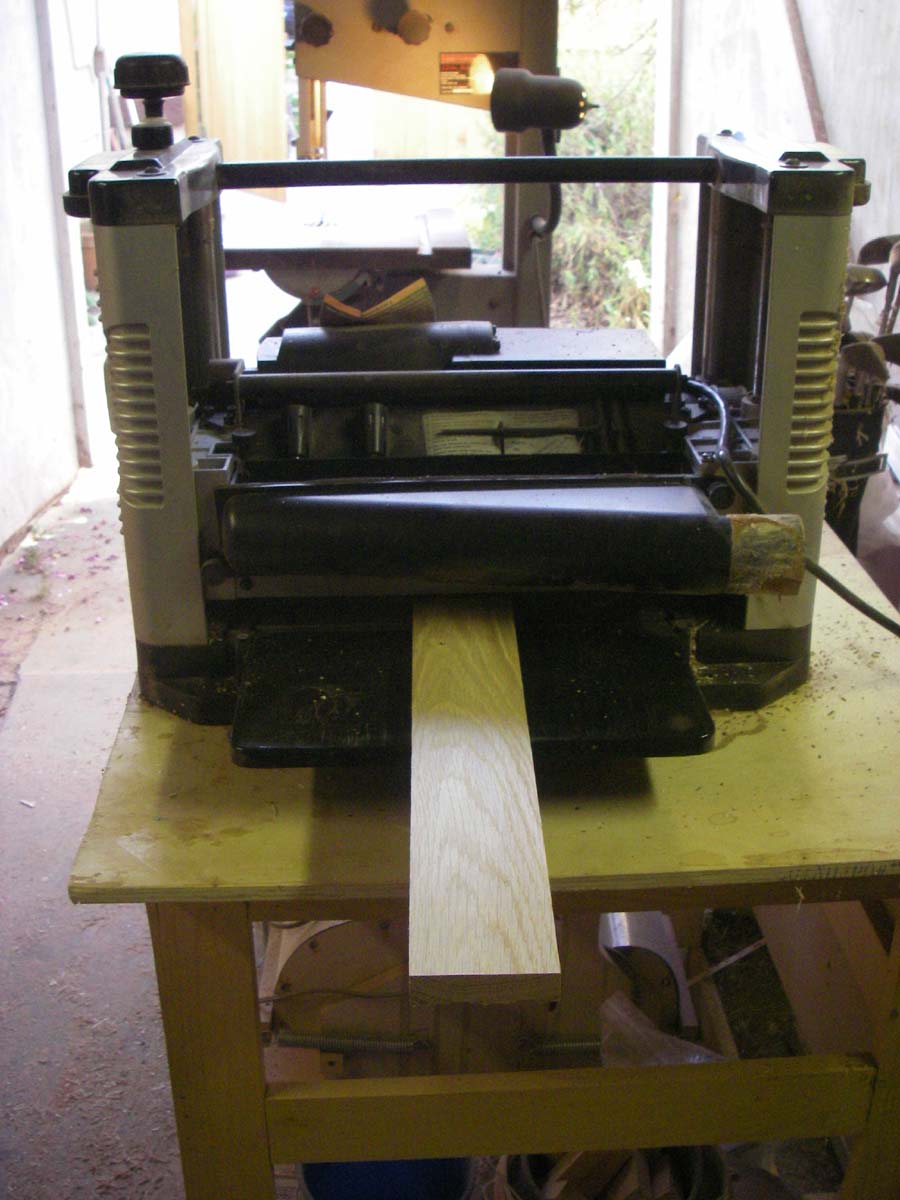

Because the flooring is pre-finished, I ran it through the planer to remove the finish.

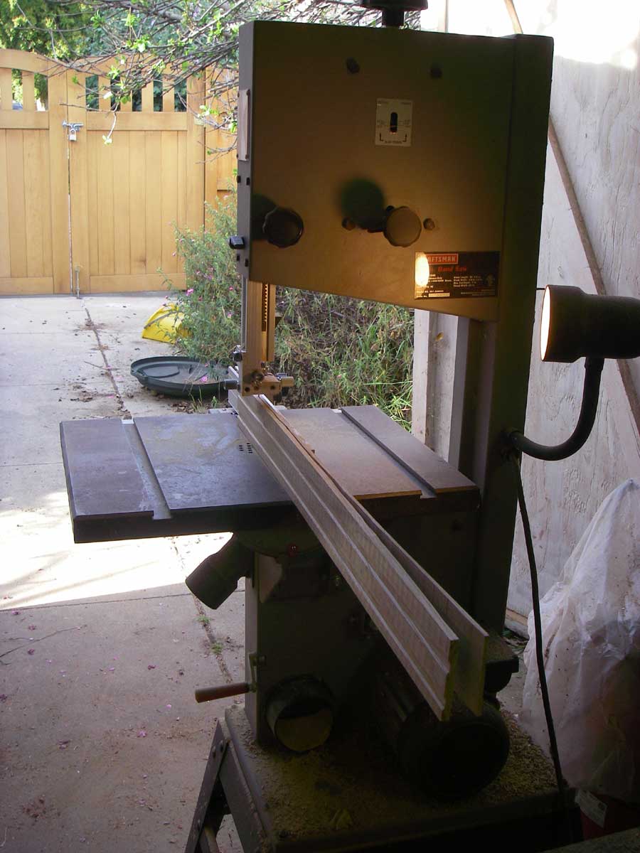

I next cut two 1/8" thick pieces on my band saw for the sides.

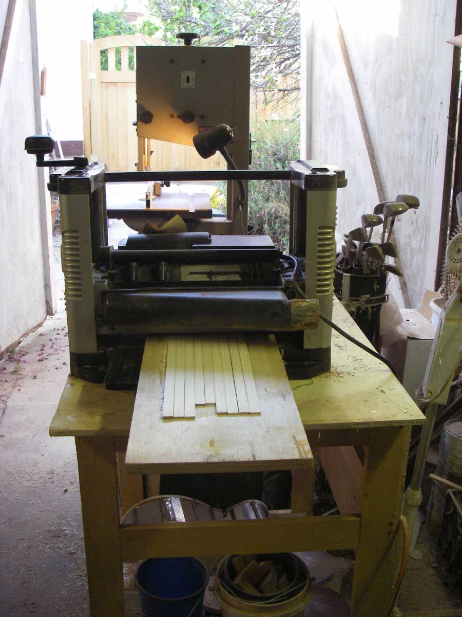

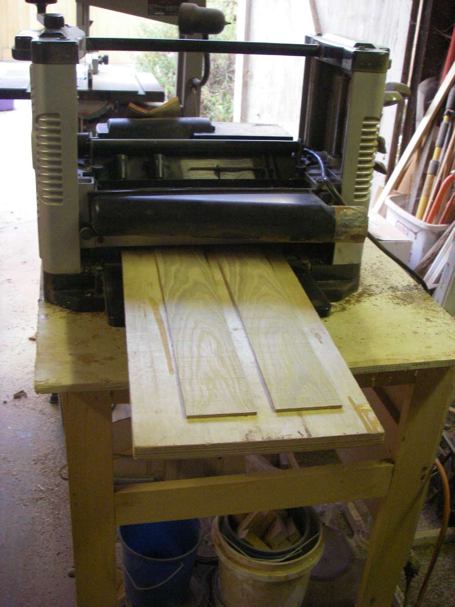

I taped the side pieces to a piece of 3/4" plywood and ran them through the planer. I planed them to .090 inch.

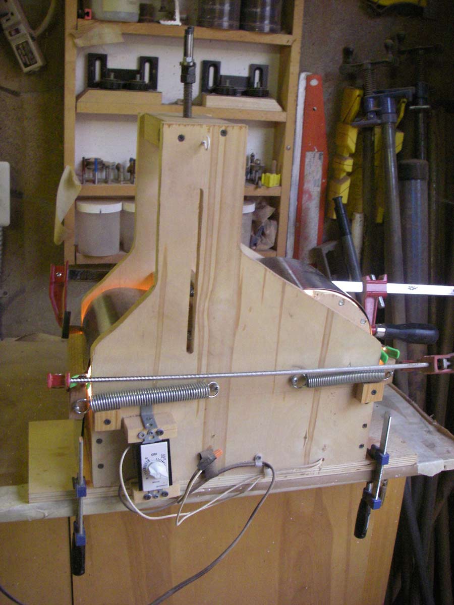

Next I bent one of the sides on my Fox style bending machine. I will bend the other side tomorrow.

Today I bent the other side. Then I ripped down a piece of pine to 5/8", and then ripped that down to 1/8" strips. I will use these as lining. I taped them to a piece of plywood and ran them through the planer. Tomorrow I will bend them in the Fox bender.

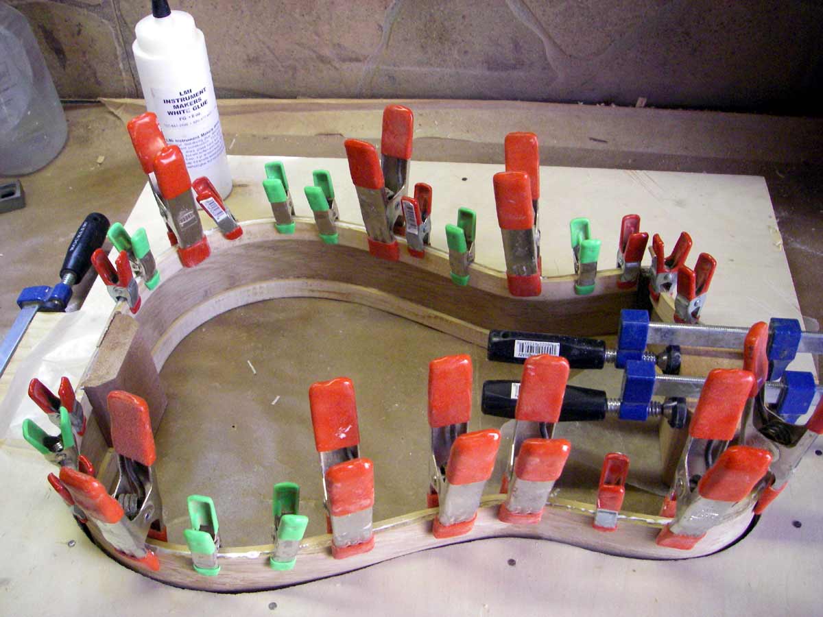

I had a busy weekend, but I still got quite a bit done. I made end blocks for the neck joint and the heel from a piece of the mahogany I am using for my other project, and glued them in place. Then I cut and glued in place the linings.
Now for the pine soundboard. I am using a piece of pine that is almost true quarter sawn. I riped a piece of pine to 3.5", then sliced it into four pieces. I thicknessed them to .140 thick in the planer.

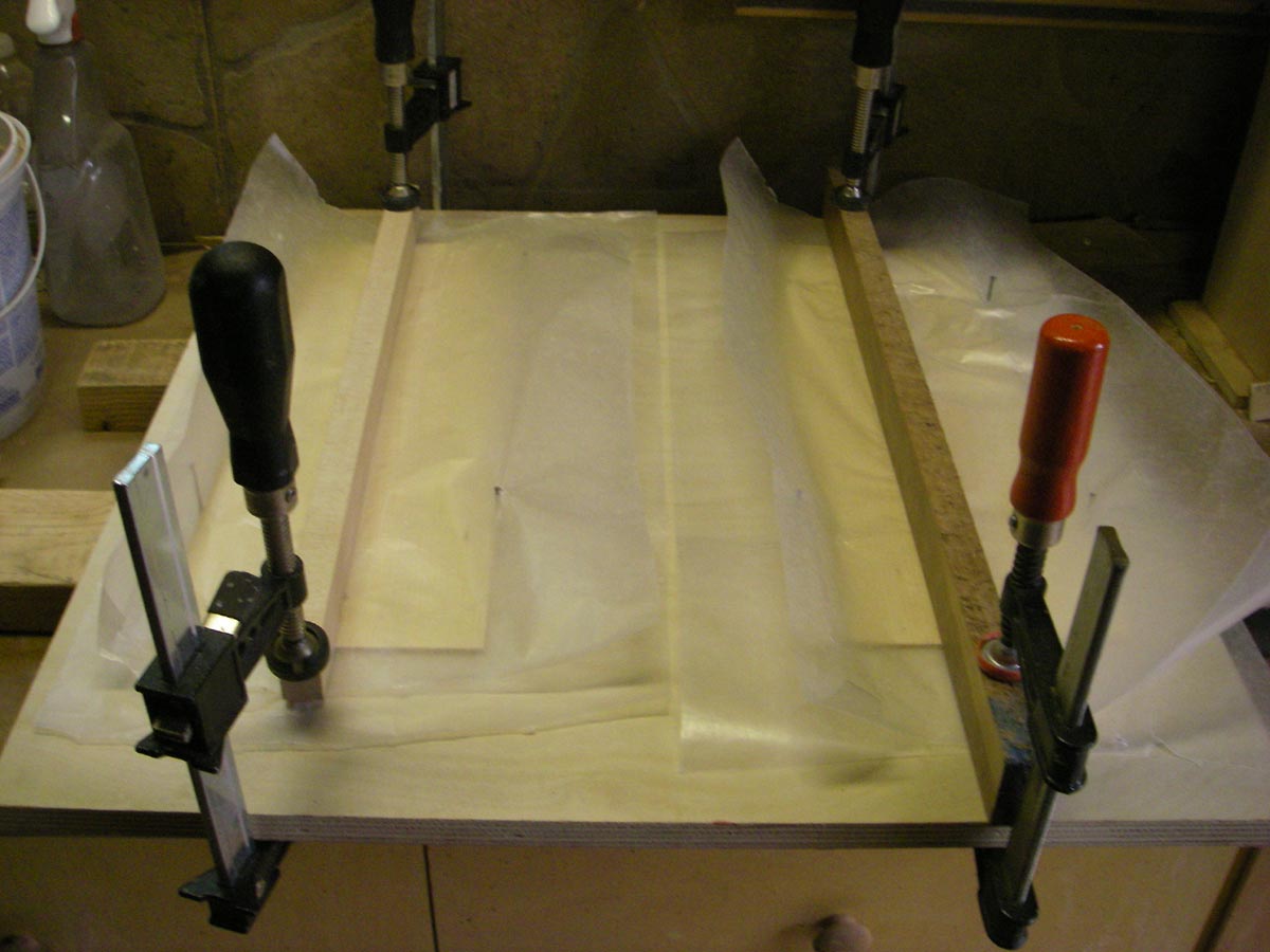

I glued the four pieces together in two steps. First gluing the sides together in pairs. Then gluing the pairs together to form the complete soundboard.
Here are the four pieces glued together to make a complete top.

Great progress, Patrick. What type of pine are you using? I've not always had good luck sending thin wood through the planer but looks like it worked well for you. Taping it down might be the key...I used a sled with a stop on the rear side.
Patrick DeGreve
Posts: 308
Re: Patrick DeGreve's travel guitar
Hi Warren; I am not sure what type of pine I have here. I asked the carpenters, and they just said "clear" pine. It is very good quality pine compared to what you get at a Home Depot. It is straight grained, usually fairly tight, with very few knots. It almost never has any cupping or twist. I use clear doouble faced tape to tape the pieces down to my 3/4" plywood "sled". Sometimes 1" sometimes 2" tape, run the whole distance of the piece. This seems to work very well. I plane the pieces in VERY SMALL incriments, running it through 20 to 30 times if needed. If you try to take too much off at a time the wood can split or shatter.
