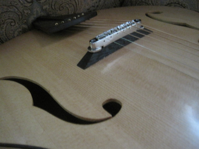

I fit my second archtop with an adjustable bridge (abr-1 and a wenge base), after being dissatisfied with the sound of a completely wood bridge. The sound quality became much better---more articulate, better sustain---but a touch metallic sounding.
But I've always had tuning stability issues with this guitar. I couldn't get it to stay in tune for any length of time.
I don't think it was string slippage at the tuning post, as I lock the string under the windings when I restring. Not the tuners (Grover Sta-tites). Not the adjustable part of the bridge, as the abr-1 was as low as it could go and was resting directly on the base.

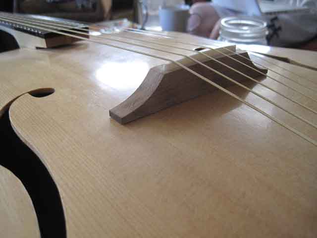

Anyway, I made a new, nonadjustable bridge (white oak base, bone saddle) and set it up last night. Not only does it sound great, the tuning problems are gone.
Does anyone have an explanation?
I'm including a before and after shot below.
After: white oak base and bone saddle
Before: abr-1 bridge and wenge base

A wood and bone bridge will always make a big difference in tone as compared to a bridge with that much metal in it. That's a given, the ABR-1 is quite massive. As to tuning, who knows- but you replaced the bridge and it was better, so that to me points to some instability somewhere in that metal bridge.

Yes, that's the only thing I can figure too, although how exactly the abr-1 was contributing to the problem is beyond me.
In any event, the wood/bone bridge has a warmer tone than the abr-1 did, so there's a plus as well.

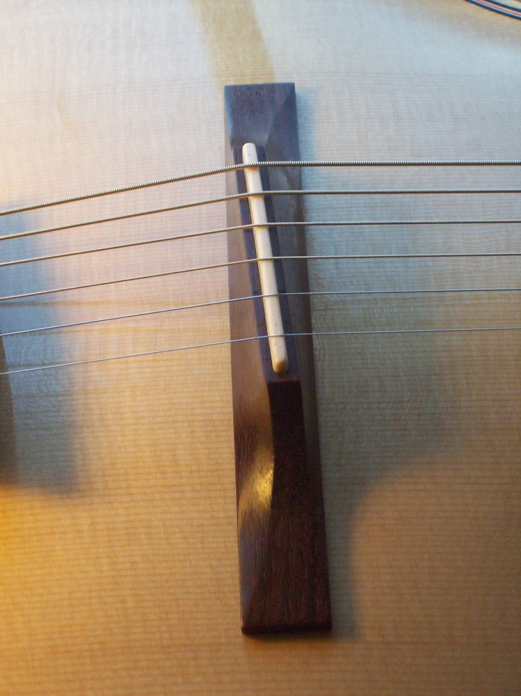

Dennis, fwiw I put a non-adjustable rosewood bridge with bone saddle on a current build I'm working on and was also very happy at how great it sounded. I'd avoided bone 'till now for fear it might become too treble balanced, but that didn't happen. I shaped & hollowed it some to get the weight down (27g total).
Dave

Like everything you do, that looks great. At this point mine's just a trial, so I didn't do anything fancy with it. It's just a 1/2" thick piece of white oak, 5" long by 7/8" high. The 1/2" thickness is just enough to accommodate the 4.5 degree saddle slot, but that obviously leaves a chunk of unnecessary real estate in front of the saddle on the bass side, and below the saddle on the treble side.
The curves you used solve that problem nicely.

I just swapped out the white oak base pictured above with spruce. Same shape and dimensions. 11g in weight, and it is again a noticeable improvement. Not sure what the negatives would be w/respect to using spruce, but for now I'm liking the difference.
