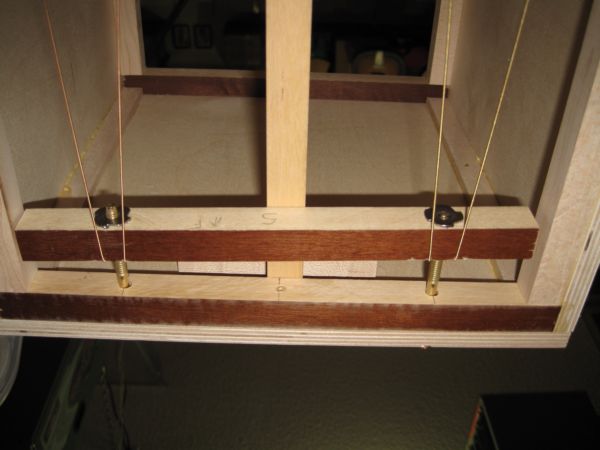

Mark, I also have some pictures of how I attached the snares on one I built a few years ago. I based it on ones I looked at down at the local music store. I'll dig them up tonight and post. The Lee Valley article is definitely different from any I've seen. Any I've seen use guitar strings for the snare and not actual drum snare wires. Totally different configuration. Interesting.

I'd like to see how you did it Darrel. This article shows the way that is closest to the way I've seen it done in the store-made ones around here.

Mark, I don't know if you are considering this when planning on installing the snares, but do you want different zones in the cajon or not? Some designs have the entire cajon live with snares while others have distinct snare zones. My wife has the Peruvian made Gon Bop Alex Acuna model and the snares are on a diagonal pattern on the top two corners--thus only the top two corners on the tapa will buzz.
So there is no need for a throw off because you can control the buzz by where you play.

I play the top of the face on this one for almost no snare effect. The closer to center, the more bass and snare. I've seen a lot of players use this type. They play the 1/2" plywood sides as well as the front. Wish I could play like some of the guys I've seen.
