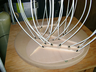

1. General comment. I have found that the go-bars have a mind of their own at times and act like a coiled up snake ready to strike.

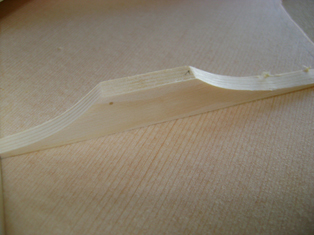

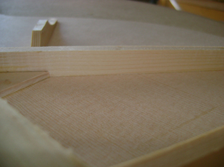

3. The pictures attached show a traditional L-00 bracing pattern. Any comments? Things to look for or avoid? The next top will be for a gypsy guitar and the bracing is really completely different.

The go bars need to be shortened. They behave better when you don't have to flex them so much. Can't tell from your photo about top wood. Can you take a close up photo?

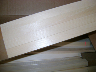

Here is a pic of the brace wood. I got a box of it off of Ebay from Hippner Guitars and I am not implying anything here. I just don't know well enough to determine pine from spruce but I have done household woodworking and this sure feels and looks like pine.

Looks like spruce to me.
Spruce and pine smell very different. Pine smells like ... well ... pine.
Fir smells like cat pee.
And spruce has it own - very nice - fragrance.

The pictures aren't the best, but the grain orientation on your installed bracing looks like it's in a flatsawn rather than vertical position in the second picture? And yes, the bridge holes get drilled through the plate after the bridge is installed. The actual bridge holes are drilled before you install. At least that's how I do it.

DJ - Your go bar deck is too low. Not sure about others here but mine dont deflect more than 3 or 4 inches. They lose their clamping force as well when they are bent that much.

Nice work so far. Your bracing looks like spruce to me too as best as can be seen from a photo.
Definitely shorten the go-bars. It is a good exercise to put a small postal scale in your go-bar deck and see how much deflection is needed to get maximum down force. The deflection will be surprisingly small. Any additional deflection will simply be stored by the go-bar as potential energy that wants to release in the horizontal direction - turning your go-bars into little missiles, something you've already experienced ;)
