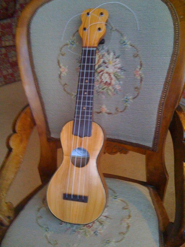

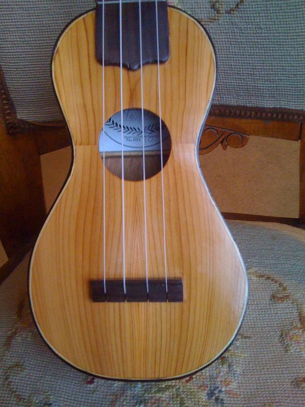

Here's a picture of the uke (pic of the faiure won't help as I noticed it was lifting just before I headed off to a uke festival so flooded hide glue underneath and clamped to keep it together for that weekend, thus hiding much of the evidence).
I think I'll go for option 2, and take the opportunity to refinish the top at the same time. This wasmy first attempt at a shellac finish and it's along way from what I can achieve a few builds later.
If the bridge goes again, then it's bye-bye rosewood for this one.

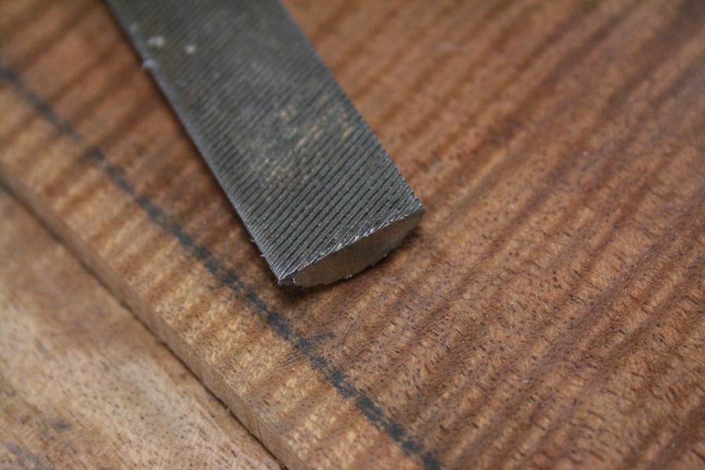

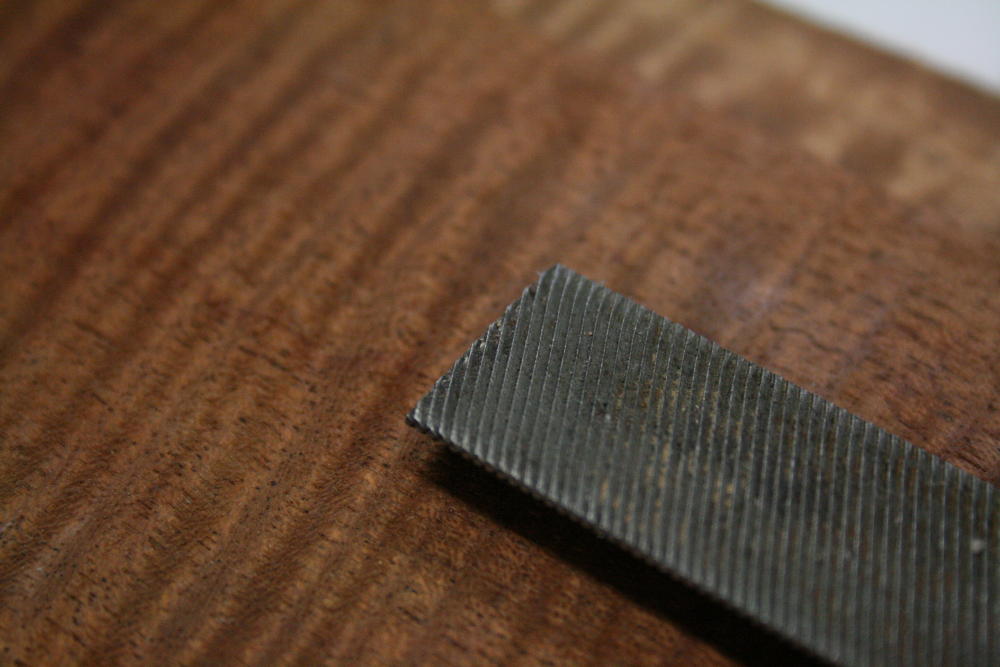

I ground the end of a single-cut file so that the teeth are exposed on the end, and use that. It's a bit more "tooth" than with 80 grit, but doesn't produce dust(and gluing dust to dust can't be good...). It's worked perfectly for me....
Can take photos if it isn't clear?
- Posts: 821
Re: Rosewood bridge and hide glue
The following advice is for epoxy-glued fretboards, NOT for bridges.
Here we go. I simply ground the end of the file flush, to expose the teeth. In use, I have to hold it at the angle of the teeth(more or less), and drag it lengthwise while applying downward pressure. How much pressure will depend on the wood and on how sharp your file is. I only make one "pass", then move it over, make another "pass", until I've toothed the entire width. I don't try for a cross hatch pattern. I'll tooth the neck surface exactly the same manner and direction, and will do this right before gluing, after the epoxy is actually mixed.
In the final photo, hopefully we can see the amount of "tooth" I cut into this ebony fretboard, and note how it produces clean shavings and little dust.
