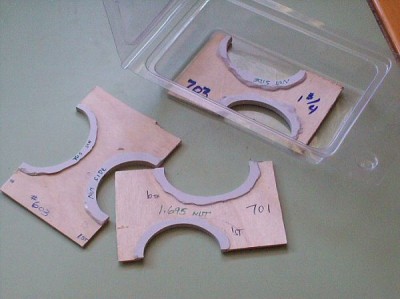

Freeman Keller wrote:It is pretty tricky to make a template off of an existing neck ....
I've made patterns of many of my necks, using 1/16"plywood & the epoxy stick (looks like blue & white hard candy...resin & hardener). Cut a rough profile in the ply for the location, about 3/16" too big all 'round. Cut some epoxy from the "stick", mix by hand, roll into a "noodle" & fit into the ply cutout. Press symetrically onto the neck (protected by cello-tape, foodwrap etc) 'till you have full contact, remove & let harden. Wick some CA in where epoxy joins ply. When dry, you can sand off much of the epoxy. Looks like this.
