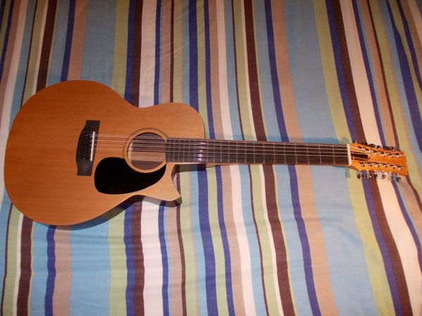

Soooo.....after all this time i'm finally done and marked! and i couldn't post pictures before now because it would be publishing images which is against the rules. But now i can! So here's the results. Bear in mind, i do realise there are many many things that could have been better, and would have been done much differently by a luthier, but for a first guitar, it plays, and sounds ok (intonation an incy bit sharp) :) :) so done with no afore knowledge, and just the opinions of my woodwork teacher, here it is. Feedback is appreciated :P
Freeman Keller
Posts: 506
Re: Yr 12 major project (12 string flattop acoustic)
Post by Freeman Keller »
Looks darn good to me - would love to see a few more pictures, including any of the bracing. Scale length, materials, finish, how are you stringing and tuning it? I think you can be very proud.
