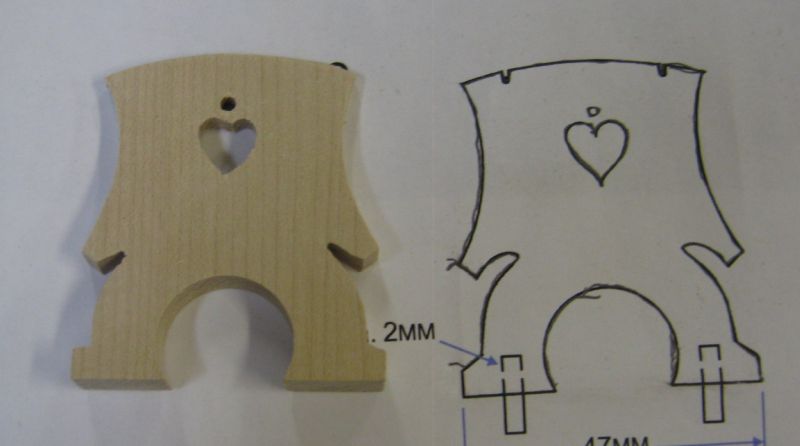

Well, I've been working on some of the little bits for a while. Here are the bridges for the melody and drone strings.
Melody strings bridge
Drone strings bridge

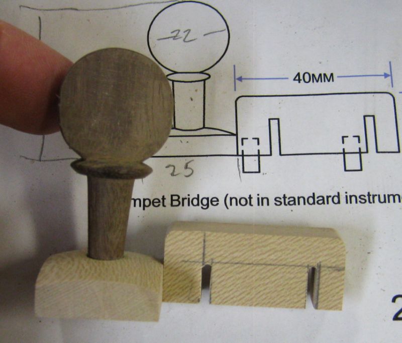

And the trumpet bridge holder.
Trumpet bridge holder

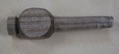

The main tuning pegs.
Tuning pegs
Tuning pegs

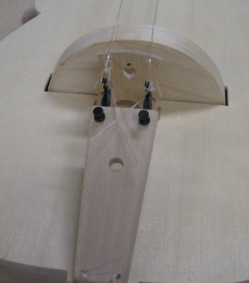

Also worked out the tailpiece. Here it is, temporarily in position. I've used viola fine tuners for the string holders.
Tailpiece
Tailpiece

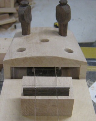

Next, worked on setting up the "nut".
Fitting the "nut"
Fitting the "nut"
You can probably see that some notching is needed to give the strings some room- this isn't shown on the plan but is in one of Wilfried's photos that I posted earlier. I put in some notches with a round rasp and then glued the separator on and drilled clearance holes for the strings.

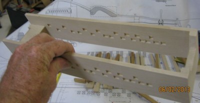

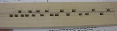

Worked on the keybox a little. Here I've marked out for the two rows of keys:
Key locations marked
The holes are nominally 8 mm x 6 mm. I used a 0.25" mortising bit (with the two sides taped together).
Mortised holes
Mortised holes
And then the buttons for the tangents to sit on, in place. Still need to add the buttons of course.

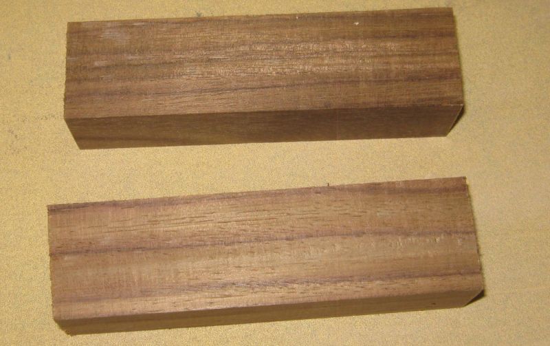

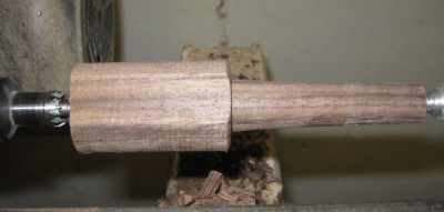

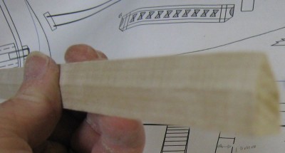

The pegs were turned on a lathe from rectangular (looking at it from the end) pieces.
Peg blanks
Peg blanks
Took me a couple tries to get it right. Here I've got the tapered part to the length I want it.
Tuning peg on lathe
Tuning peg on lathe
Then pretty much shaped.
Roughed out peg
Roughed out peg
Then I just smoothed things out. It was back and forth on the lathe 5-6 times to get the taper right.
Then to put the curve in the tops, I just took them to the spindle sander (2" diameter spindle) and sanded the curve in. For the smaller pegs (e.g. on the tail piece), I used a handsaw to get the flats and then some sandpaper wrapped around a dowel.
I wrapped a piece of sandpaper around the outside of the peg (sanding surface out) to get the matching taper in the headstock.
There are probably more efficient ways to make them- like maybe cutting the flats in before turning, etc.

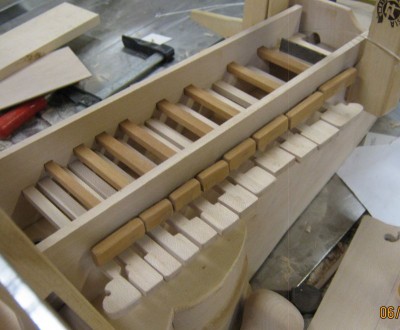

Here I've added the "buttons" to the ends of the keys.
Keys with "buttons"
Keys with "buttons"
And here's the keybox glued up and ready to glue to the instrument.
Keybox shell glued up and ready to glue to the rest of the instrument

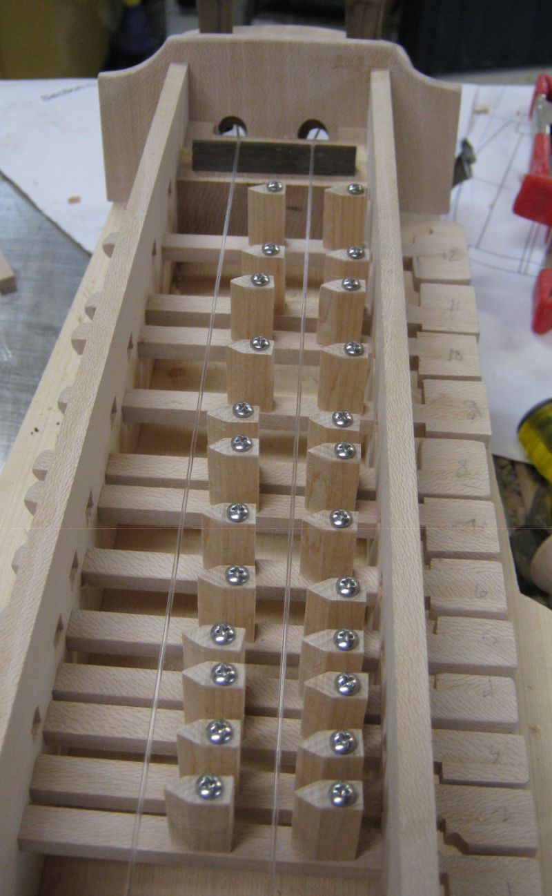

Here's the prepared tangent stock. Actually I redid this as I thought the taper was a little to shallow, but the idea was to get the shape on a long strip and then cut it into the individual tangents.
Tangent start
Tangent start
And the finished tangents (with mounting holes). The tangents for the bottom keys are about 7/8" high, the top keys, about 1/2" high.
Tangents
Tangents
Obviously not period construction here <g>

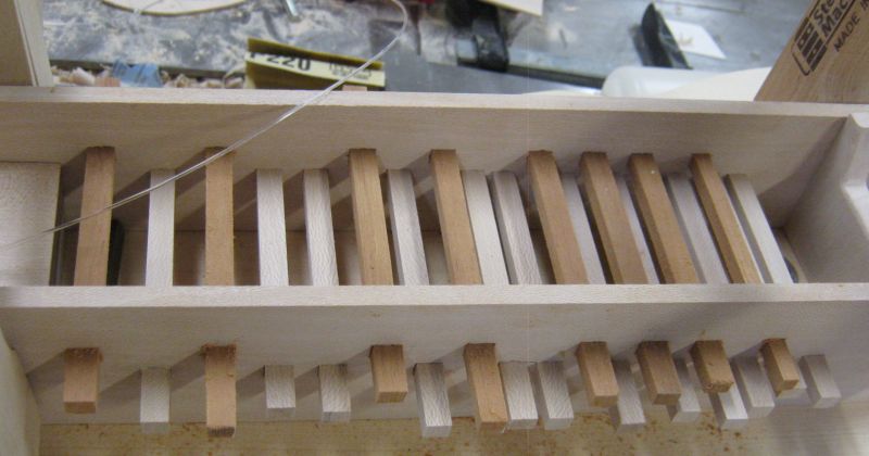

Bottom row of keys
Bottom row of keys
And with both sets.
Top row added
Top row added
Re: Building a hurdy-gurdy

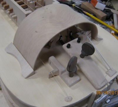

Time for another update...
Here's most of the bits (cover holder, bridges) in place on the top.
Various bits in place
Holes for the drone strings (similar hole for the trumpet on the other side).
At this point I had to string it up!
Testing!
Testing!
The vibrating strings have a surprisingly (to me) large arc! And I have to say it sounds a bit like a sick cow <g>.
There seem to be a couple common tunings- here's the one I'm starting with (C/G).
Tuning
Tuning

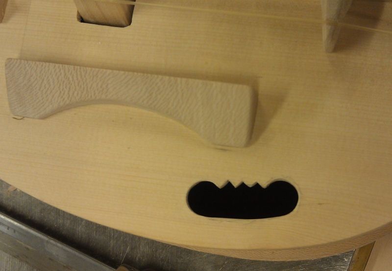

I managed to add the soundhole (per the plan)- it's not much to look at but the top of the instrument is pretty busy.
Soundhole
Soundhole

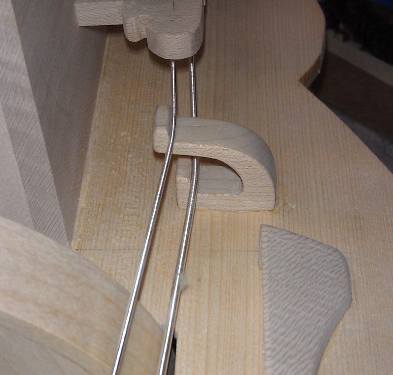

Next I made the string catches for the drones and trumpet.
Bridges
Bridges
And here they are in use:
