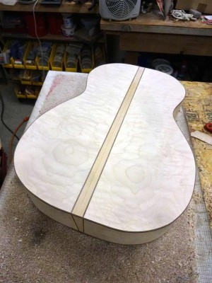

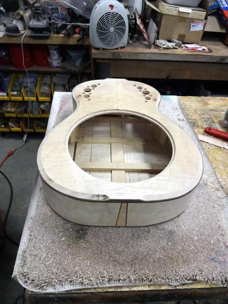

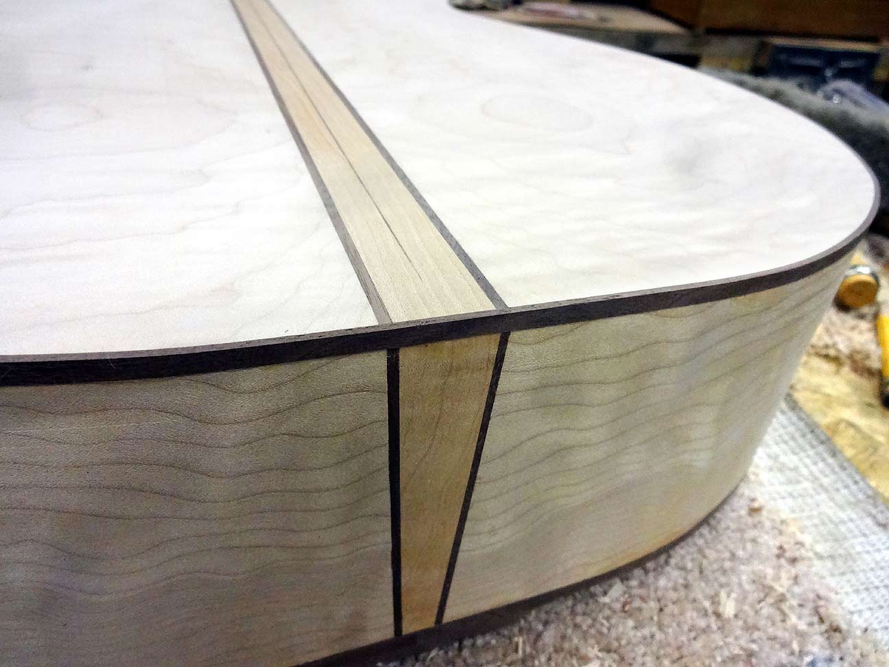

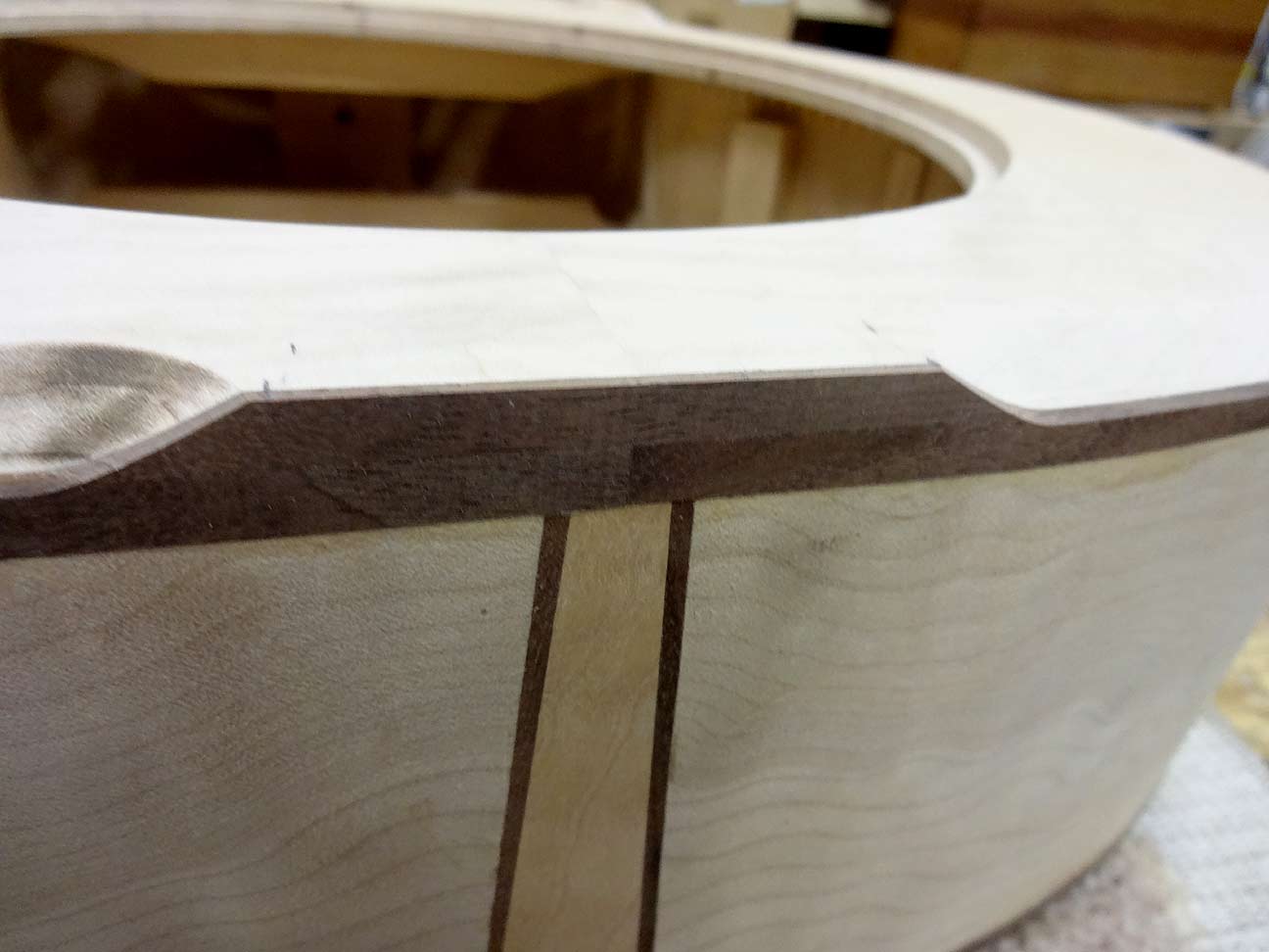

I trimmed up the bindings with the router, and cut a 30 degree angle on the top down to the binding.
So now it's just a matter of final sanding and (ugh!) applying finish.

Thanks for your input, Mike. I don't think the 30 degree bevel on the edge of the top will be a problem - I'll give it a slight (maybe 1/32") rounding at the top edge - it should definitely be better than the 90 degrees between the top and sides of a normal guitar, which doesn't seem to cause any problems.

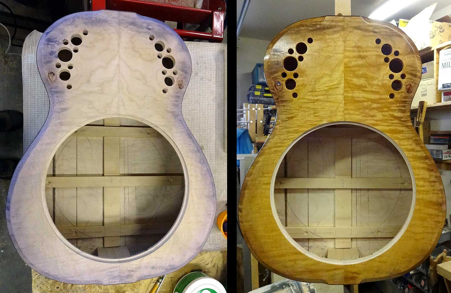

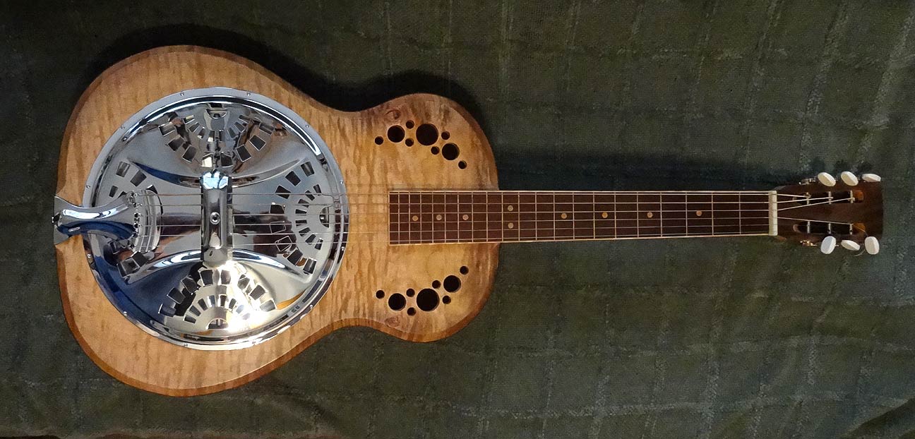

Final sanding done. I wanted to try a sort of burst, so I wiped on some dilute violet dye to the periphery, then sanded back a little to try to keep most of the dye in the dark figure. Over this I wiped on garnet shellac to turn the violet a warmish brown. I'm afraid it didn't work out too well, giving it a ragged look - oh well. The pic on the right is after several coats of brushed on (foam brush) General Finishes HPT gloss, which I'm trying for the first time. Weather is too crappy to spray outside - rain and 60mph winds. I'm going to give it about 8 coats over 3 days, hopefully thick enough to sand to flat and finish sand, and polish after a week or so.

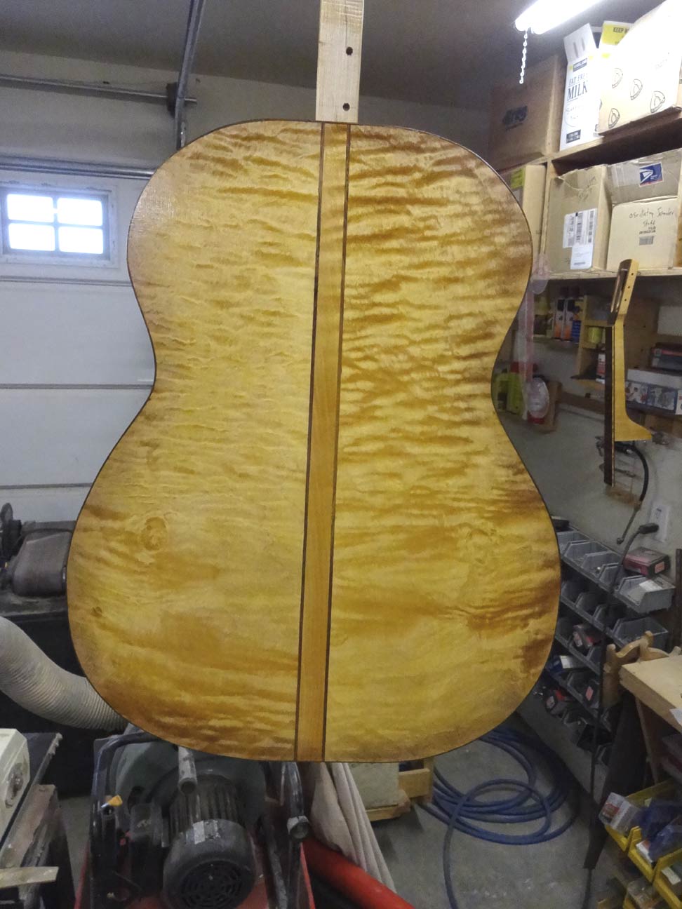

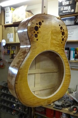

I've had trouble with this finish. Can't brush on a smooth layer without leaving brush marks, even though I'm using a foam brush. When the weather gets better maybe I'll try spraying it (on a different instrument.)
After 8 coats, when I sanded enough to get out the marks, I started to sand through, so put 4 more coats on the back. Since the wood figure looks old and grungy due to my attempt at a sunburst, I just sanded to 1200 grit and buffed, giving it an aged looking finish. These pics are prior to sanding. More later.

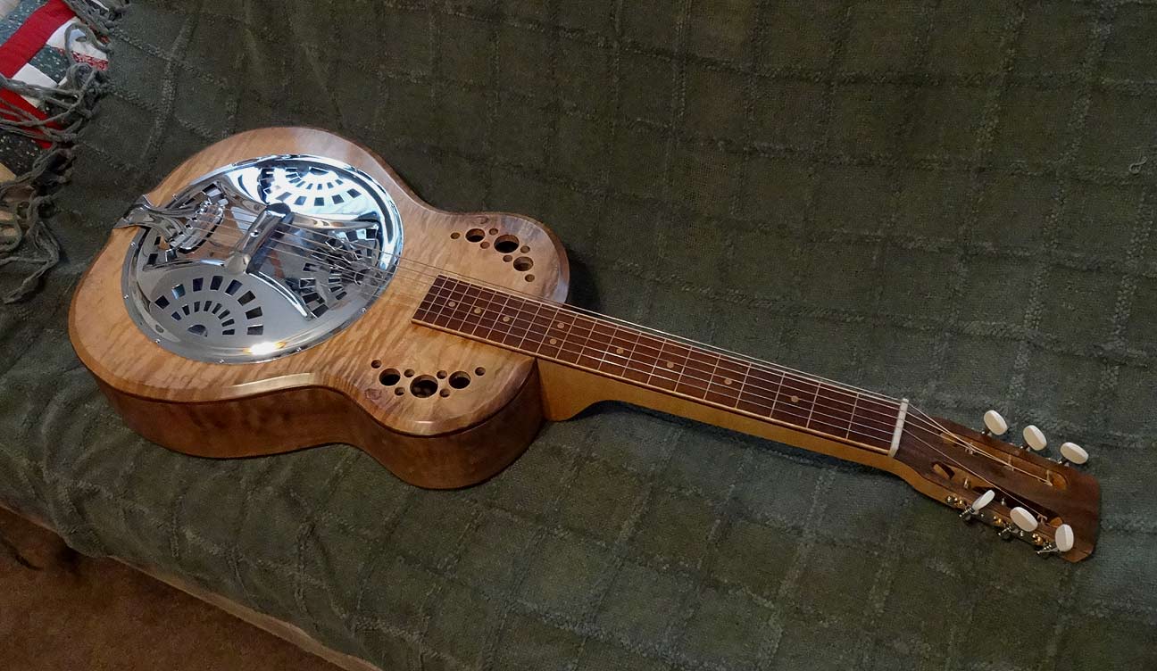

Made a bone nut and maple saddles. Put it all together - it actually sounds pretty good, even with a cheapie cone and used strings, no sound posts or baffle. I'm happy. Eventually I'll buy a nice cone and new strings for it after I break in in.
