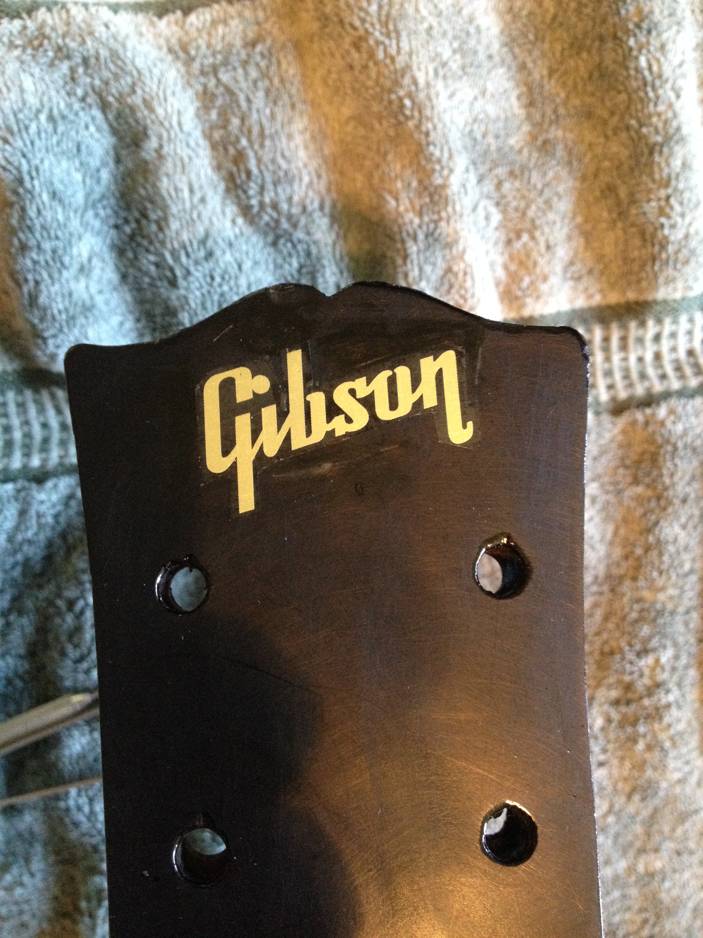

thanks, I intend to tint the clear coats to do the back of the head. Also, the tuning machines cover a lot of the ugly on the back. Plus the rest of the guitar has it's share of dents dings etc.

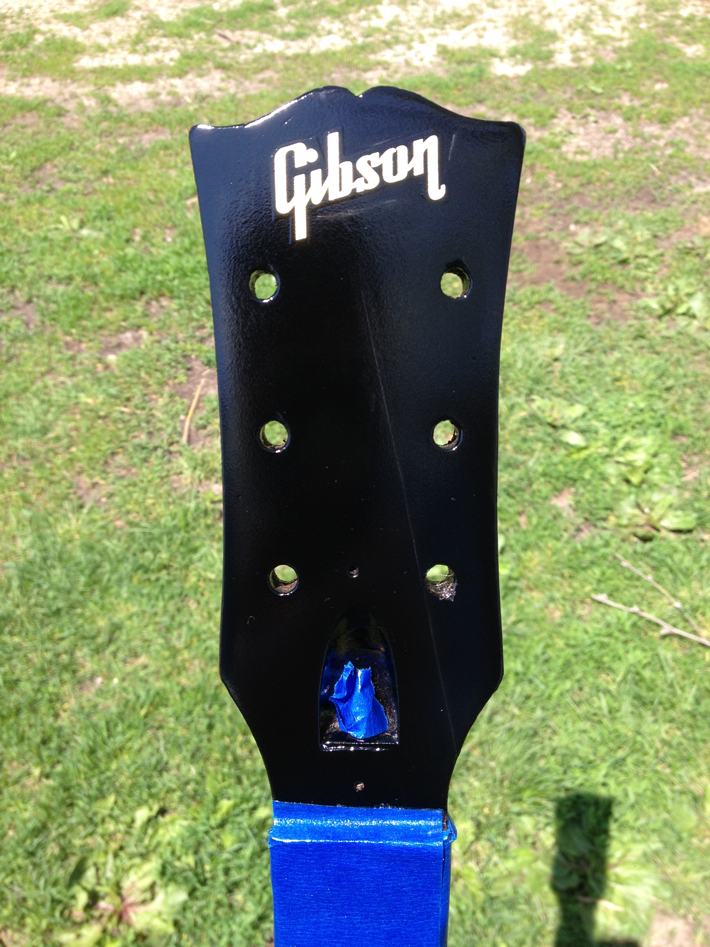

Greg Steil
Posts: 158
Re: Gibson headstock wreck
Post by Greg Steil »
ready for clear coats. The back will get a lightly tinted spray.

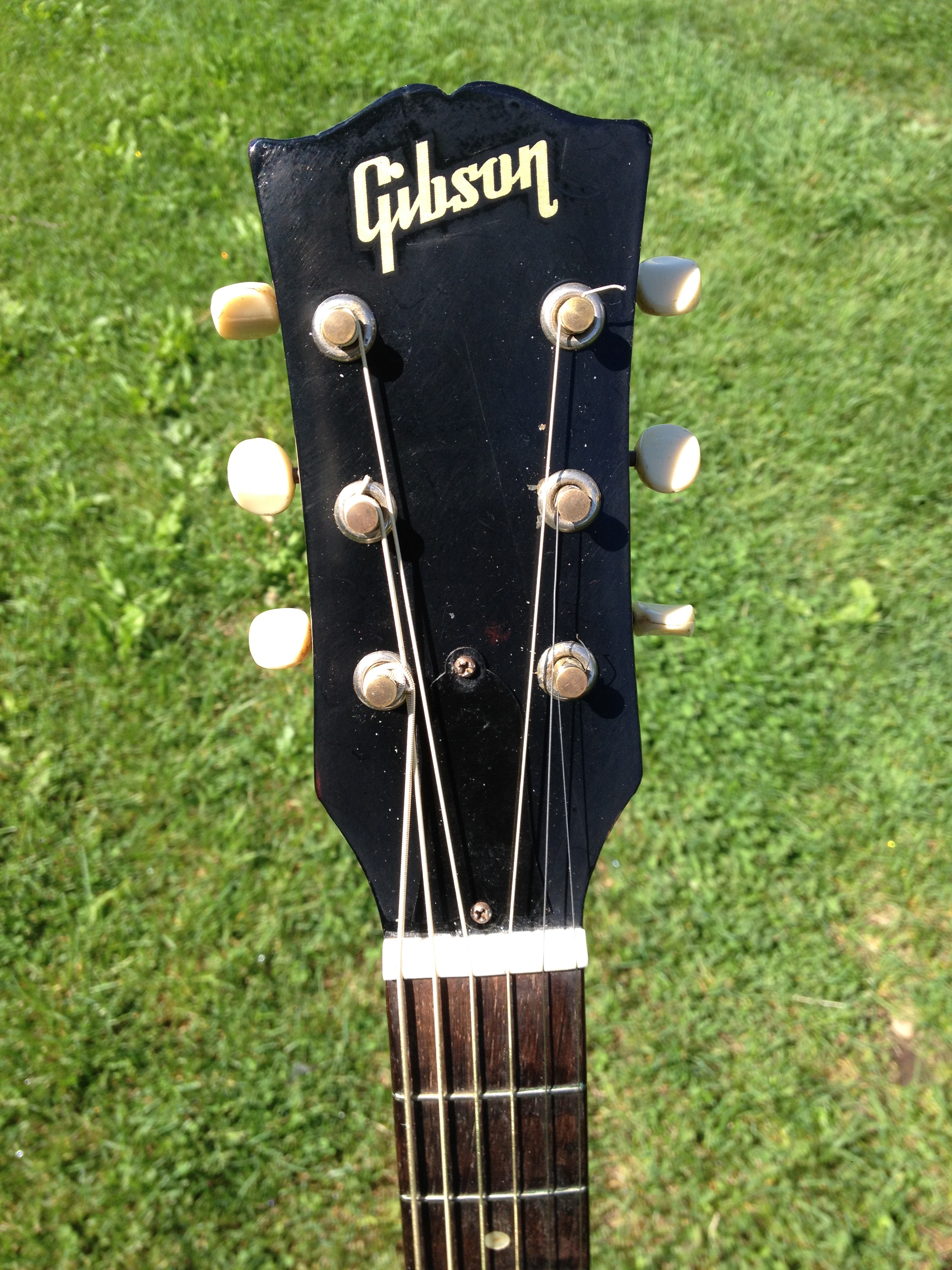

Greg Steil
Posts: 158
well, here tis
