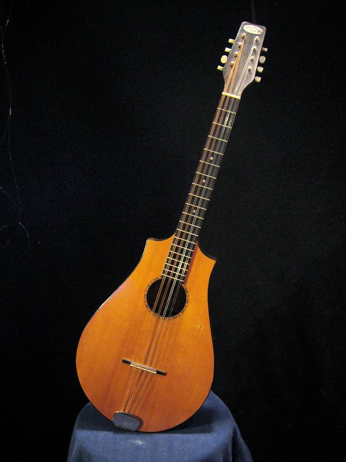

Mark,
That's a really lovely instrument. Those are some pretty tight bends on the shoulders. The picture from the ad makes it look like the shoulders on the 1.0 come to a point, so I assume that's a joint rather than a bend like on yours. Is that right? Did you have to do anything special to get that tight a bend?

Jim, you are correct, the original has points there, and so there are joints. If folks are interested, I can post some photos of the original as well and go over how it was made. I chose to do bends for mine, I used a 1/2" pipe and went very slowly! It was a bit difficult too. I think I'll get better at that tight bend as I build more of these.

Re: The Octofone 2.0
I play mandolins, so I just tune it as a mandolin, but one octave lower.

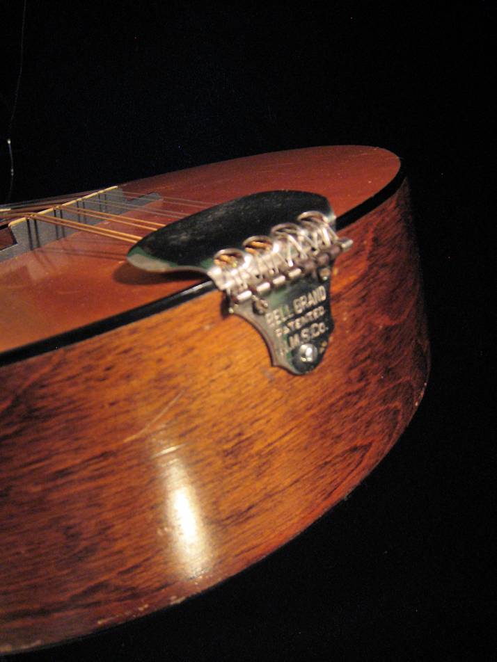

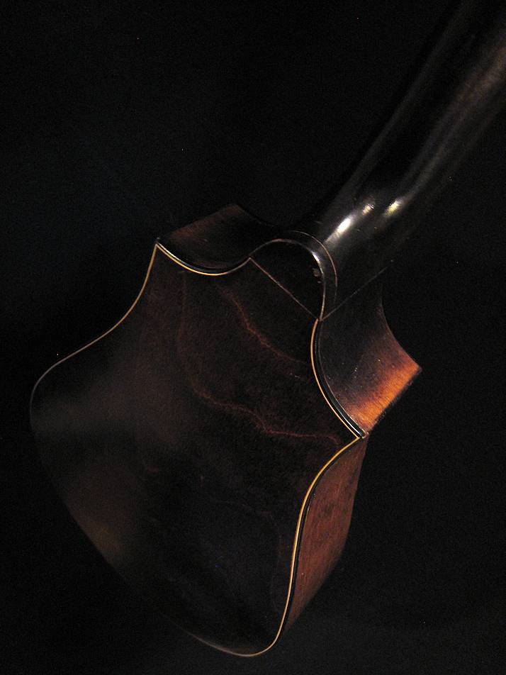

Ok, so I took some quick pictures of the original Octofone. These first ones show the full front shot. I made the body of the 2.0 one inch wider at the lower bout, the top where the points are is the same. The scale on the original one is 21", while the 2.0 is 22".
These photos are not great, Sorry! I am in a hurry.
The strangest thing about this instruments' construction is that the sides are all one piece, with no join at the tailpiece. The sides start at one point, and go all the way to the other! The neck block goes from point to point, and there isn't any side pieces on the outside of the neck block- the surface on each side of the neck, from one point to the other is actually the neck block itself!

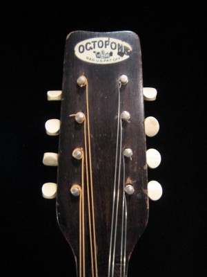

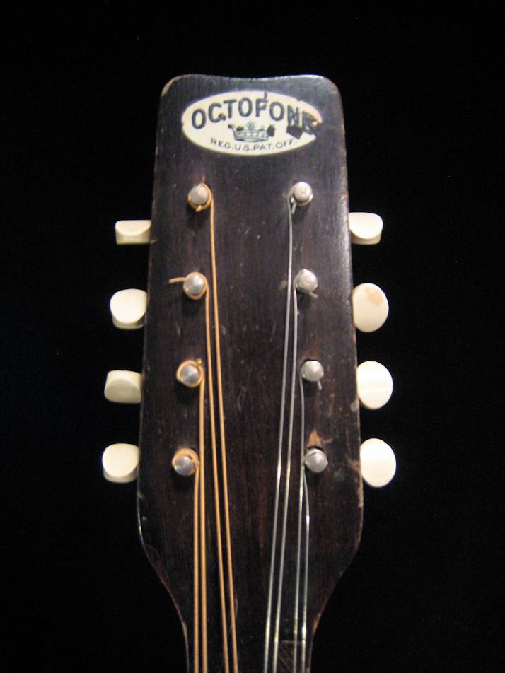

Here's the peghead...and the rosette with the label inside.
I've seen a few of these in photos on the web, but none of them seem to be in the good condition that this one is! At some point it must have had a pickguard screwed to the top, there are holes there. I've never seen one in a photo with a pickguard.
