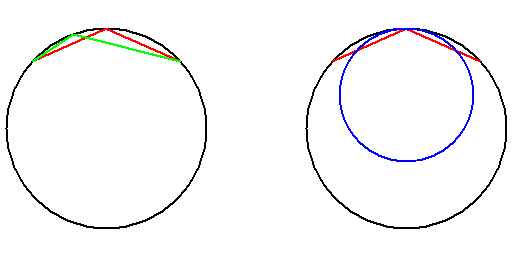

That's too bad, because you were right! I think Chris went off track when he started thinking too much about the sagitta. I draw the reader's attention to the left part of the diagram. The red and green lines are the same long compass -- the vertex angle is the same for both of them, and that's the (inarguable!) geometric rule that makes a long compass work. It doesn't matter where you "rock" the thing side to side, that V will always be the same angle, somewhere on the circle, with the two pivot points fixed on the circle.I'll stay out of it. I got into this on another forum making the same suggestion as you did and was proven wrong. Now I'm somehow unable to prove you wrong on this one so it seems that the rules governing long compasses change depending on what side I'm on.
Now, the "height" of the vertex above the two pivot points changes the whole time. When it's in the center, it's the sagitta, but that's the only time the sagitta is even vaguely interesting, I think. Don't even go there. I'm not going to try to re-understand all of the logical argument in those postings in order to "fix it", but my gut instinct is that there is a factor of two or some such thing that got lost somewhere.
The right part of the diagram shows two different sized circles made by the same "V" angle, simply by moving the pivot points closer together. It's the only way to make everything fit.

Okay… did I get my diagram attached this time?
- Attachments
- LongCompasses.JPG (9.18 KiB) Viewed 25298 times

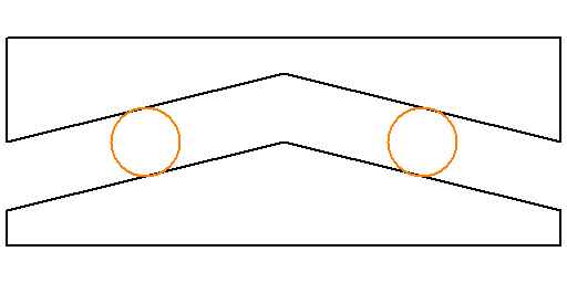

By the way, if anyone is actually thinking about the long-compass approach, here's an idea to address the issue of the height changing as the rail separation changes.
Instead of just moving side to side, the rails ride on a V whose angle matches that of the long-compass sled. So… when they get closer together, they also get higher. You can move them to any separation and the height of the sled always stays the same.
- Attachments
- RailAdjuster.jpg (8.95 KiB) Viewed 25298 times
