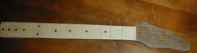

And installed the fret markers made from scrap cocobolo and a 1/4" plug cutter. The headstock was covered with a veneer from the leftover cutout of the top. Headstock angle is about 14 degrees and I've decided to use some salvaged inline tuners.

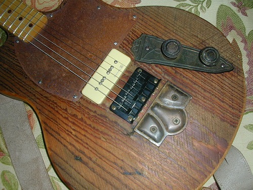

Here's a closer one of the top. The decorative piece behind the bridge is part of an old hinge. The control plate is a door eustachean plate with cabinet knobs. The pickguard was cut from a piece of light steel and artificially rusted using vinegar, bleach, salt and steel wool then sealed with several coats of matte lacquer.
