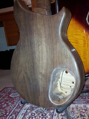

I have as of today applied my grain filler in a watered down formula to the walnut of the guitar. Tomorrow I'll fine sand the whole thing and prepare for the finishing regime.
Greg Robinson
Posts: 686
Re: The 10 Year Project
Post by Greg Robinson »
Nathan, if you watered down the grain filler, make sure you allow plenty of time for it to dry out, you don't want it shrinking back after you've applied finish on top (you may need multiple applications), or to trap moisture underneath the finish.

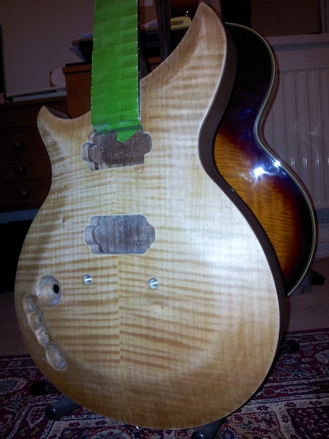

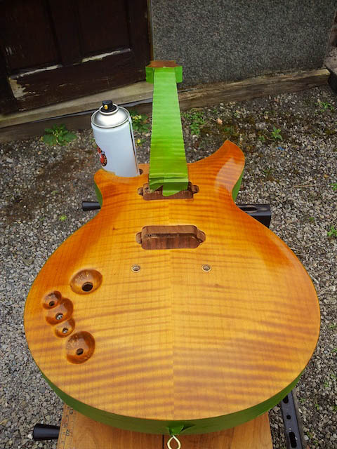

Grain filled and sealer coat applied over the top of a rubbed down amber dye coat and the guitar is half way through it's finishing cycle. Here's a sneak peak. I'm really impressed with the depth and richness in the walnut as there's no tint or dye and it's a lovely chocolate brown. The top cap is showing it's figure off very nicely now and I'm really looking forward to shooting the yellowish amber tint over the top. I'm going to attempt to get a kind of lemon drop finish but if it turns out that way it will be a miracle as I'm a complete Nitro novice and my efforts leave a lot to be desired. Practice makes perfect though and I hope to get a lot more of that!!

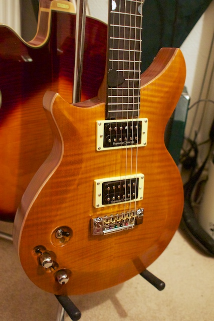

Another day, more progress. The lacquer has been applied and the nice Lemon Drop finish has been achieved. this one was a sure case of flying by the seat of my pants but i'm happy with the result, even down to the 'un-burst' as i've seen them referred to. Now to wait for 3 odd weeks for another chance to ruin everything by flat sanding and buffing. Here's hoping that those clear coats are nice and thick.

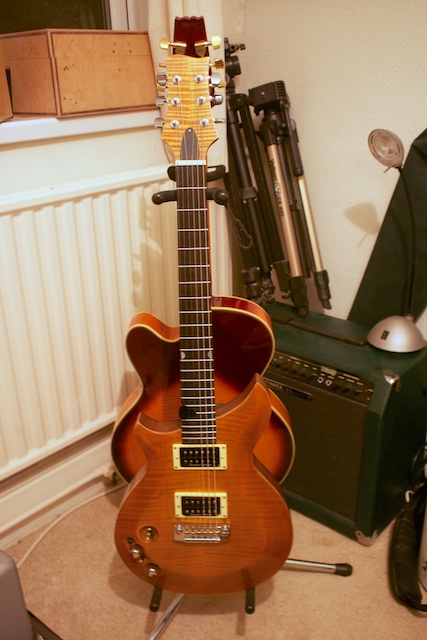

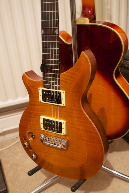

After waiting patiently for my lacquer to dry over the last few weeks, i have finally completed the 10 year guitar. There's a little more tweaking to be done here and there but for all intents and purposes here's the completed article:

One minor detail question: what are those pickup rings? They look like a nice color. Right now I have a pair of "creme" rings from Stewmac that seem too dark and brownish to me, and a pair of white ones that I hit with "vintage tint" lacquer that seem to yellow to me. Yours look like the proverbial "just right," at least in the photos.
Nathan Dodd
Posts: 68
Joined: Sun Feb 10, 2013 11:56 am
Post by Nathan Dodd »
Thank you very much Dave!! They are a pretty standard cream as far as i know, they were just the cheapest ones i could find from a UK based vendor. They are likely just an all parts style generic replacement.
