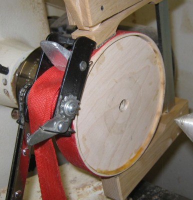

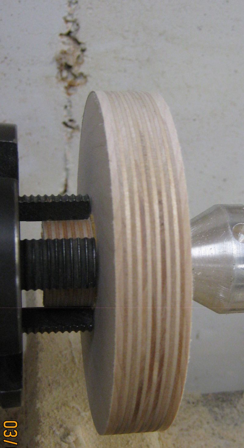

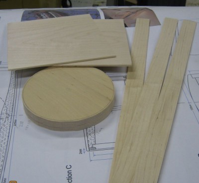

First, I redid the wheel with some baltic birch for the wheel proper, some 2 mm pieces of maple for the outside and some 2 mm thick veneer strips to wrap around the wheel. Wheel with sides glued on, then trued on the lathe. I used a web clamp to clamp the veneer strips to the outside of the wheel. Wheel, pretty much done. I'm going to mount it on the shaft and then finish it up.

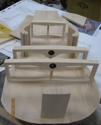

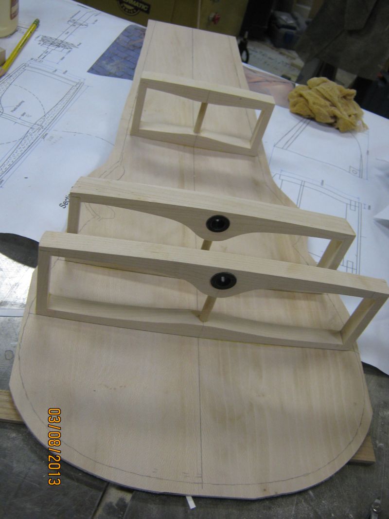

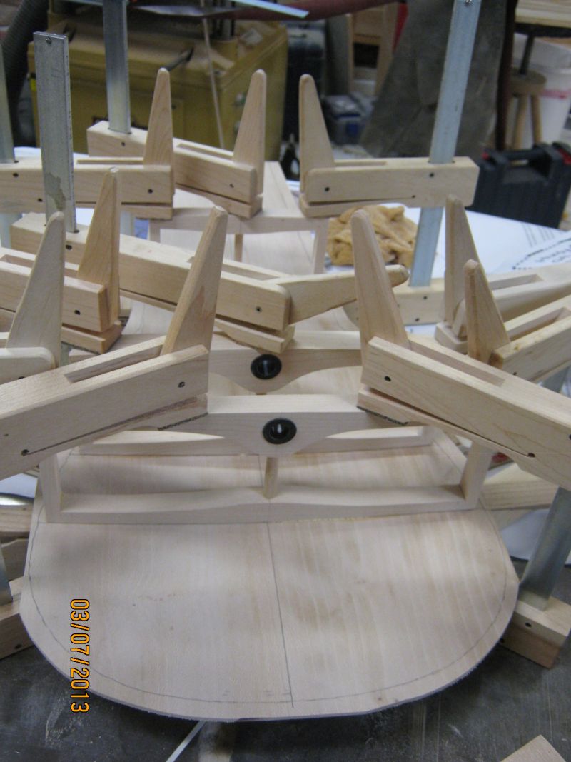

I've gone ahead and glued the supports to the back.
Sides glued in- linings are used in the front section of the instrument

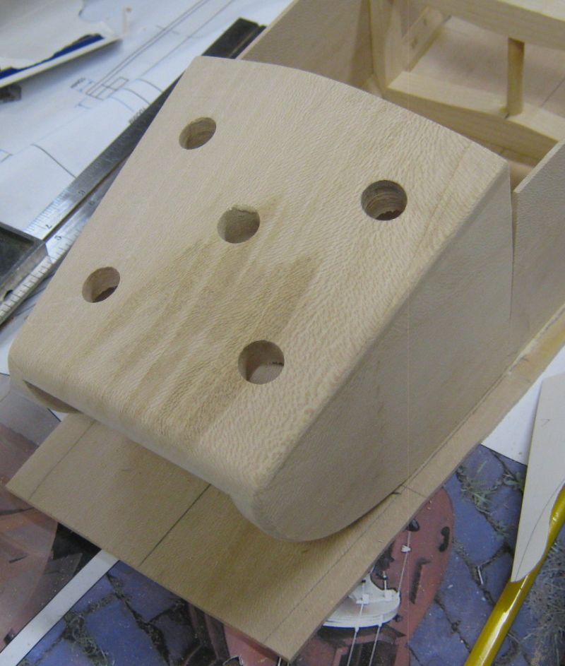

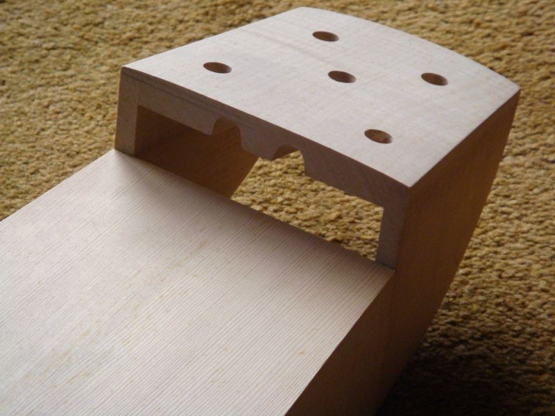

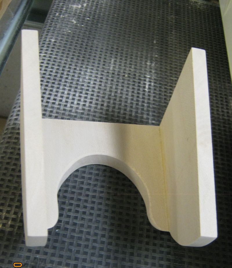

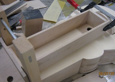

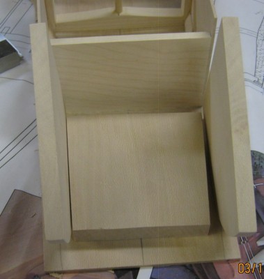

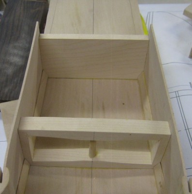

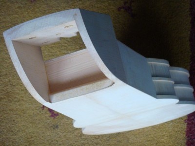

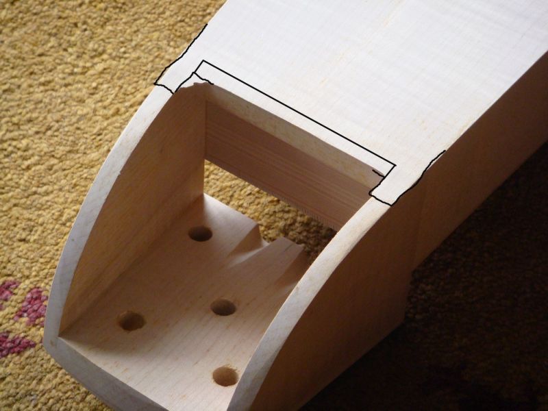

Next, the peg box. Although the plans are pretty clear, I still goofed up here...
Here I've got the component pieces (sides and bottom)- for some reason I thought the bottom extended forward, in reality it is just a small square on the bottom. Of course I realized that after it was all glued up. So I put a recess in it and am calling it a "feature" <g>. Wilfried was kind enough to send along some photos and gave me permission to post them. So the next couple photos show how he does it. Next I used the router to put in a couple rabbets in the top part. In position with the holes for the tuning pegs. Wilfried's photo: Finally, sides on, hole drilled in footblock (kinda munged that up a bit. Obviously some trim work to do. The piece on the left will go on the outside to cover the big hole for the shaft and bearing. The plans do not show that, but some of the photos do show such a piece.

I noticed the nylon bushings on my wife's drum carder have the holes drilled off center to allow the drums to be moved closer together or further apart. That might not be a bad idea for the bushings on the gurdy to allow the wheel to be adjusted relative to the strings.

Well, yeah...
I used ball bearings for mine, the one (or, rather, two) that appeared here a while ago... I know, it's totally untraditional, but, hey, it's something that works!...

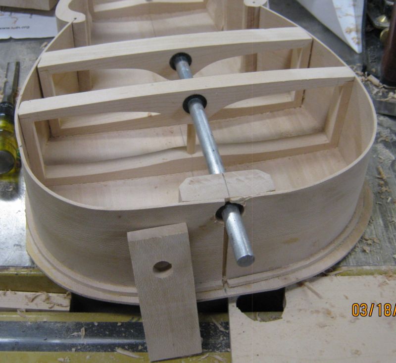

Re: Building a hurdy-gurdy
Yuri, how did you get all the bearings to line up? Did you maybe drill after things were assembled?
- Jim McConkey
- Posts: 1094
Clay's idea of using a slightly oblong slot for the bearing (especially the middle one) should allow easy alignment.
- Posts: 134
- Joined: Fri Jun 29, 2012 12:56 am
I drilled a large diameter (the bearing outside diameter) hole half-way through in both units that were to take the bearings, then a smaller hole for the shaft itself. Once everything was glued to the bottom/sides, so the braces were in place, I simply pressed the bearings into their respective holes, and twiddled the shaft in. This lined the bearings up Now it was simply securing them with a bit of glue, and to make sure they don't fall out if the wood expands, a couple of wooden bits screwed across the face of them, just covering the rim of the bearings holds them tight..

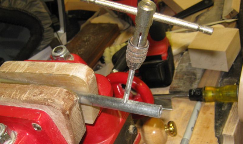

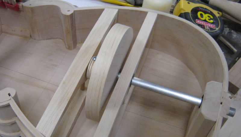

I got all the side ribs on so it's just about ready for the top. But I have to finish up the wheel and axle. Per the plan, I drilled a hole through the small wheel at an angle into the axle. Then tapped that hole:
And here's the wheel on the shaft:
I put that assembly back on the lathe and trued it up and cleaned up the sides. Then here it is in position: -

How did you end up aligning the bearings?
- Charlie Schultz
- Site Admin
- Posts: 1442
Sandpaper! The holes were close enough that I could get the rod through, but it was way too tight. So I used some sandpaper wrapped around a dowel rod to open the holes in the Acetel "bearings" up a bit. I'll try something along the lines of Yuri's method next time.How did you end up aligning the bearings?

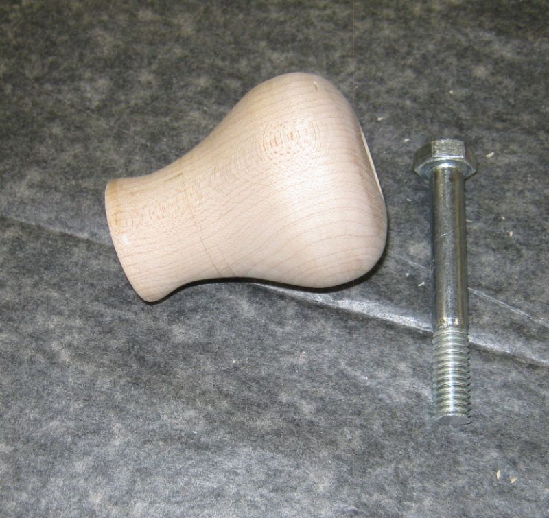

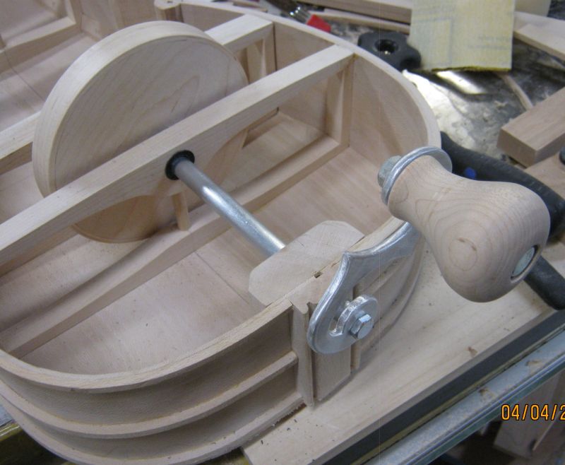

Here's the knob I turned.
Everything in place. I had to turn down the smaller wheel to get it to clear the top, it wound up ~27-28 mm in diameter. Also had to countersink the screw.

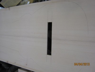

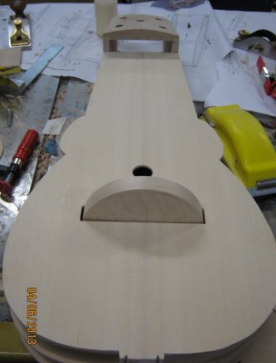

I went with spruce for the top- had a couple pieces of Deb's Maine spruce that were too narrow for a guitar. Finished thickness is 3 mm. Still have to drill the access hole for the end of the axle.
With some trepidation, I glued the top on.
Next, started work on the top assembly. A good bit of sanding was needed to get the sides and front and back supports to conform to the curved top.
With the lid on.
The back support still needs to cut to shape.-
