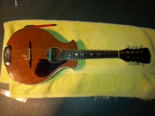

Here's the completed neck set with french polish touch up. I also ended up putting a very shallow shim under the fingerboard extension. I figured anchoring it to the top would make the instrument more stable. I'll finish finish touch up tomorrow and string it up.

Ha ha! That looks really good Chris.
Chuck Tweedy
Posts: 1182
Re: Tone King Mando Neck re-set
Post by Chuck Tweedy »
Wow, looks great. Good job!

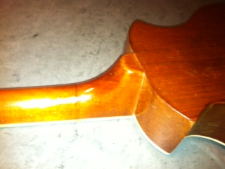

Thanks everyone! This was my second neck re-set so I'm still new to this. I tweaked the finish touch ups and strung it up. I had a slight hump where the body joined the neck I had to flatten out that caused some buzzing but I was able to flatten it out with a fret file and light sanding. The action comes in just under 1/16th at the 12th fret so I probably took a hair too much off the heel when I did the final sanding but a paper thin shim of Mahogany under the bridge seemed to take care of that as well.

Here's the final action.
