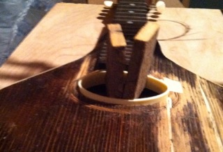

I gently clamped the body to try to push it back to shape and was surprised at how well it worked. After several weeks of gentle pressure, I was able to glue the serious crack by the bass side of the neck that had caused much of the damage and pushed the entire top out of shape.
As with many early Gibson A’s, this mandolin had a top that was quite thin and had split many times. Several of the cracks in the face ran the length of the instrument and were so wide there was no doubt that I’d need to splint them (add in new wood). In the course of removing old patches and undoing bad repairs, I realized the damage was much more extensive than I had thought and included an across the grain fracture on the bass side parallel to the sound hole. The structural strength of the instrument was completely compromised which went a long way towards explaining why this had collapsed so many times! I was beginning to question the wisdom of my actions...

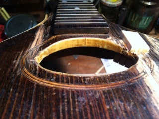

Over the next few months I gradually splinted the biggest cracks with new spruce then moved on to splinting the smaller ones as well. I got the cracks dealt with and began to deal with the tear out damage inside the instrument. This was caused when various patched and braces had failed in the past, taking chunks of the face wood with them.

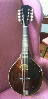

The mandolin was re-strung with light gauge strings and I was delighted to find that it played beautifully, with excellent action and magnificent tone. It played it’s first gig the next day. It was a long and sometimes difficult journey, but I learned a tremendous amount about restoration and saved a fine instrument in the process.
