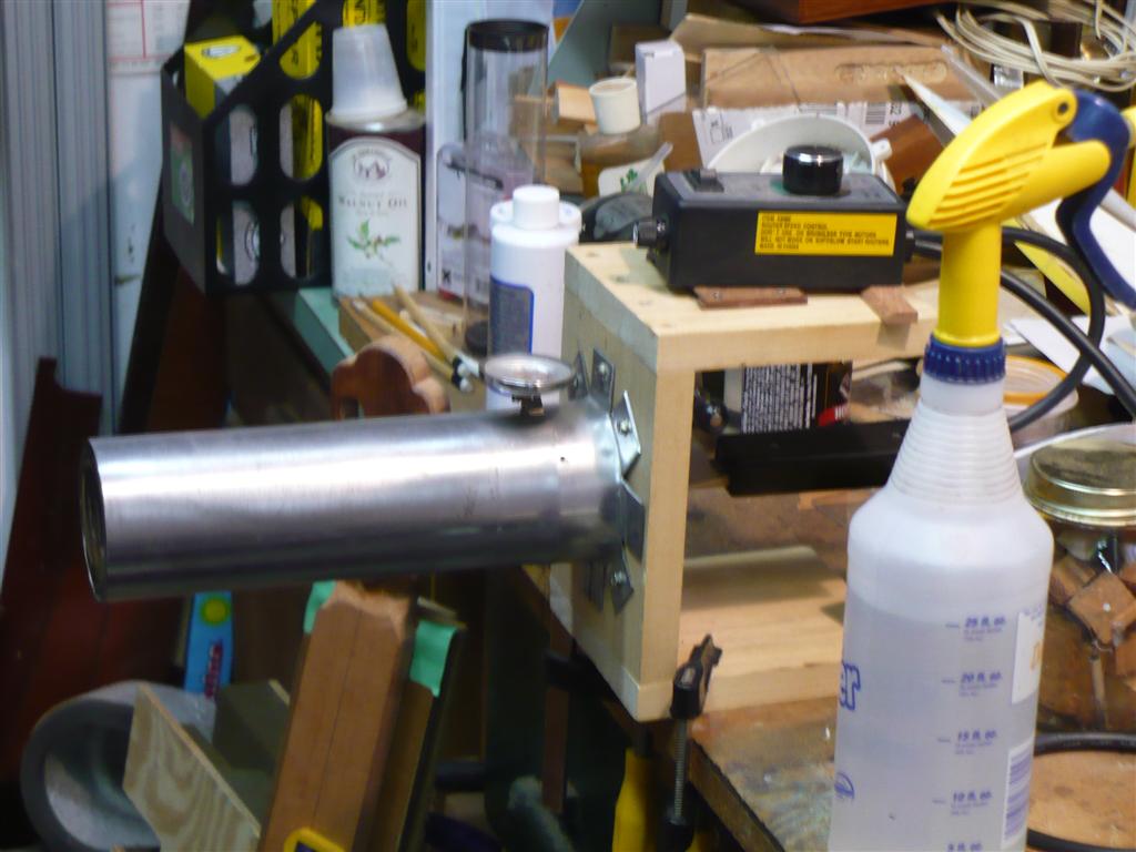

I used a 3" truck tail pipe extension($7 pr *.00. Cut it in half, split one half, and shoved it inside the other half for thickness. Put an electric charcoal lighter in it, plugged it into a router speed control, stuck on a grill thermometer, and bend away.

I use a 3" aluminum pipe with 1/4" walls, 500 watt halogen lamp, and caps on both ends (one of the caps is an oven thermometer). There's plenty of thermal mass and very good conduction of heat. A dimming switch allows me to dial in the temperature (425 F for me).
